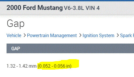

What would be good for my spark gap on my car, 054 or.053?

If you are replacing the plugs, either of what you indicated is fine. The manufacturer gives a range for setting the gap. In this case, it is.052 -.056.
I attached a pic below from my manual. Let me know if this helps or if you have other questions.
See pic below.
