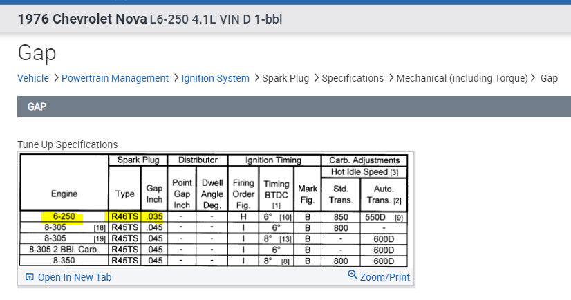

I need to know the proper gap for my spark plugs on a 6-cylinder 4.1 l 250 cubic.

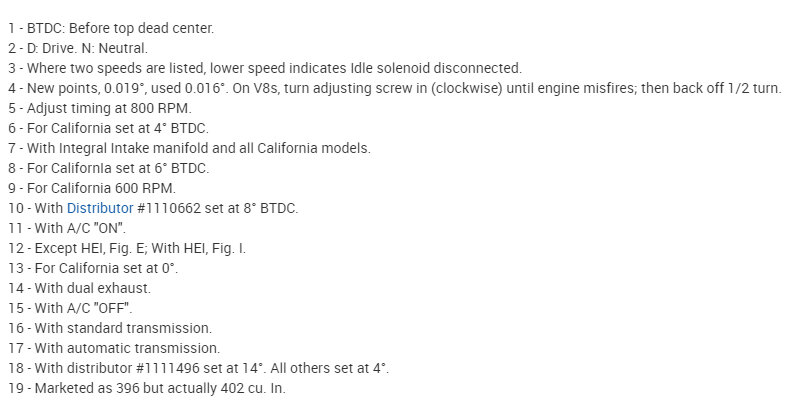

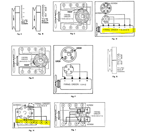

If you look at pic 1 below, it provides the gap you requested. Additionally, I added the tune-up information for timing, firing order, and so on.
Let me know if this helps.
