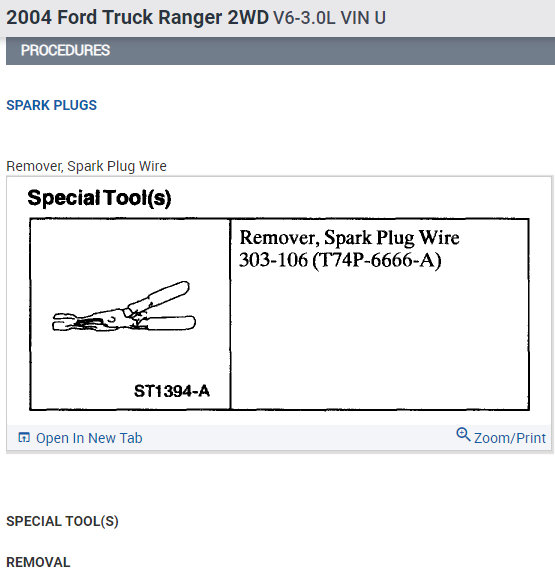

What should the spark plug gap be and how do I change them?
May 11, 2018 at 5:31 PM
SQM
  • 6,383 POSTS
The spark plug replacement procedure is fairly straight forward.
It can be done in relatively short period of time depending on your comfort level.

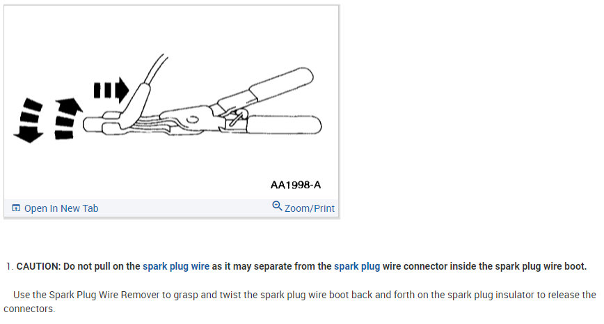

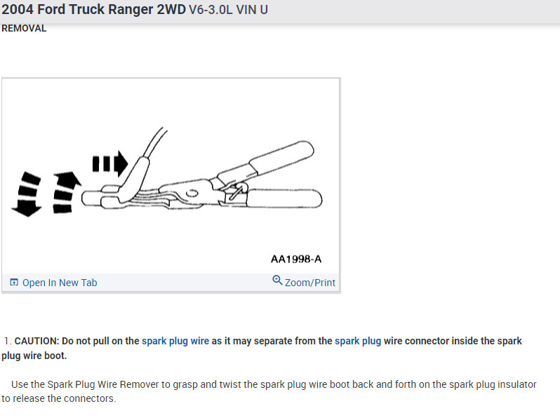

Before you remove the plugs you will have to take the wires off of the plug. Be sure to keep track of which wire goes to which plug. Sometimes it is just easier to do one at a time, that will make it easy to track the location of the wires.

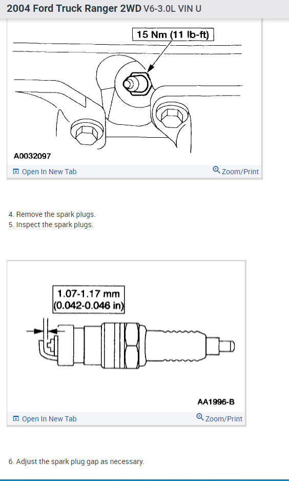

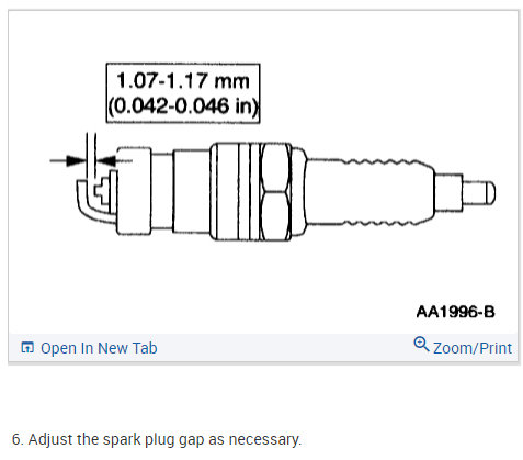

The gap for the plugs should be at: 1.08 - 1.18 mm (0.042 - 0.046 in)
Here is a helpful guide for replacing spark plugs:
https://www.2carpros.com/articles/how-to-change-spark-plugs
I have attached the replacement procedure for your reference.

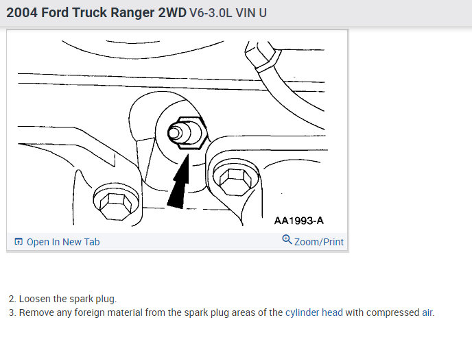

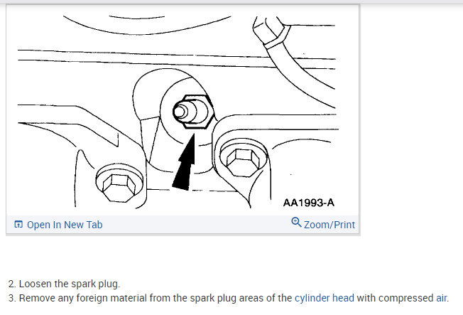

Hello, I'm Danny.

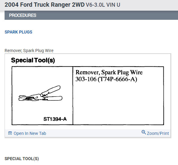

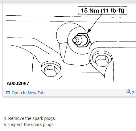

Here is the information you requested. Here is a tutorial for you to view on how to change spark plugs. It's fairly simple.
I've attached picture steps below on the procedure to change the spark plugs on your Ranger. I've also attached a picture below showing the proper gap. Hope this helps and thanks for using 2CarPros.
