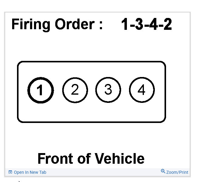

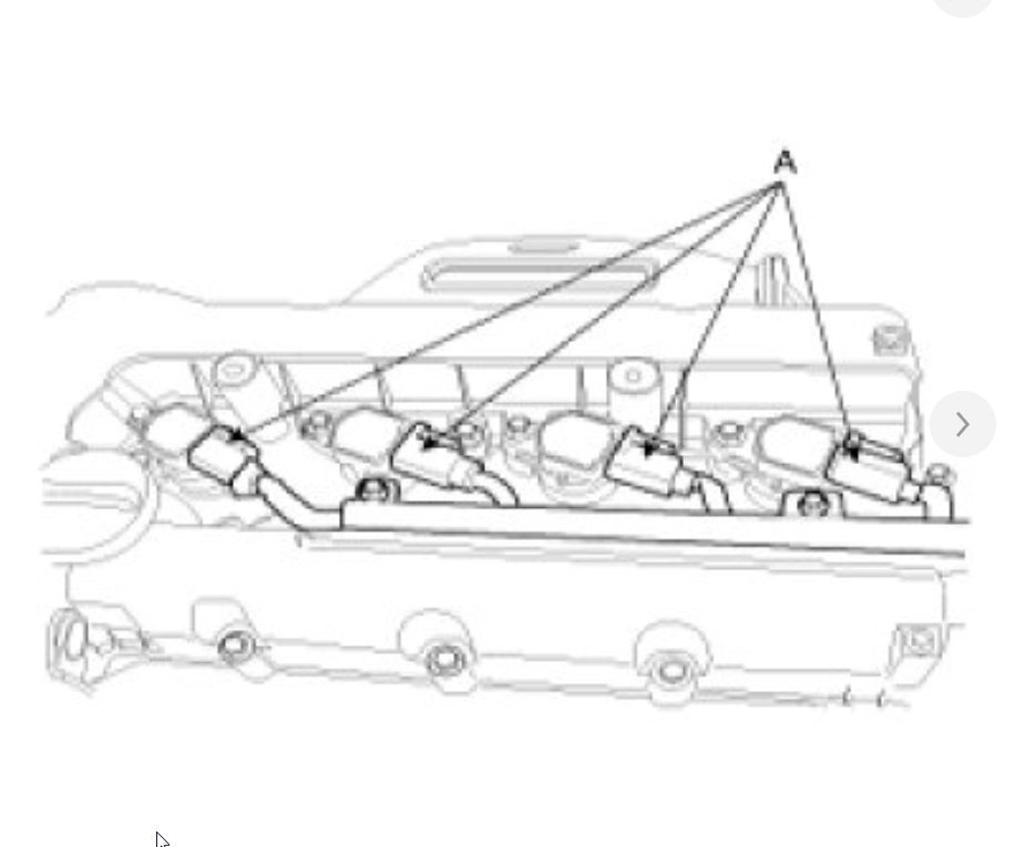

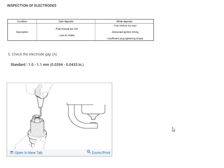

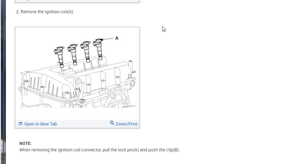

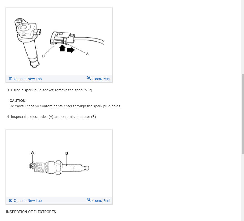

I need a spark plug diagram.
Nov 15, 2019 at 9:11 PM
I am not sure if this is what you are requesting. Let me know if you are looking for something else. If you are, can you give me a little more detail as to what you need? Thanks
Nov 16, 2019 at 6:06 AM
