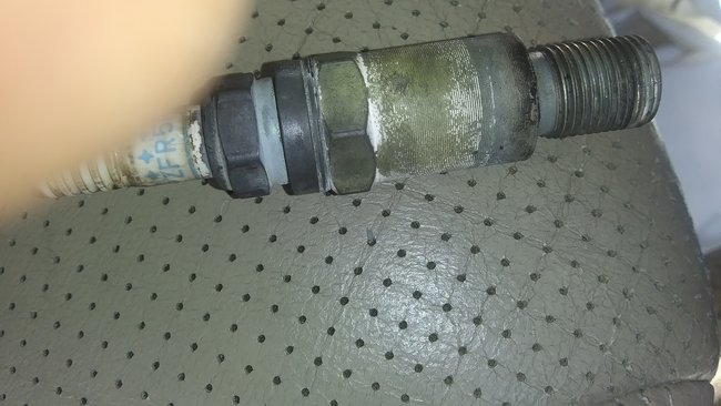

I did try that but there is no socket bigger than a 5/8 that will fit down the port.It was suggested by a rookie that I try putting a strong epoxy to the end of an old spark plug and try inserting it.I wanted your input first.

Can you post me some pictures of what you see?

This is the adapter:
Aug 14, 2020 at 4:14 AM
JERDOG63
  • 33 POSTS
I hope you can see this.
Aug 14, 2020 at 4:15 AM
You could try using a thread sealer on the spark plug to the adapter and let it sit for a few hours and see if it will come loose.
