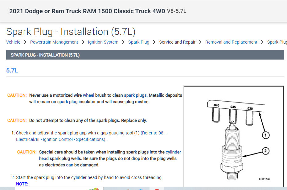

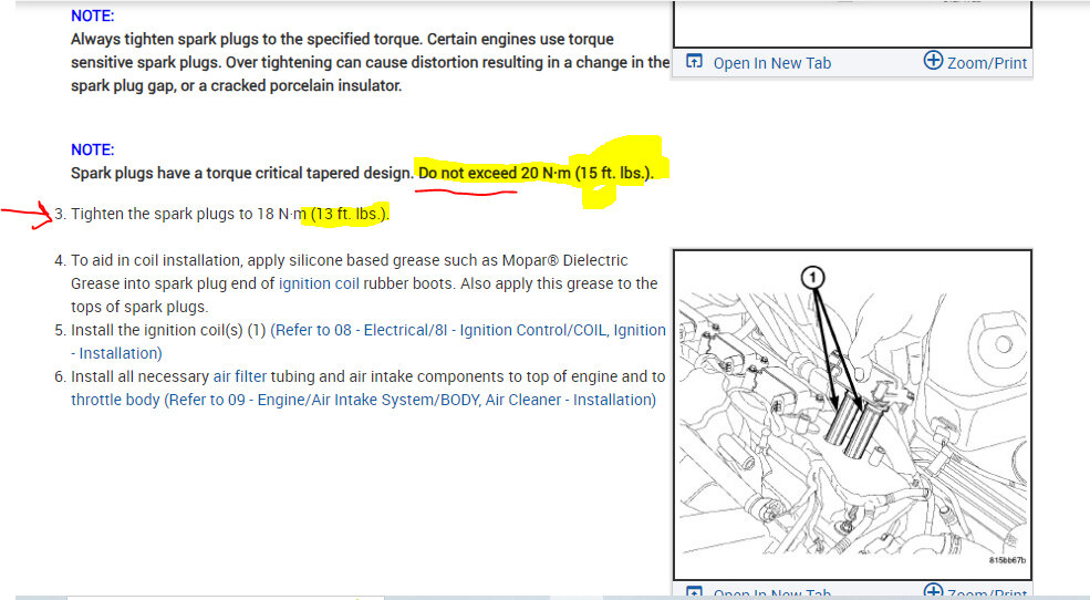

If you look below, I attached the directions for installing them. The directions include the gap as well as torque specs (13 ft/lbs).
When you reinstall the coil pack, I recommend using dielectric grease inside the rubber boot. It will help prevent contamination and make it a lot easier to remove in the future.
