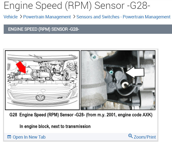

Sometimes it has spark and sometimes it doesn't have spark.
Jan 4, 2020 at 9:01 PM
  • 55,399 POSTS

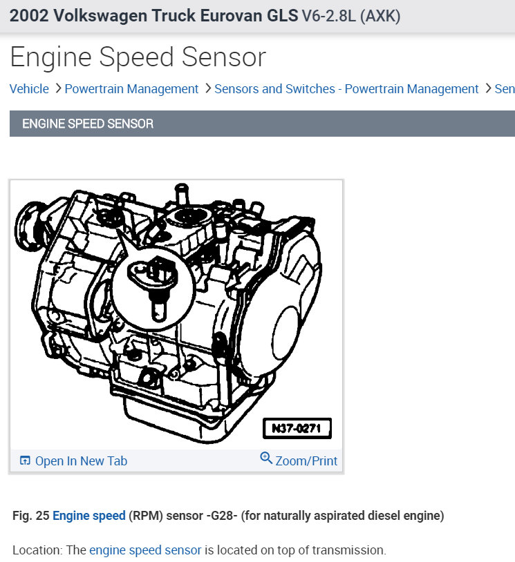

This sounds like a classic crankshaft angle sensor that is going out. here is the location and how to replace the sensor in the diagrams below. We should run the codes as well.
