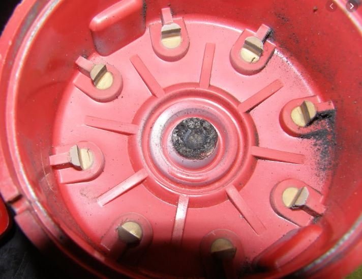

Check the distributor cap rotor button for being burnt up.
Check the rotor itself, too.

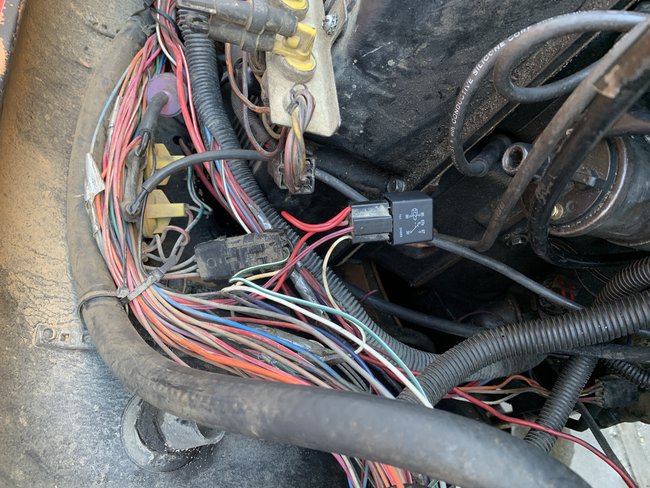

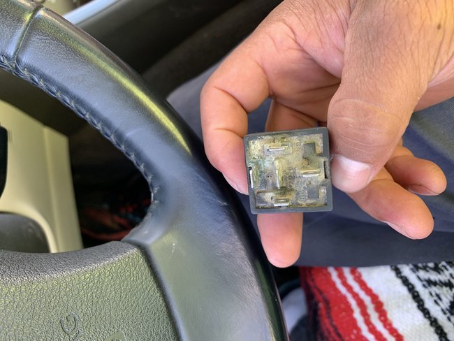

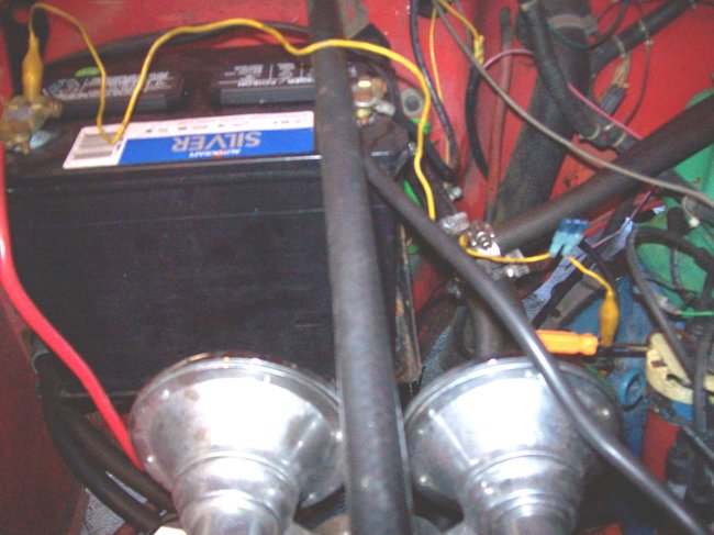

Could it be one of this relays?
+1
Friday, August 30th, 2019 AT 6:16 PM
MANDOCJ7
  • 36 POSTS
Relays what are this for?

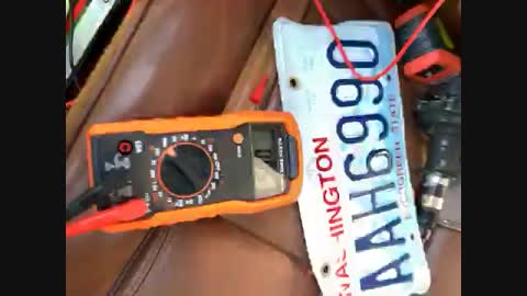

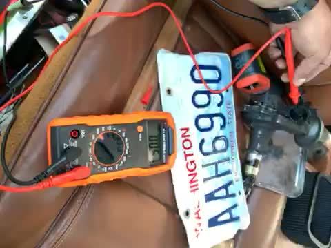

Is this a good reading?

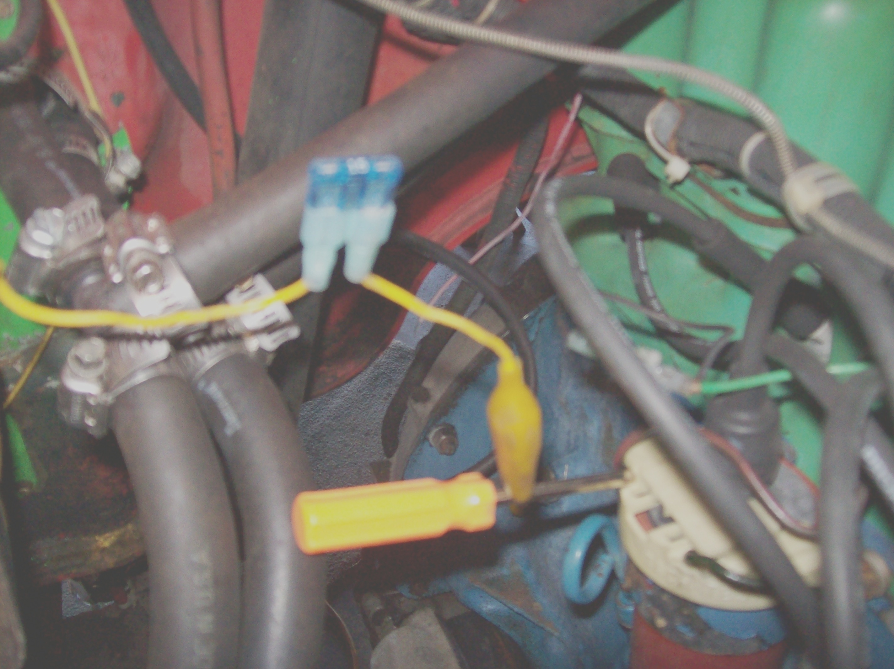

Lets try this.
Positive battery to positive coil.
Crank it up with the key as usual.
Turn it off it by removing battery side.
The Medic

Okay, what am I looking for here see if it goes on?

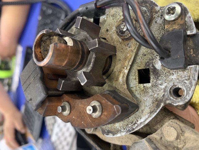

That’s how the distributor look like inside.

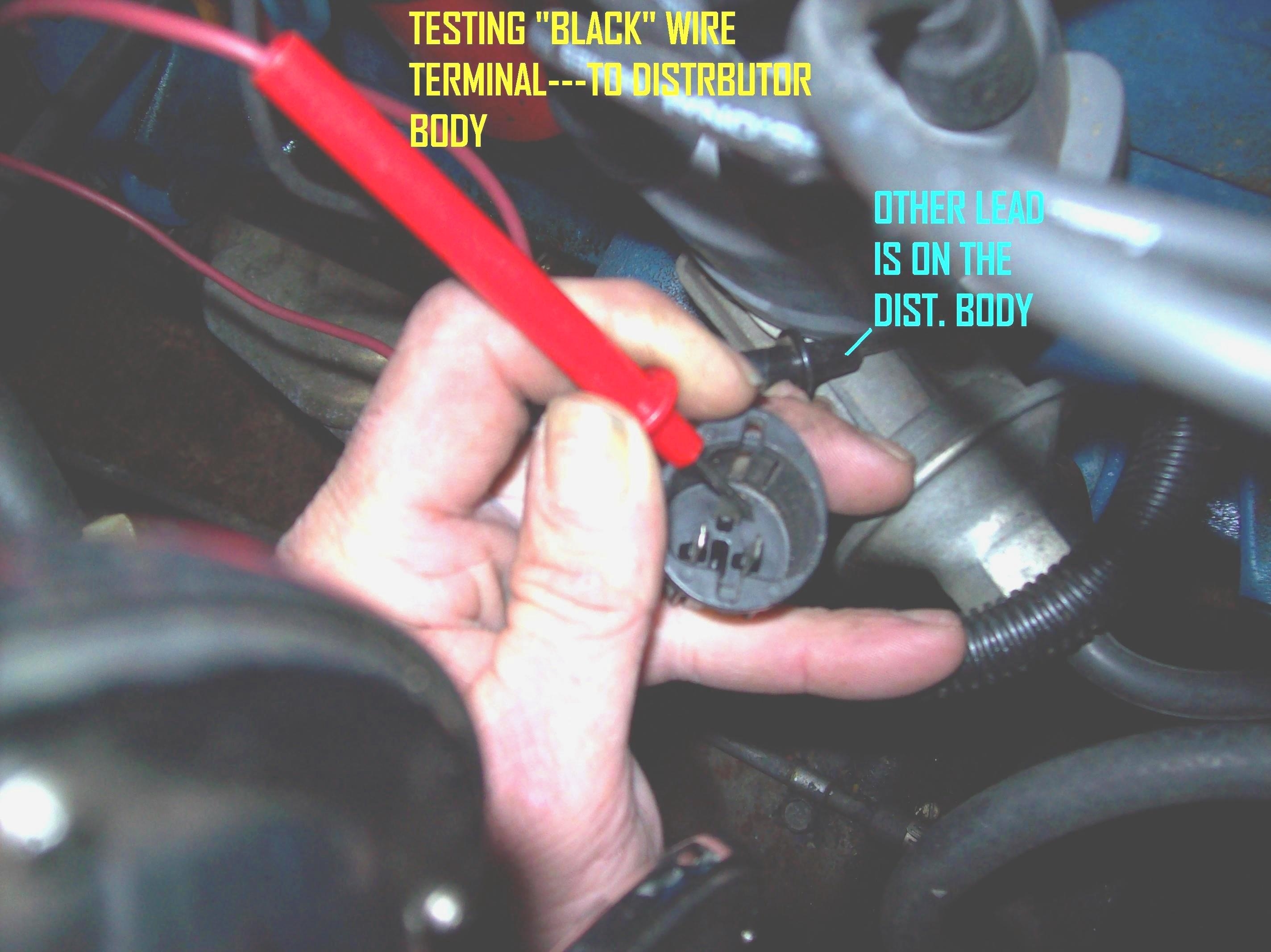

I think you have tried this. See 2 pictures below.
Did you check/recheck the way your distributor is installed?
The Medic
Saturday, August 31st, 2019 AT 3:40 PM
MANDOCJ7
  • 36 POSTS
Yes, I have tried that and is 006.

Hey there Medic. I tried it already the positive on the positive coil nothing happens and I also re check my timing marks and they are good I get 005 and 006 on the dis for Continuation.

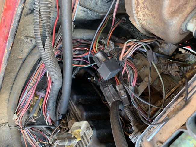

As it looks from here.
Either your ignition module case is not grounded well to the fender.
Or it is defective.
Or the distributor is not dropped into TDC.
How about a picture of your ignition module. I really want to see the wires and connectors that attach to it. Insure they all show well in the pictures.
