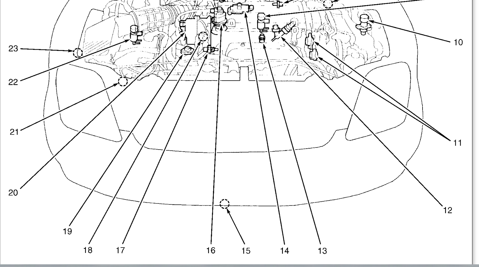

I bought the car it needed an alternator so I replaced the alternator. Went to go start it didn’t fire. Checked spark, sparks twice then stops. Change the cap and rotor. Still nothing. Then I changed the distributor and same thing. Changed my coil and still the same thing.I don’t know what to do.
Wednesday, February 27th, 2019 AT 5:56 PM
SCGRANTURISMO
  • 4,897 POSTS

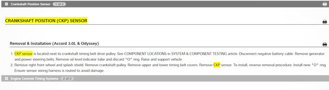

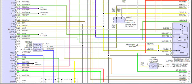

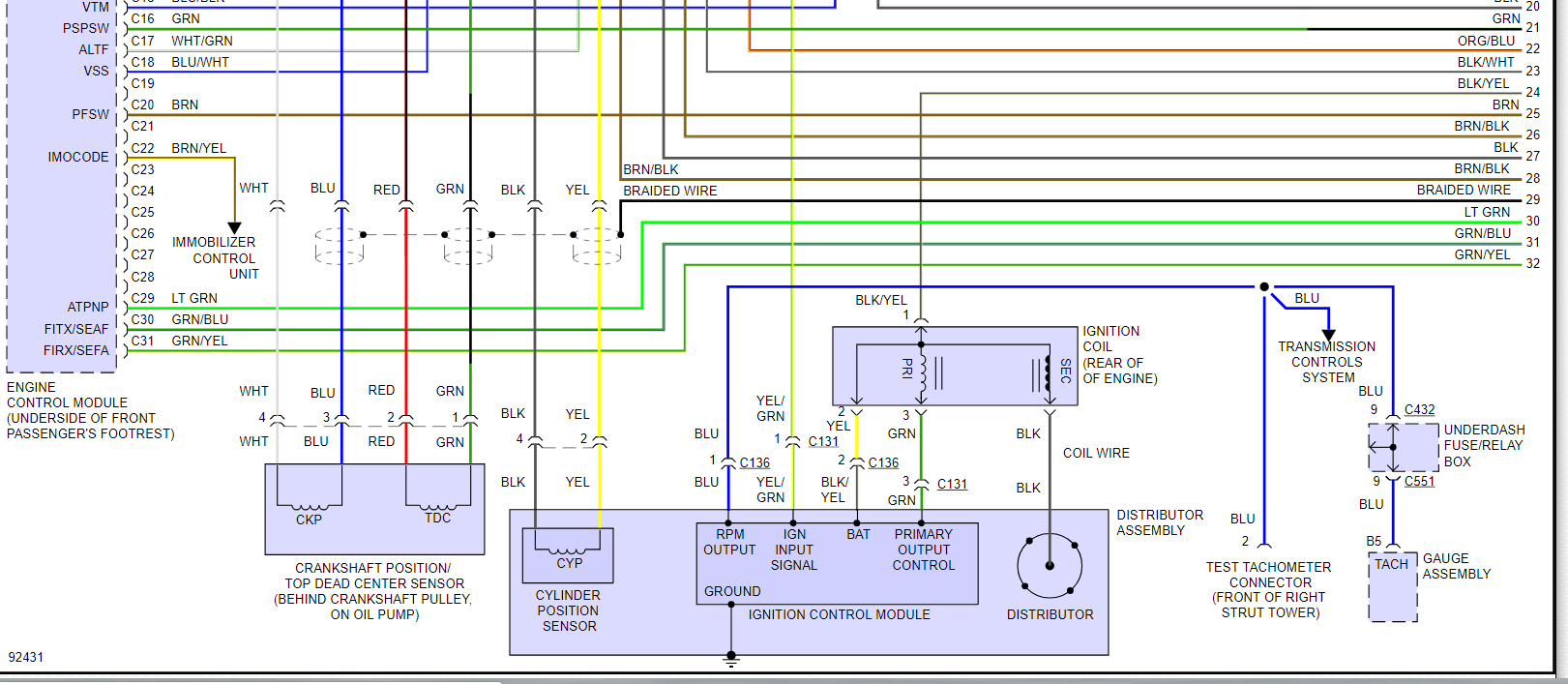

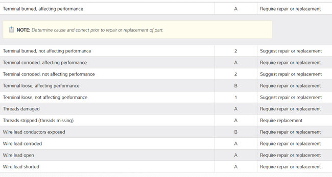

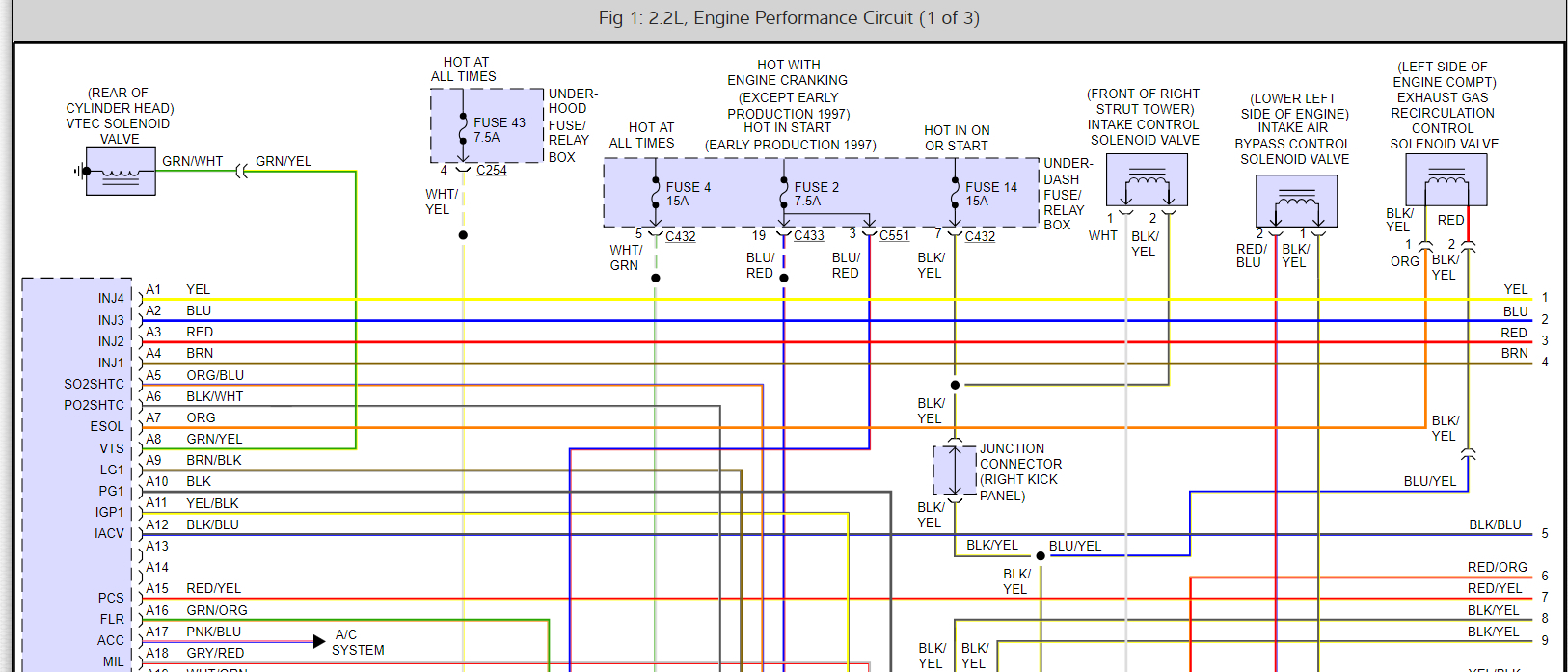

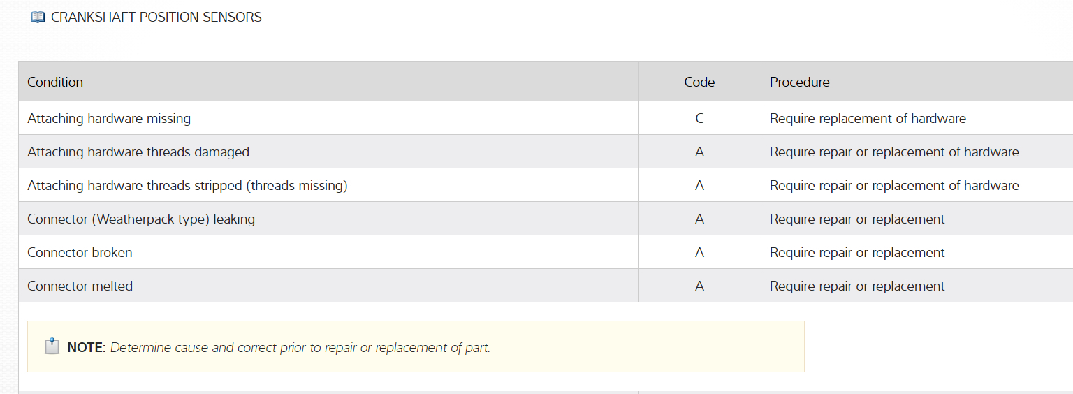

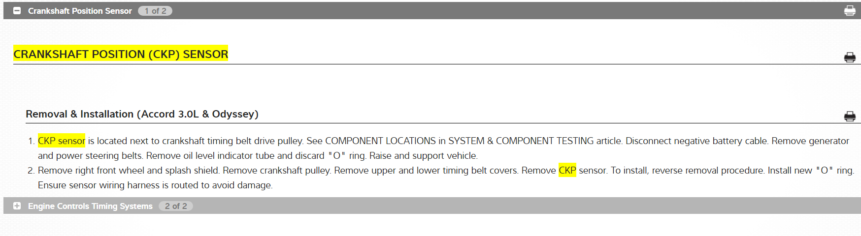

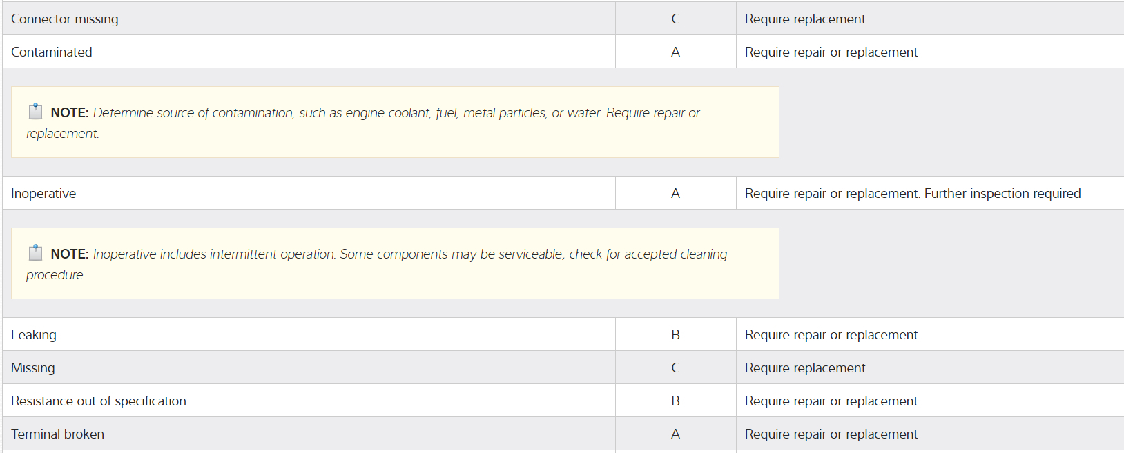

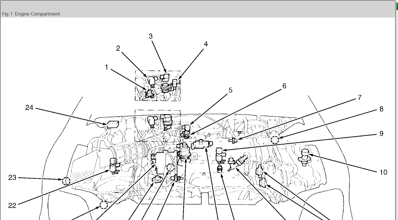

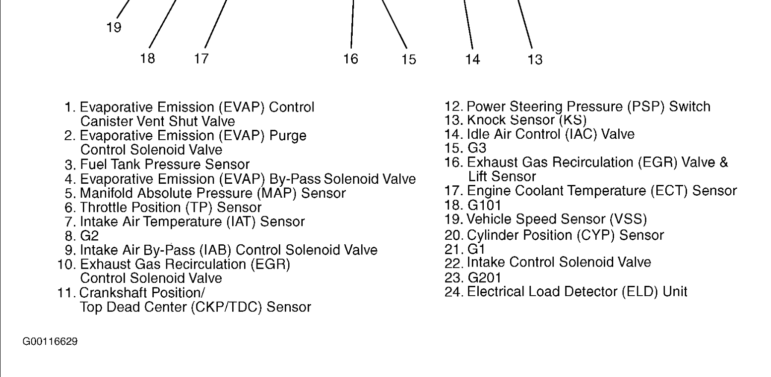

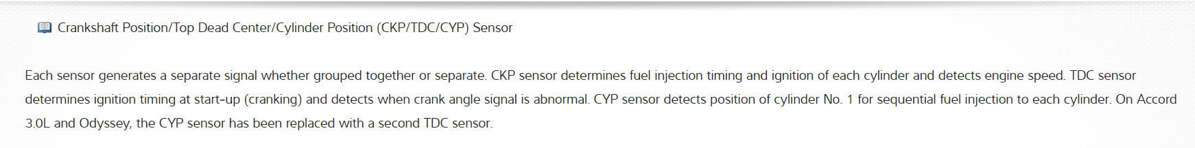

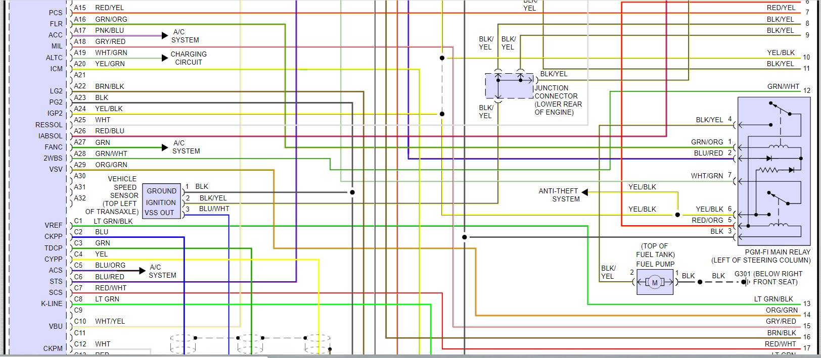

This could be a problem with your Crankshaft Position Sensor (CKP). I have included a few links for you below.
https://www.2carpros.com/articles/how-a-crank-shaft-angle-sensor-works
Please go through these guides and then I have included some information specific to your vehicle down below in the diagrams.
