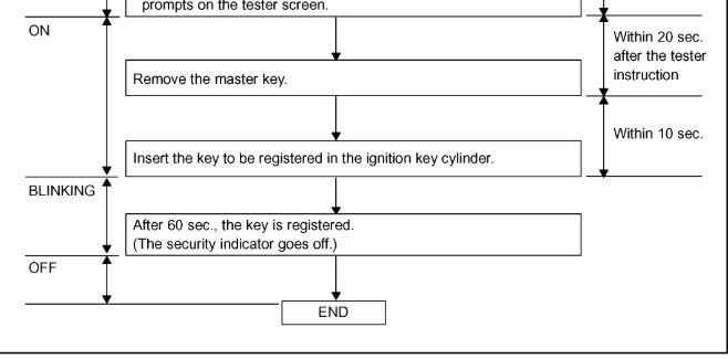

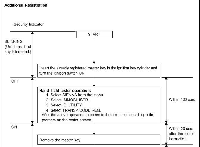

Need to know how to get spare key to work. it turns over but won't catch. I called dealer and they said it has a mobilizer and will cost $300.00+ to reprogram. I don't have this kind of money.
Jul 23, 2019 at 8:06 AM
  • 110,246 POSTS
Welcome to 2carpros.com
I wish I had an easier answer, but you need the right type of scanner to relearn the information from the one you have. If you take a look at pics 1 and 2, I provided the directions for the process. I cut it in two so you could read it, but overlapped it so you could follow it.
Let me know if I can help or if you have other questions.
