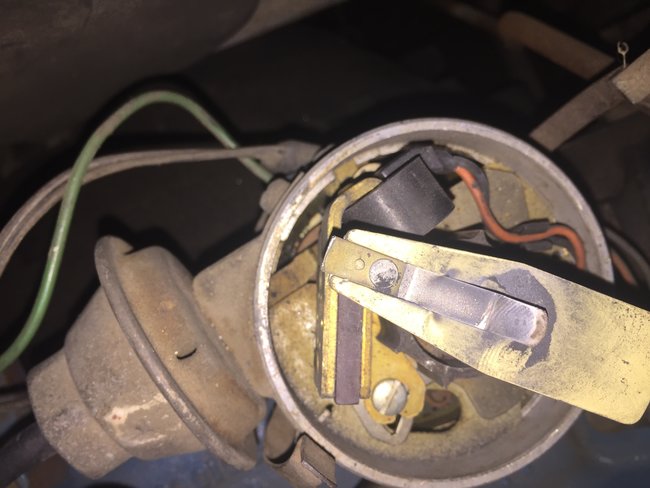

My car is having ignition problems. It will start in the mornings and occasionally stall out when I either hit a bump or go slow while getting ready to park. After this it seems like I am not getting a spark as it refuses to fire. I changed the coil to try to fix the problem but that did not help. The starter is still working strong. While pulling a spark plug to check for spark my ratchet connected from the spark plug to the fender and I saw a spark while the spark plug did not even have a wire on it. I am starting to believe it may be multiple problems going on simultaneously. Any help would be greatly appreciated.

When the engine stalls, try to keep it in the bad state so the problem can be diagnosed. Pull the distributor wire out of the distributor cap, and hold that end close to the engine. Watch for spark there when a helper cranks the engine. If you have no spark there, watch for the presence of a single spark when the helper turns the ignition switch off.
How many pickup coils are in your distributor? Each one has a black and an orange wire going to a two-terminal connector. Some distributors have two of those pair of wires. Some have only one pair.

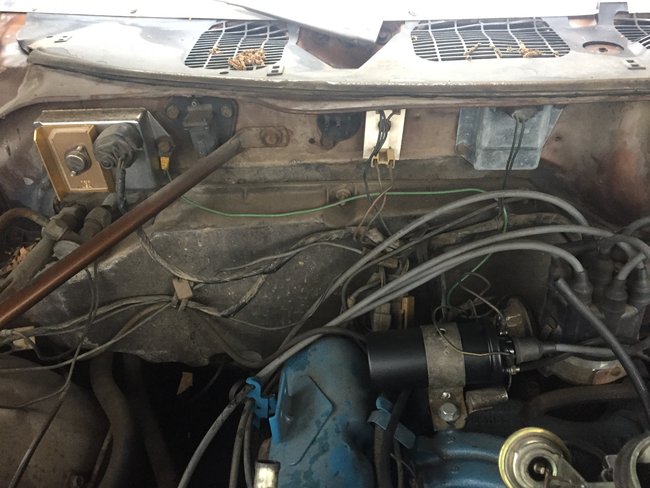

Most of these ignition systems used only one pickup coil. A real common problem on either system was the dual ballast resistor on the firewall, but those will never fail intermittently. Once one of the resistors burns out, it will never magically heal itself again. What you might look for though is a rusty terminal that is creating an intermittent connection. You can identify that by wiggling gently on the connectors while the engine is running.
Next, check the ignition module to be sure it is bolted solidly to a rust-free point on the body sheet metal. That is one of the electrical connections.

I did not. I was able to get her to fire just by turning the key so I could check the ballast. What am I looking for in the "wiggle" test?

The dual ballast resistor has a white two-wire connector on each end, (They can only be plugged in one way, but either plug can go on either end). One has two dark blue wires in it. Those are the two plugs to wiggle. Bad connections are not common, but we don't want to overlook the possibility.

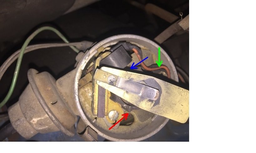

The green arrow on your dandy photo shows where the wires for the pickup coil flex repeatedly. An intermittent connection there can cause intermittent stalling, but usually at a higher road speed, like 35 - 40 mph or more.
My nifty red arrow is pointing to one of the eight points on the "reluctor". It passes a magnet on the pickup coil under the rotor by the blue arrow. If the pickup coil was worked on recently, the air gap is critical. You must use a brass feeler gauge because a regular steel one will stick to the magnet and give a false feel. As I recall from my '78 LeBaron, the gap was supposed to be 0.018", but in later years I remember reading specs of 0.008" and 0.012". Regardless, the gap is tight enough that it could be adversely affected by worn bushings causing the distributor shaft to wobble.
