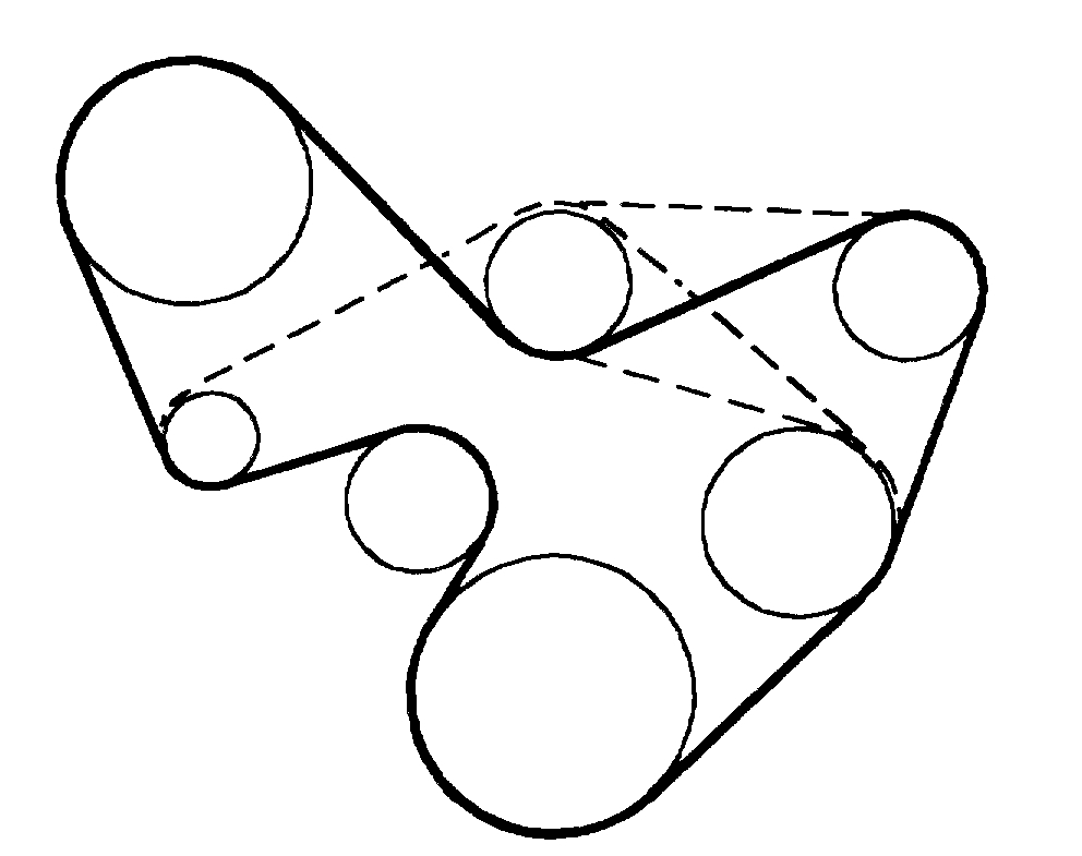

When I'm driving my car it sounds like metal rubbing at stop thinking cams.
Apr 27, 2020 at 6:41 PM
  • 110,194 POSTS

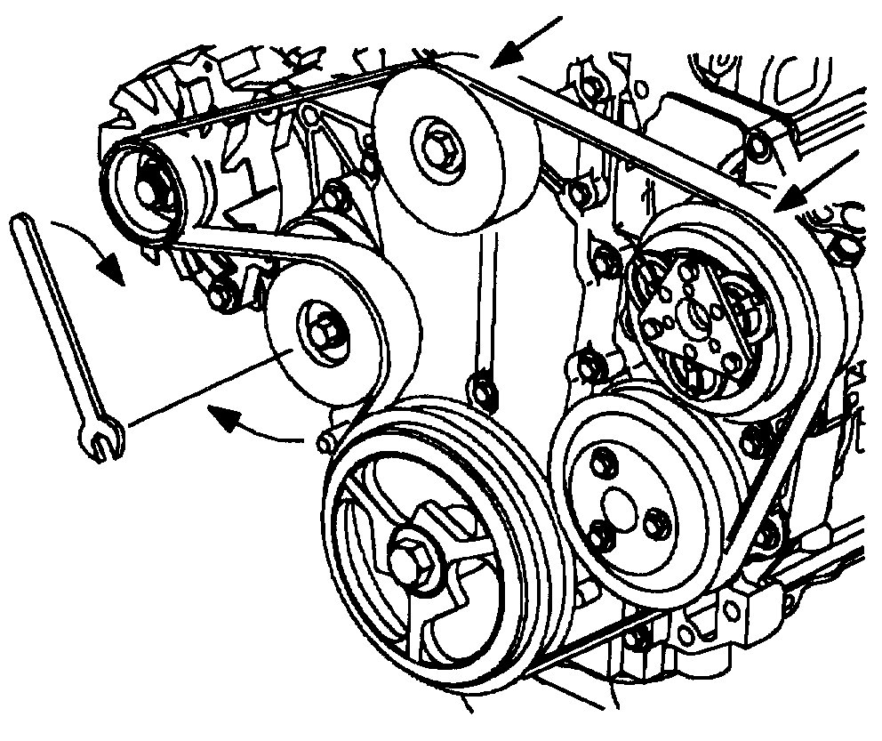

At a stop is the only time you hear it? Do me a favor. Remove the serpentine drive belt and start the engine for a couple seconds and see if the sound is gone.
Here are directions for removal. Only allow the engine to run for a couple seconds with the belt off. Just long enough to determine if the noise is gone. I have a feeling it is a tensioner or idler pulley bearing. The attached pictures correlate with the directions.

Belt Removal
pic 1
1. Depress tensioner arm using a 14 mm or 9/16 inch wrench or Snap-on tool S8190A (or equivalent).
2. Remove belt assembly off idler or A/C compressor pulley.
3. Remove accessory drive belt.
Belt Installation
pic 2
1. Route belt around all pulleys, except front cover idler or A/C compressor pulley.
2. Depress tensioner arm using a 14 mm or 9/16 inch wrench.
NOTICE: Make sure the belt is properly aligned on the pulleys.
3. Slip the belt over the front cover idler or A/C compressor pulley.
IMPORTANT: If the tensioner idler pulley attachment bolt is loosened, remove the bolt and apply Saturn P/N 21485277 (Loctite49 242 or equivalent) to threads. Torque bolt.
Torque: 30 Nm (22 ft. lbs.)

Let me know what you find.
Apr 27, 2020 at 9:49 PM
MONKEY119
I had caliber problem said it was making this sound had fixed. don't hear it anymore.
Apr 28, 2020 at 4:45 PM
  • 110,194 POSTS
Thanks for letting me know. Glad to hear it is fixed for you.
