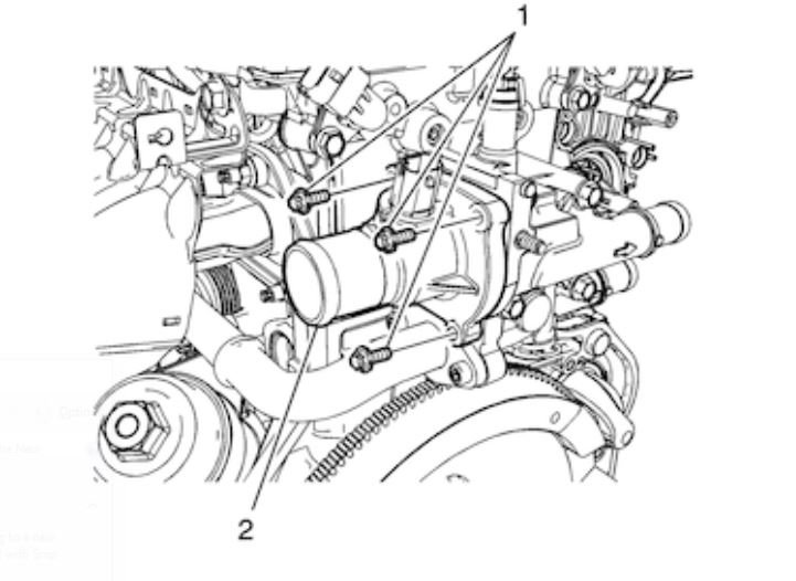

Hello, my car is having the same issues as someone else did with ac not blowing cold and giving me a p0128 code. what was the issue?

The 128 code is for a thermostat. It is stuck open and needs to be replaced. It has nothing to do with the A/C issue.
Do you have pressure gauges to give me the pressures?

I think this started a new question. I have a thermostat coming. I hope I find out what is causing it.

Last week my A/C went out with no warning. then a few hours later the p0128 came up on my car. i went to get it checked they said it is'nt really anything to worry about. Then when i reset the battery my A/C works fine then two days it goes out and the same code pops up shortly after.
Aug 28, 2019 at 7:50 PM
The 128 code is for the thermostat in the engine. It is stuck open and the engine is not getting up to normal operating temperature.
I need the high and low side readings of the AC system while it is running.
