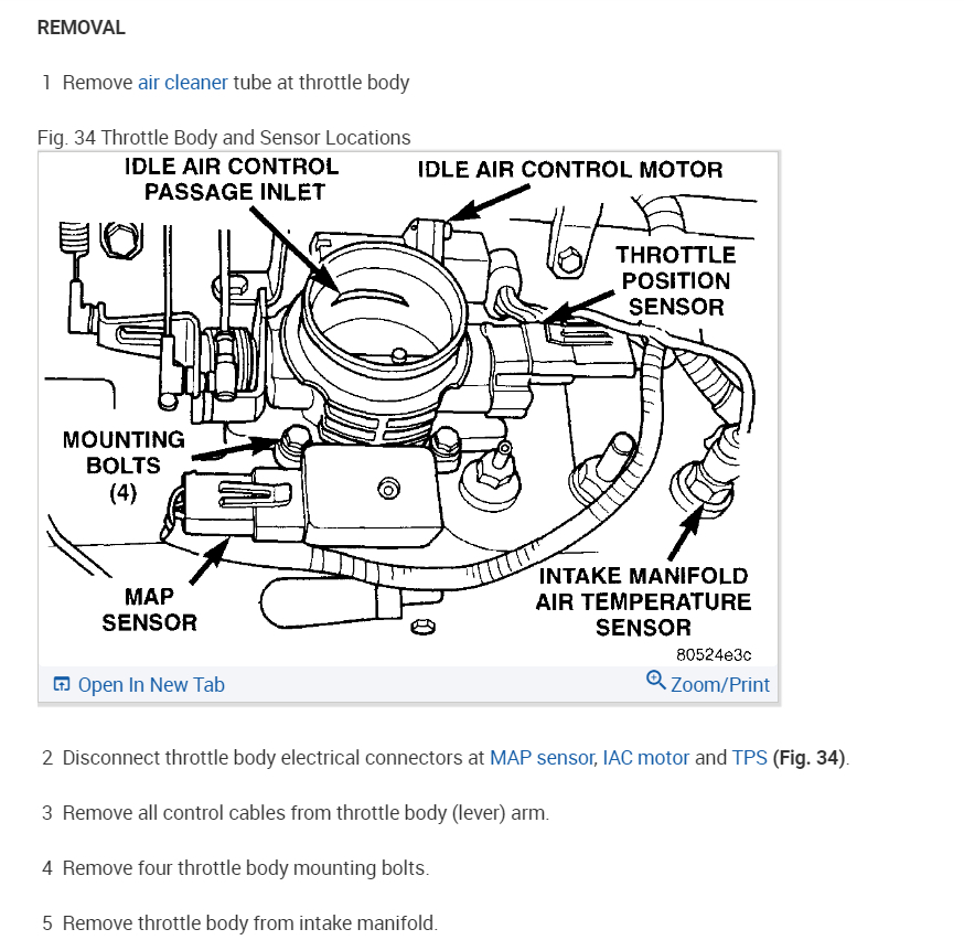

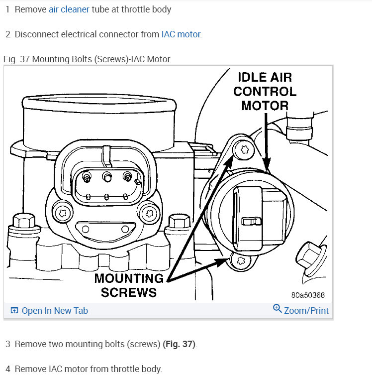

It doesn't seem to have a reason but it's getting worse sometimes fire up normal other times it just keeps turning over shut the key off and try again starts normal sometimes it takes 4 or 5 tries to get it to start other starts first try sometimes.
Jun 18, 2023 at 9:06 AM
  • 55,456 POSTS

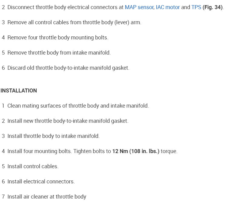

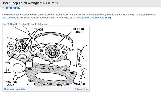

This happens when there is a vacuum leak, low fuel pressure or the throttle body needs to be serviced. Here are guides to help us fix the problem and I have included images below to help you with your car. Also clean the IAC motor as well.
https://www.2carpros.com/articles/engine-cranks-excessively-before-starting
Use this guide when the engine is cold only:
and
Jun 19, 2023 at 10:46 AM
