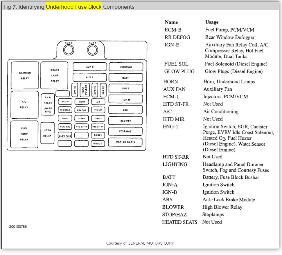

I have a problem of cranking but no start. I have traced it to the fuel pump as it was building no pressure. I replaced tank, fuel pump, fuller neck, fuel filter, fuel pump relay, crankshaft sensor, coil, distributor cap and button, wires plugs, and mass air flow sensor. sometimes it cranks right up then ten minutes later nothing with no fuel pressure again.

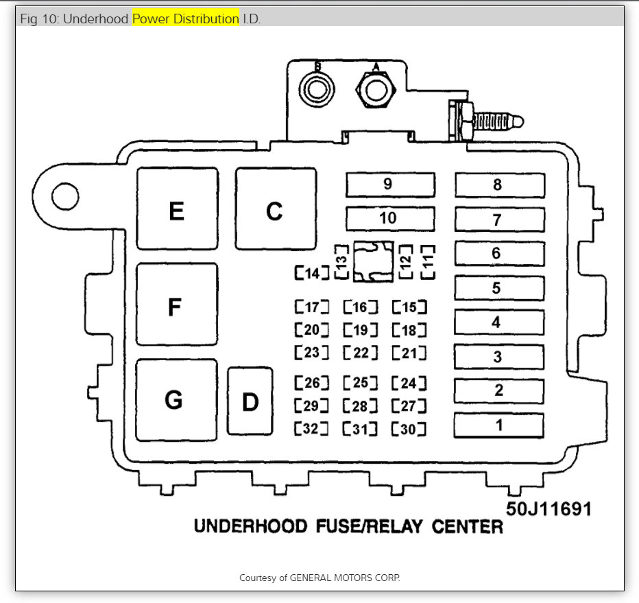

Did you update the connector at the fuel pump? They had a problem with these connectors. Can you verify the fuel pump relay clicks when the ignition key is in the on position please?
