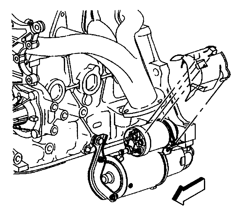

Pickup has a new battery, clutch pressed in all the way, sometimes starts just fine, and sometimes it just clicks once. Wiggle around a bit, stand on your head, move your tongue to the side of your mouth just right and it fires up no problem. What's the culprit?
Jan 22, 2019 at 6:58 AM
  • 110,248 POSTS
Hi and thanks for using 2carpros.com
Either you have a bad connection or a starter going bad. Even though you replaced the battery, make sure the connections are clean on the cables. Also, make sure the grounds from the battery to the engine block is clean and tight.
Now, here is a link that discusses a similar condition. See if it helps.
If that isn't an issue, then I suspect the starter itself if bad. However, we can't be sure unless if fails when it gets checked. If it only clicks once and then works, you won't know when to check it. Regardless, here is a link that shows how to check a starter.
To be honest, since the battery is new, chances are the starter is going bad. If I am correct, it will slowly get worse until it doesn't work. If it leaves you stranded, and this isn't in the repair manual, tap on the starter with a hammer. Tap, not bang. lol Often times that will get you a few more starts from it.

REMOVAL PROCEDURE
see pic 1
CAUTION: Refer to Battery Disconnect Caution in Cautions and Notices.
NOTICE: Never operate the starter motor for more than 30 seconds at a time. Allow it to cool for at least two minutes. Overheating, caused by too much cranking, will damage the starter motor.

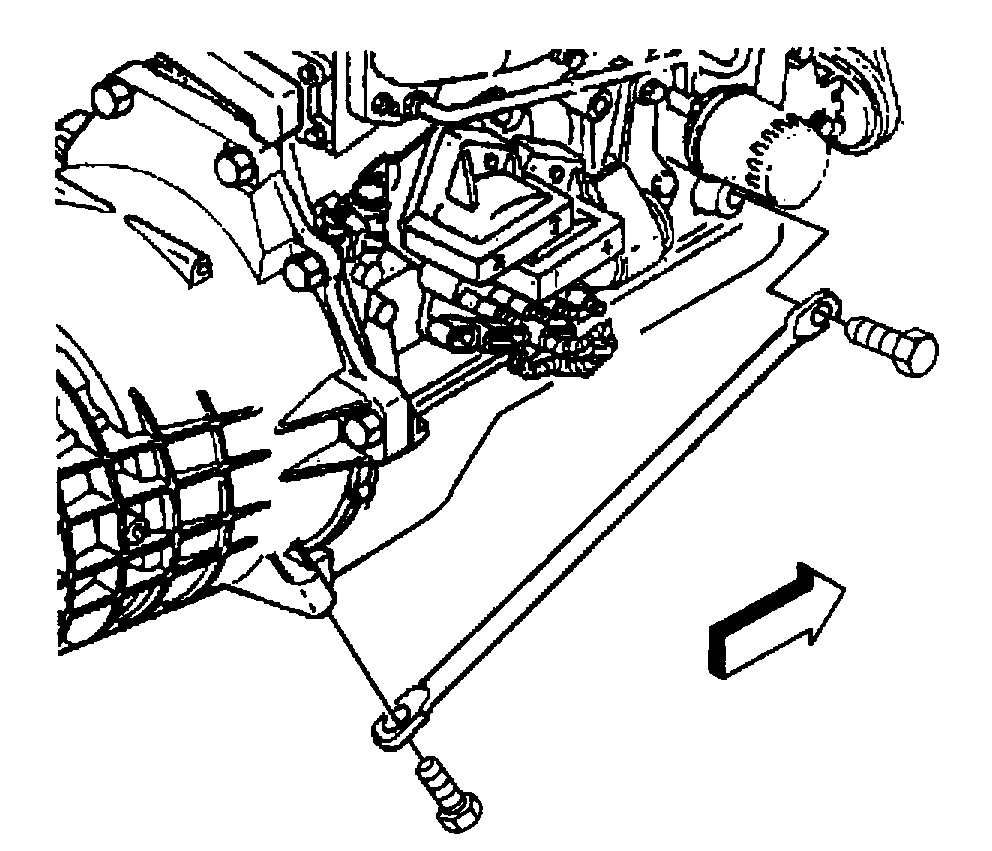

2. Remove the exhaust manifold pipe.
3. Remove the engine to transmission brace rod mounting bolts.
4. Remove the engine to transmission brace rod.

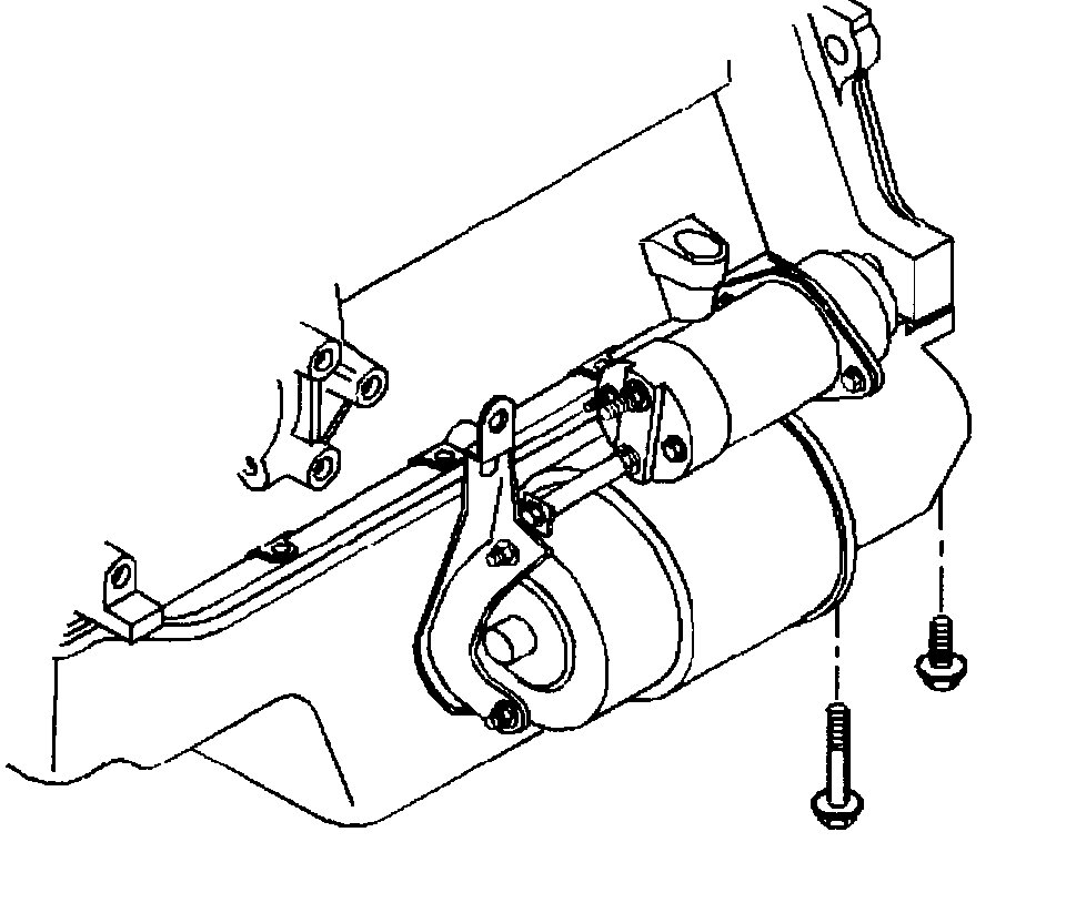

see pic 2
5. Remove the starter heat shield.

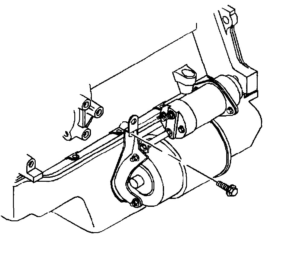

see pic 3
6. Remove the wires from the starter solenoid.

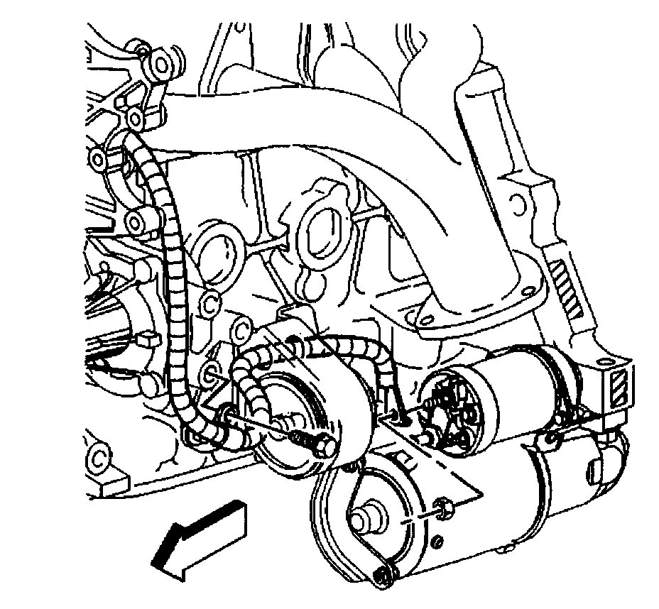

see pic 4
7. Remove the brush end bracket attaching bolt.
see pic 5
8. Remove the starter motor mounting bolts.

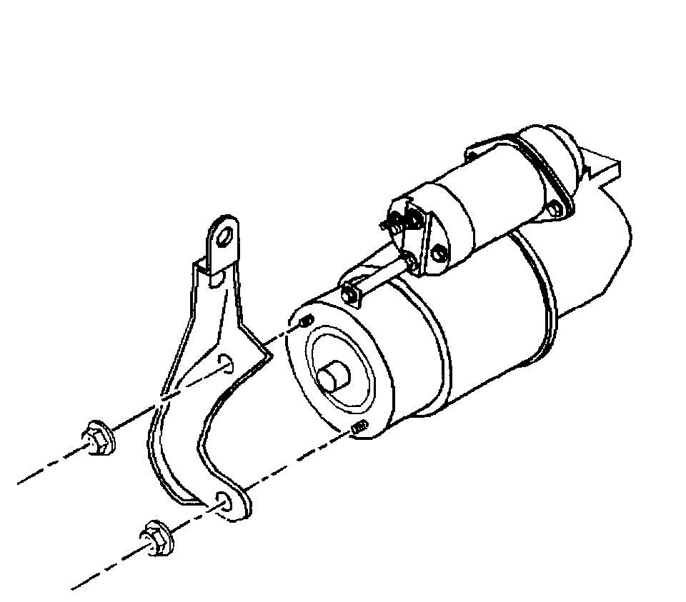

9. Remove the starter from the vehicle.
see pic 6
10. Remove the brush end bracket from the starter, if necessary.
