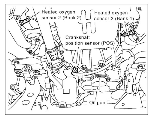

Sometimes on highway car would suddenly start missing and then turns off. After a wait it could be started again.
Engine light was on few days ago then went off by itself. Tried to connect obd2 but it showed no code. Last month obd2 showed these codes, but I did not find information regarding these codes P03350A, P032800, and P0335F5.

The code P0335 which is the crankshaft position sensor I would replace it first. Here is a guide and a diagrams below to show you where the sensor is which is under the car ion the transmission bell-housing:
