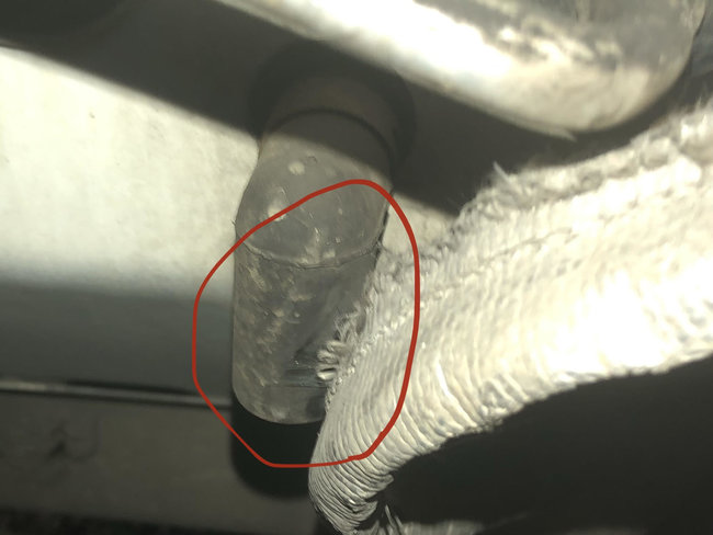

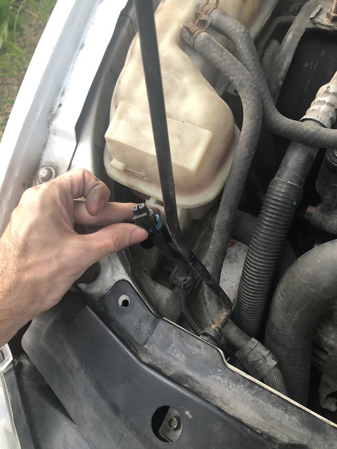

Running into an issue where the A/C is stuck on defrost mode and was told to check for a vacuum hose leak in my car.
I found this thing that isn't plugged into anything but don't see anywhere to plug it in... any ideas?
Also, I don't see any hose connected in the second picture, back by the fire wall???

Pic 1 is an electrical connector and pic 2 is the A/C drain.

Discovered that connector actually plugs in underneath the coolant reservoir.
