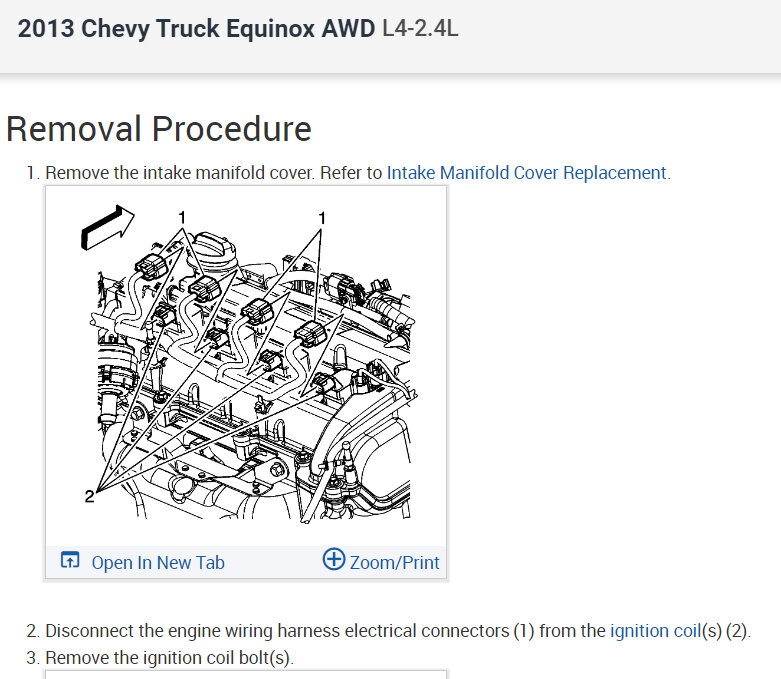

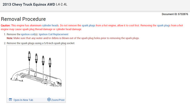

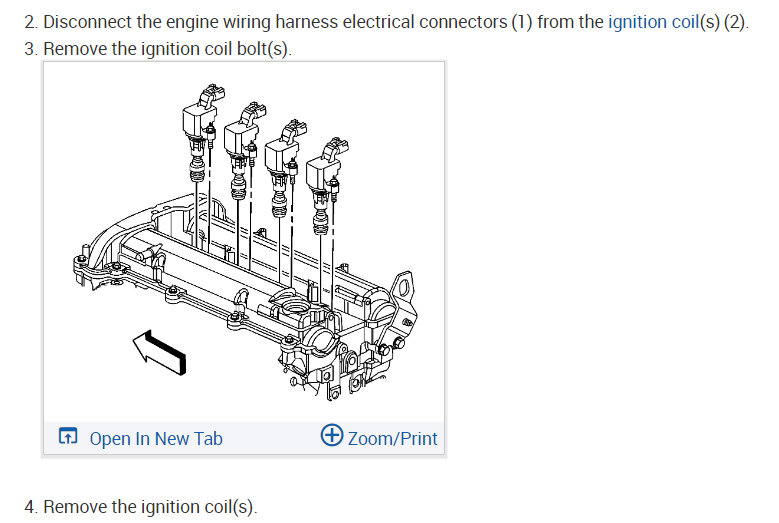

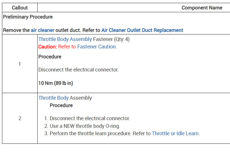

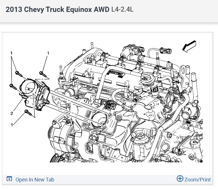

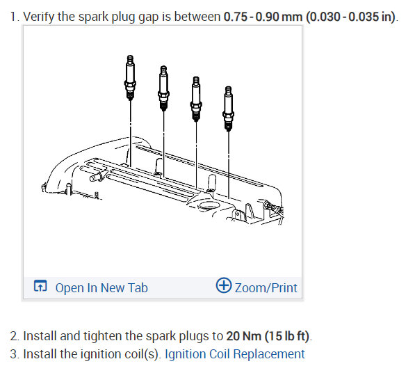

Also, if any engine tune up has not been done, I would start there and I would service the throttle body, here are two guides to help you see what you will be doing and the instructions for your car in the images below.
https://www.2carpros.com/articles/how-to-tune-up-a-car-engine
Check out the images (below). Please upload pictures or videos in your response of any problems so we can see what to help you with.
