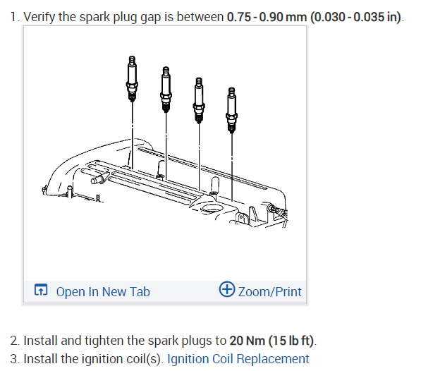

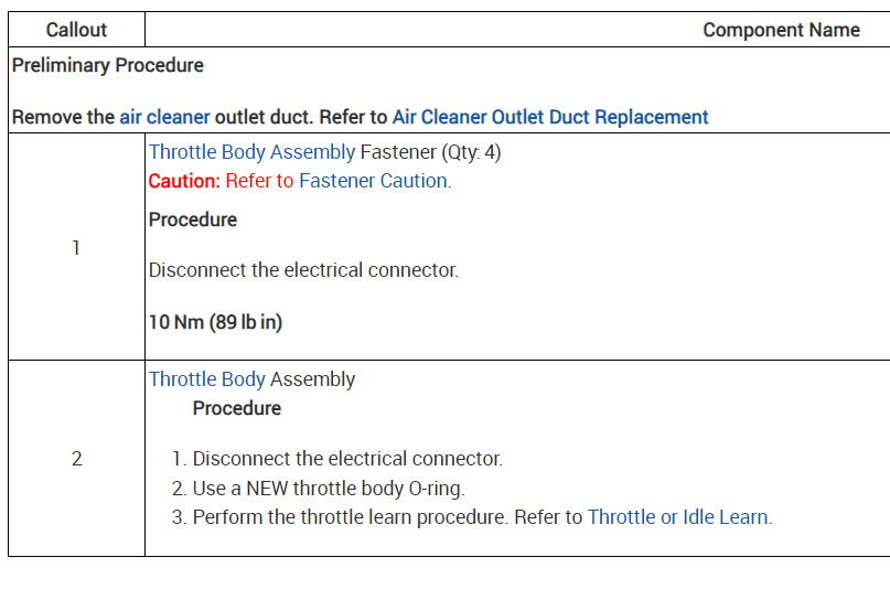

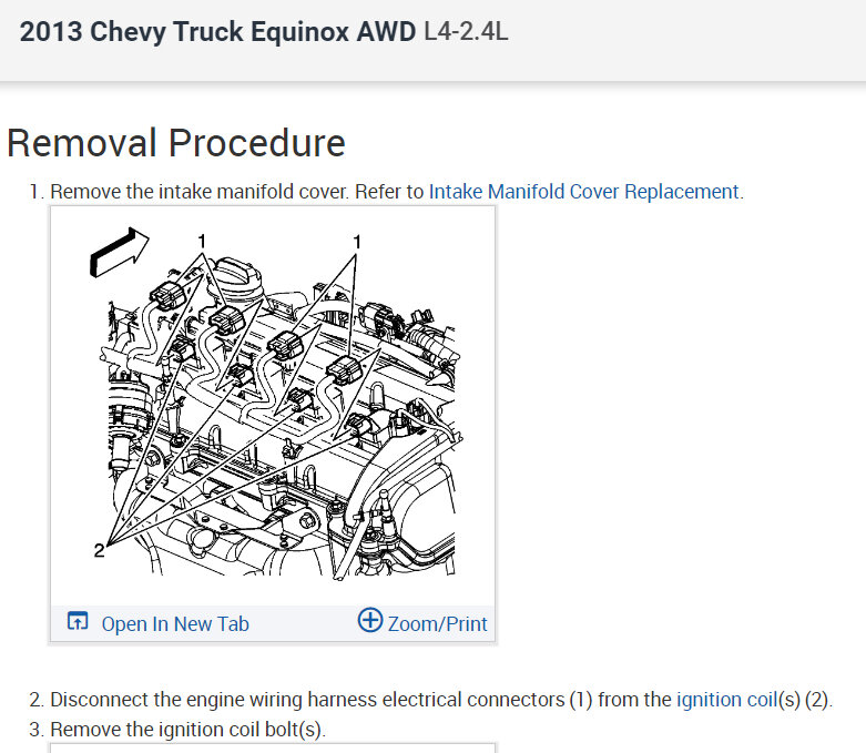

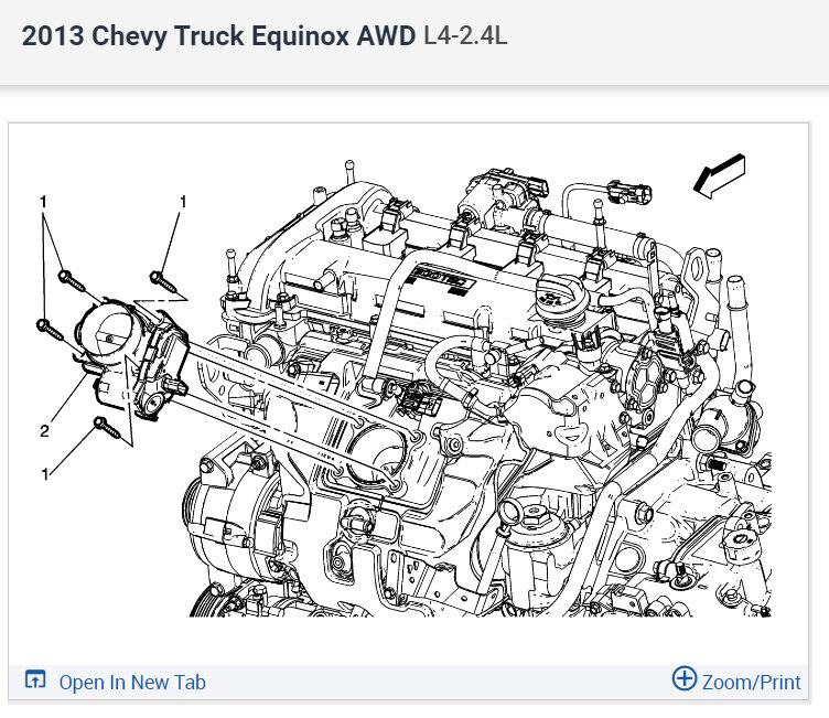

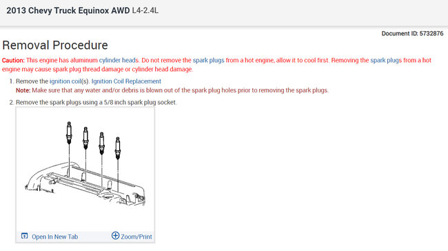

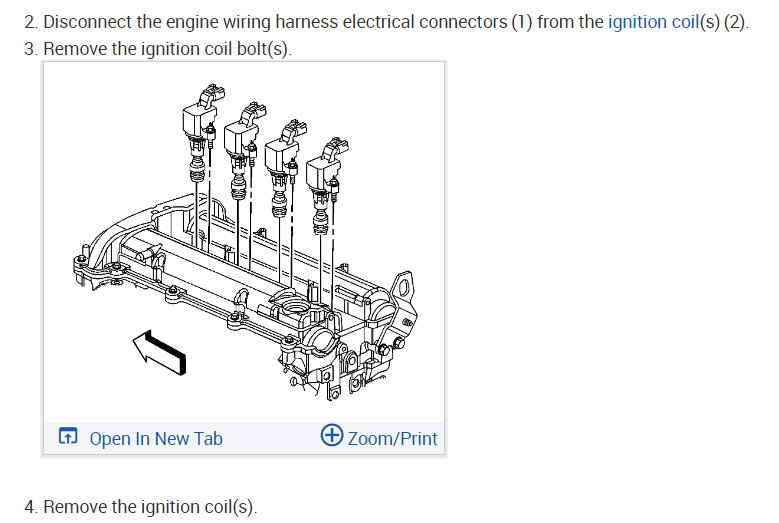

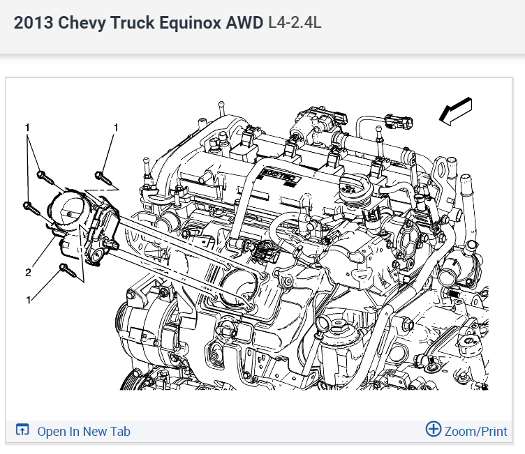

It sounds like you may have a fuel pump going out, there is no fuel filter in this vehicle and there is a strainer inside the fuel tank that generally does not need to be replaced. Even though there are no codes I would run them anyway to see if any are stored, this will help guide us in the right direction on which way to go to fix it.
Also, if any engine tune up has not been done, I would start there and I would service the throttle body, here are two guides to help you see what you will be doing and the instructions for your car in the images below.
https://www.2carpros.com/articles/how-to-tune-up-a-car-engine
Check out the images (below). Please upload pictures or videos in your response of any problems so we can see what to help you with.
