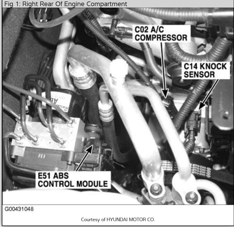

Where is the knock sensor?
Thursday, September 15th, 2016 AT 11:52 AM
HMAC300
MECHANIC
48,601 POSTS
See picture for location.
