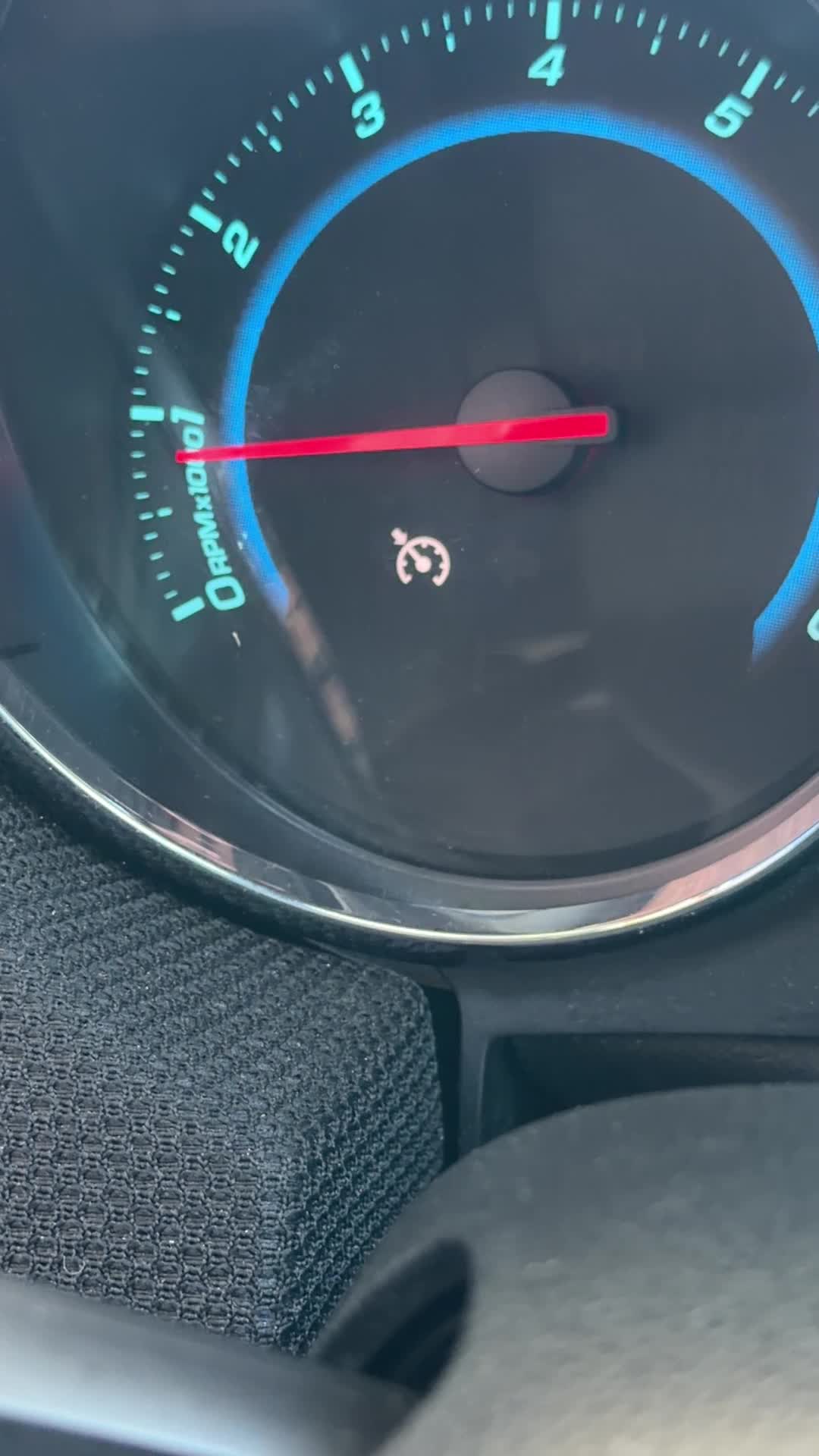

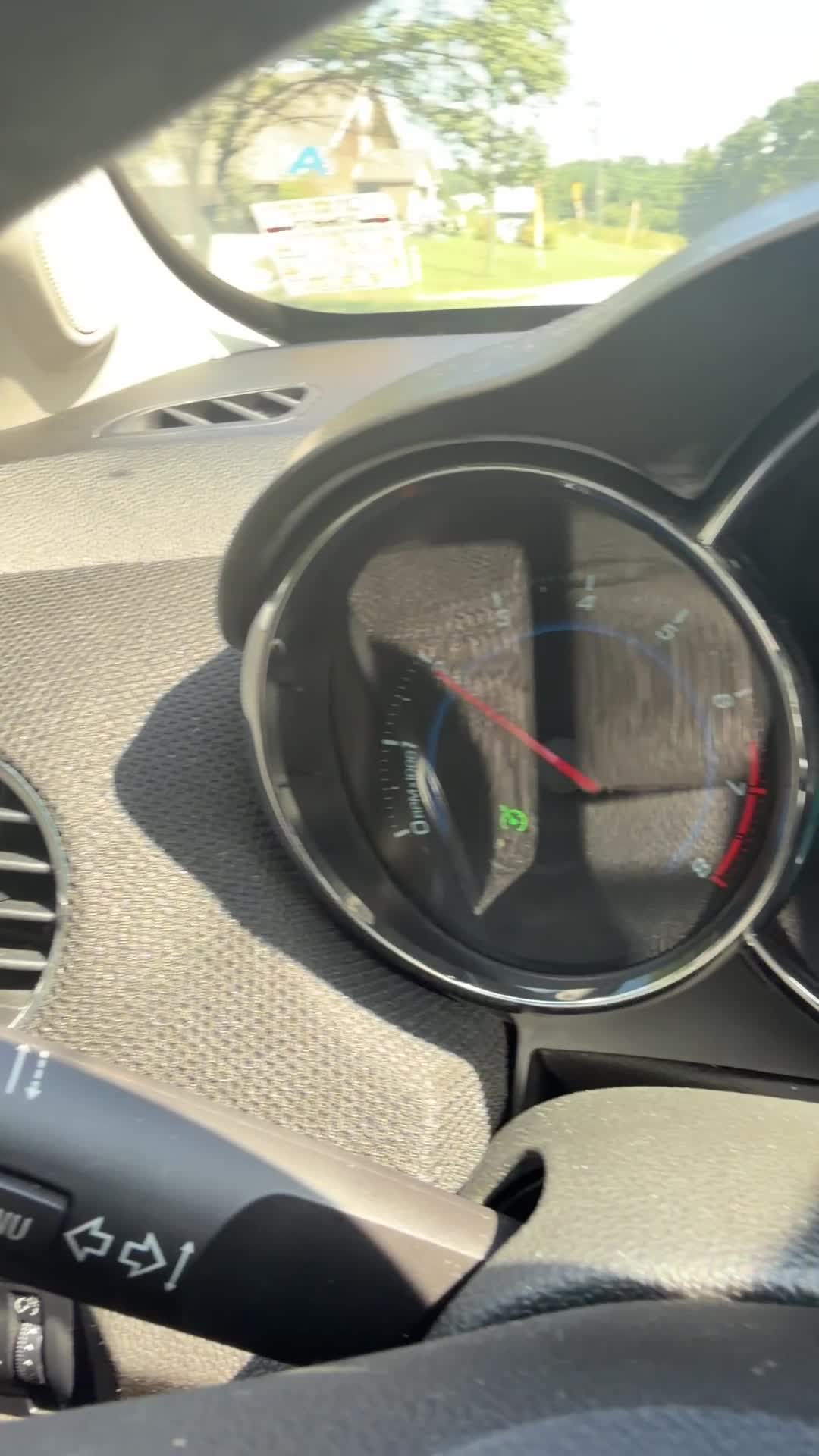

When in drive. Say in a drive through i notice a bit of dipping and then going back to where it was and i can feel it. In neutral it does not do it

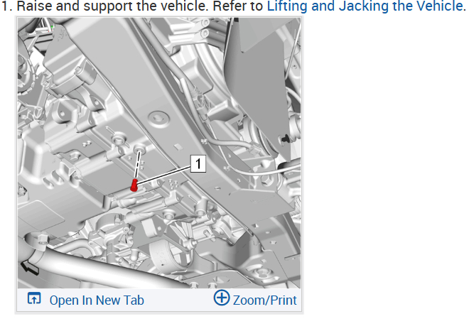

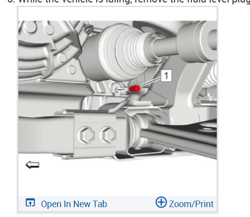

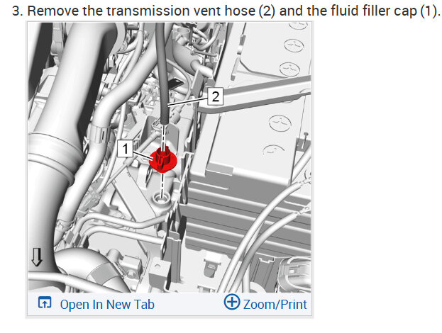

Yep, can I ask if there are any codes? also I would service the transmission as well. Here is a video to help get the codes and service the transmission.
https://www.youtube.com/watch?v=LBCpCWEFnTg
and this guide to help service the transmission
https://2carpros.com/articles/how-to-service-an-automatic-transmission/
Automatic Transmission Fluid - DEXRON VI
Let me know how it goes.
