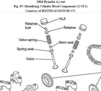

In the diagram it is labellled as HLA ( Hydraulic Lash Adjuster)
https://images.2carpros.com/forum/automotive_pictures/192750_HydraulicLifters04Accent_1.jpg
For this type of HLA, tap it on a wooden block to get the internals to come out, together with and oil inside that could be causing them to be oveextended. Clean with petroleum based cleaners and reassemble by pushing them in. Apply a thin coat of engine oil before reassembly. Were the HLA removed and reinstalled according to their respective position on valves?
May 19, 2017 at 6:33 AM (Merged)

i have done what advice that you guys give and it seams that the car is going to be fine. there is still some knocking at the engine but as you say before, the noise will fade away. i hope it is true. until then, if there is any more problem i will consult to you more. as for now THANK YOU for all the advice, figure and diagram that you gave me. it is sure make it easy to solve it.
