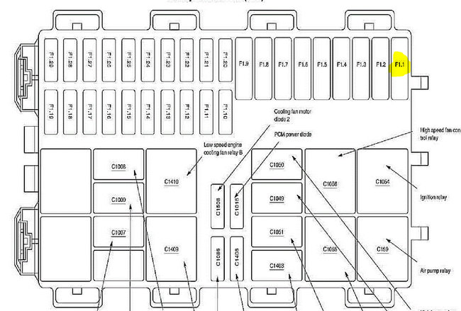

Tested all the fuses and fuse number 19, 18, 17, 16, 15,
29, 27 not working.
And the big fuse 1 is not working.
My air conditioner just stop blowing one day. what could be my problem?

Are all these fuses in the battery junction box under the hood? Also, are there any other symptoms other than the A/C problem?
I attached a pic below showing the battery junction box. I highlighted fuse one. If that is the fuse that is bad, replace it to see if the others have power then.
Also, check to see if there is power to any of the fuses if you haven't already. Here is a link that you may find helpful:
Let me know. Also, I need to know what else has stopped working (if anything). I looked up the fuses you mentioned, and they cover several different things.
See pic below.
