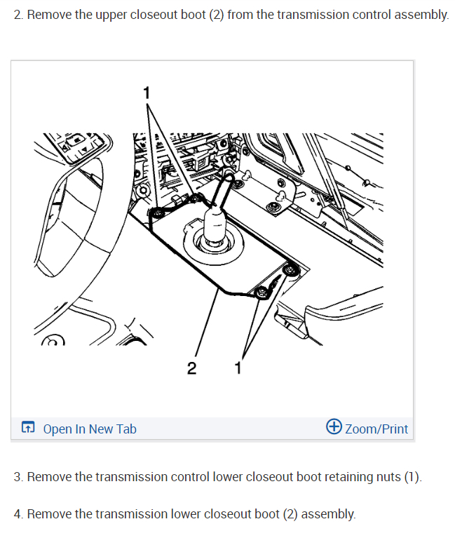

Clutch was recently replaced in the C7 Corvette Stingray prior to me purchasing. I'm not sure if this is related, but shifting into 7th and reverse, somewhat in 6th, takes a lot more effort than the lower gears. Reverse probably being the worst. I was told it could possibly be the alignment of the shifter?
Aug 9, 2024 at 7:14 AM
  • 55,395 POSTS

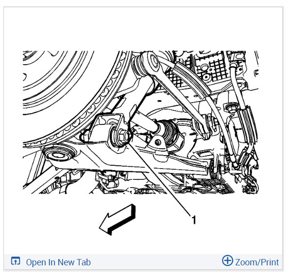

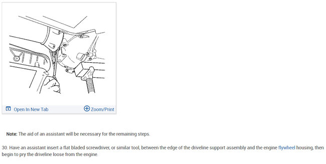

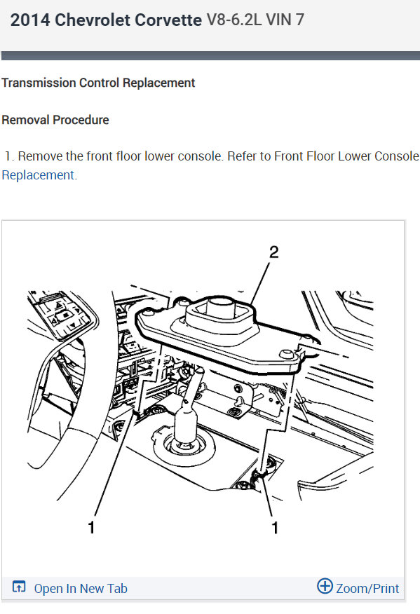

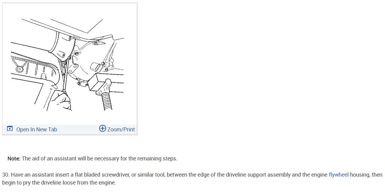

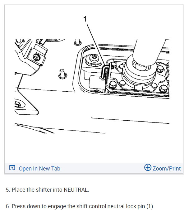

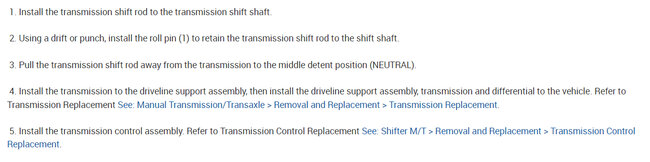

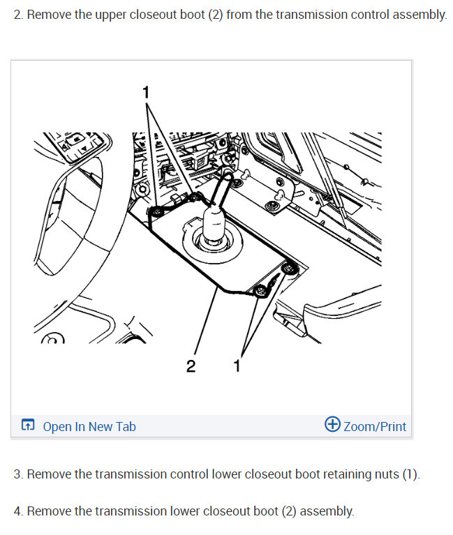

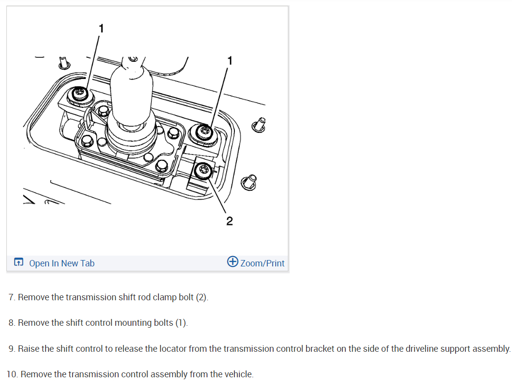

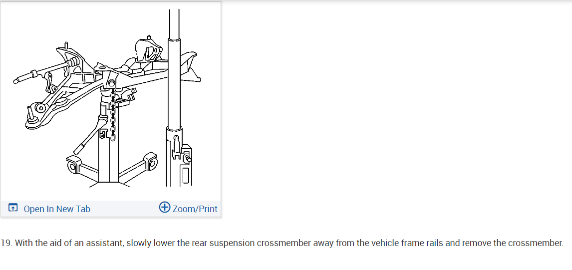

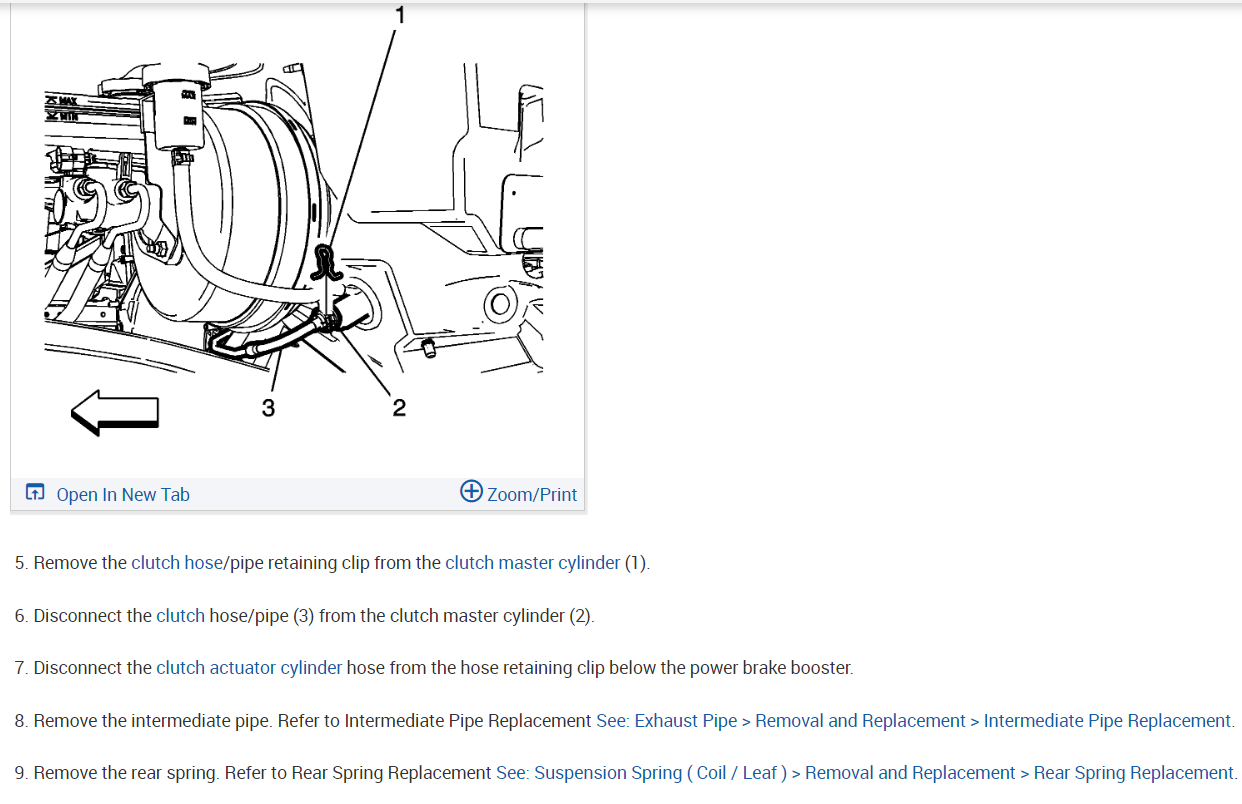

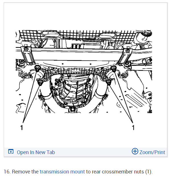

Yes, the shifter rod can be the problem, but the clutch itself may also be an issue, can I ask if you can run through the gears easily with the engine off? (clutch depressed). If so, the clutch could be an issue, here is the shift rod and how to adjust it. I also included how to remove the shifter in case you need it. Check out the images (below). Please upload pictures or videos in your response of any problems so we can see what to help you with.

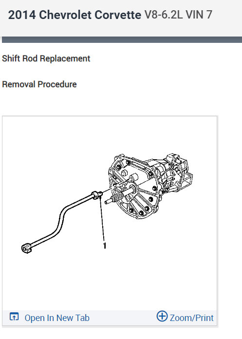

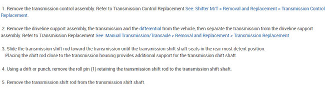

Yep, this will be the shift rod then. Something is it not adjusted right or the shift rod got bent during the repair.

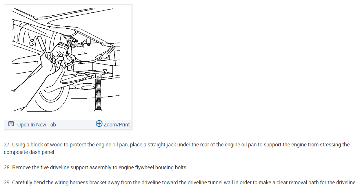

No! Don't say that! Can it cause more damage if I continue to drive it, if I stay in 6th gear until I can get it into a shop? I don't want to make it worse! Also, what is removed to get to the shift rod?
Aug 12, 2024 at 2:25 PM
  • 55,395 POSTS

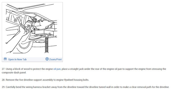

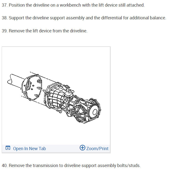

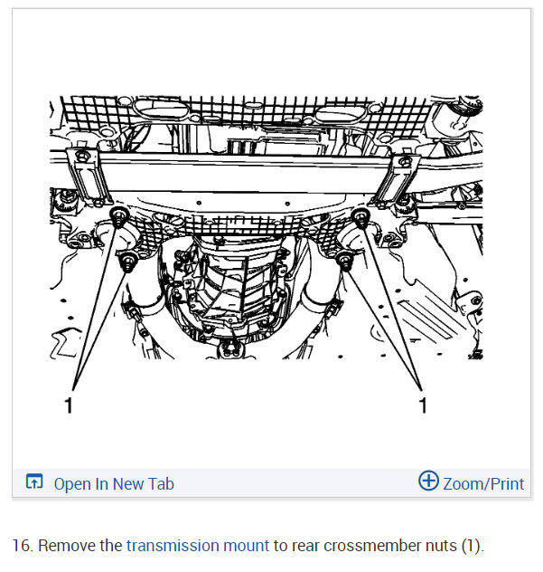

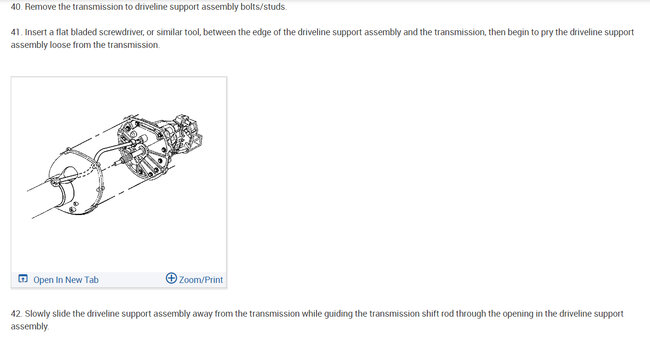

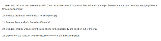

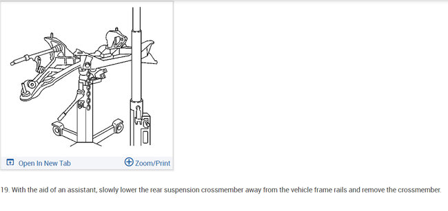

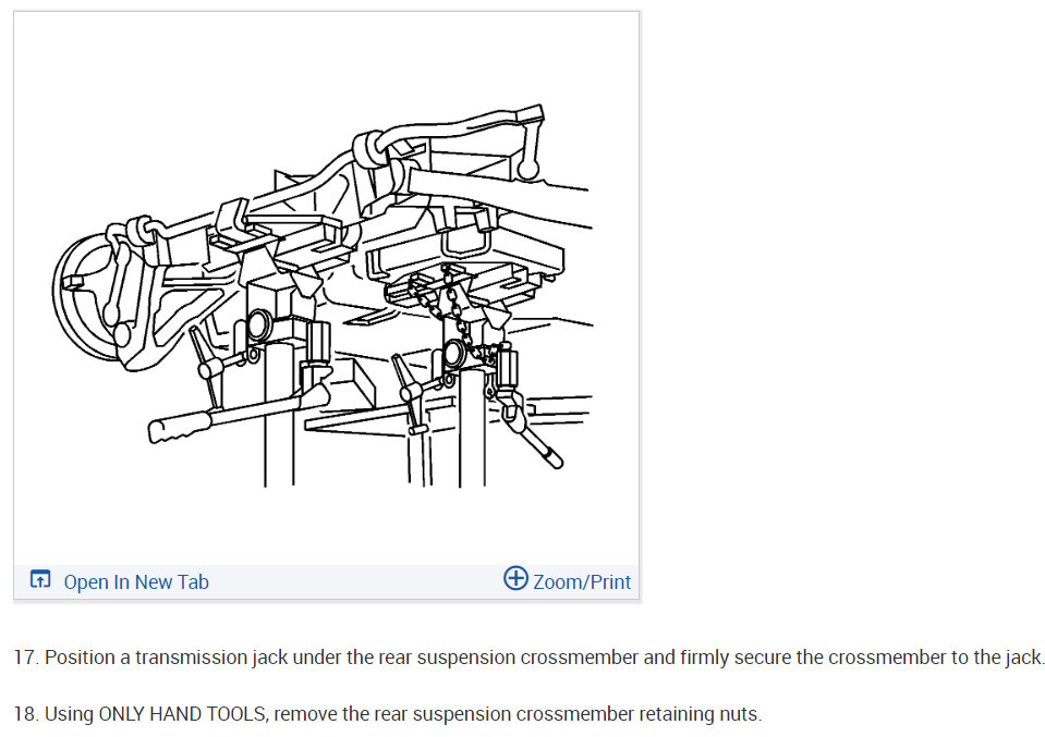

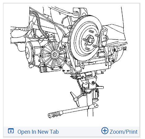

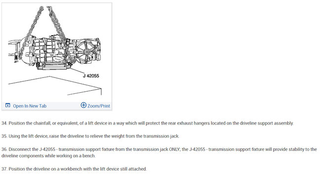

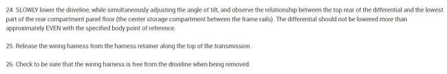

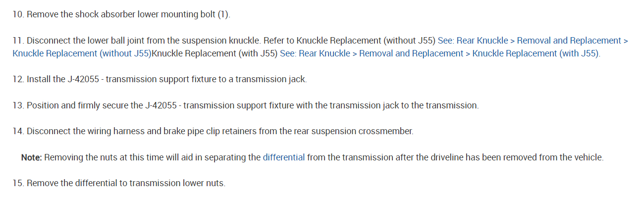

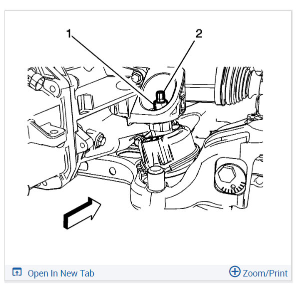

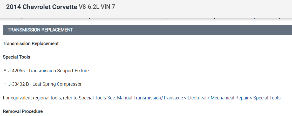

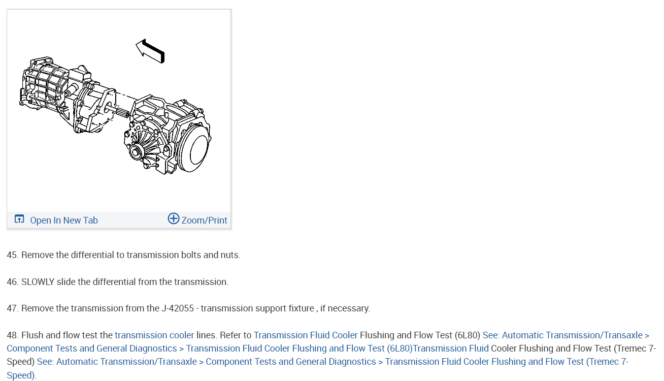

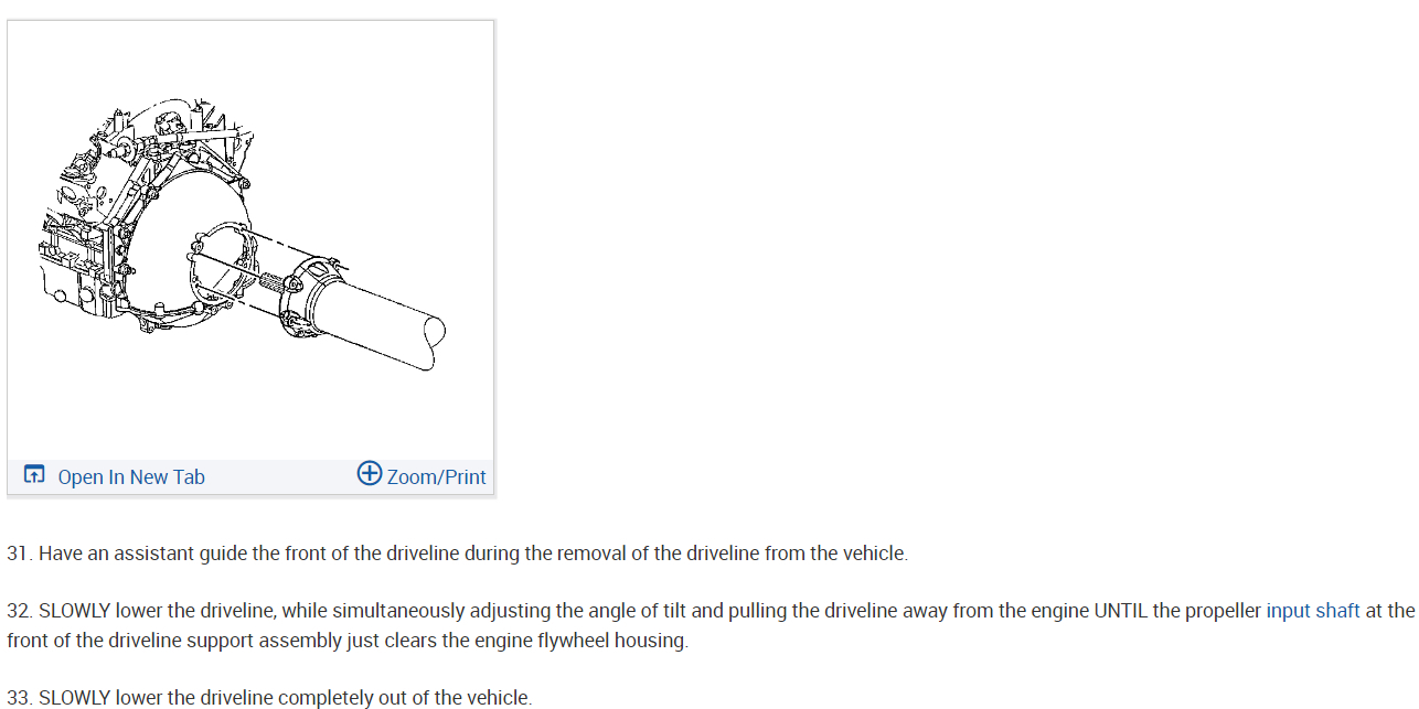

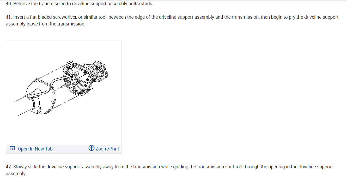

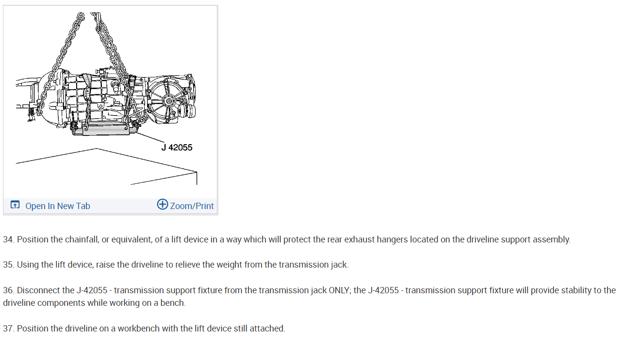

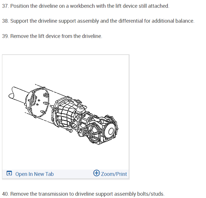

Yep, sorry but the transmission will need to come back out. Here is what needs to be done to fix it, I would not drive it too much until you can get it into the shop for repairs. Check out the images (below). Let us know how it goes.

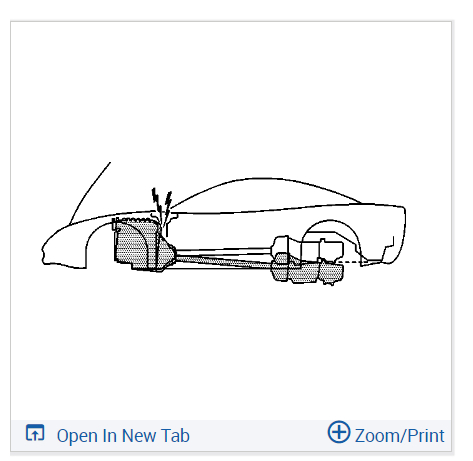

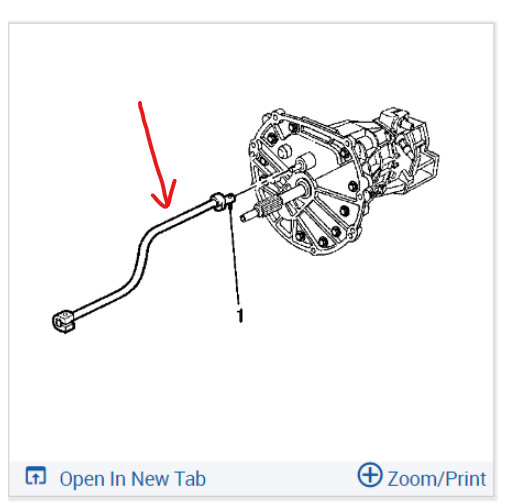

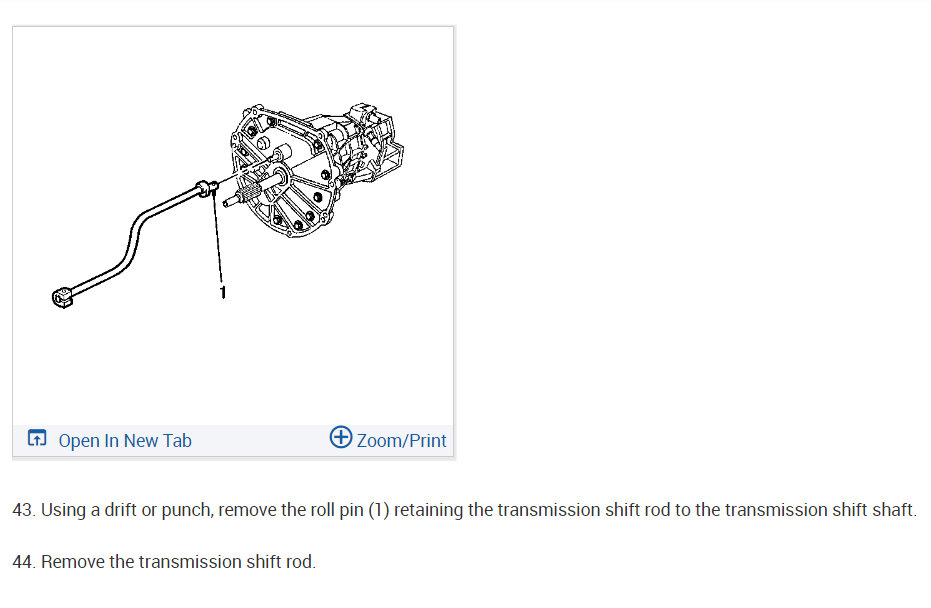

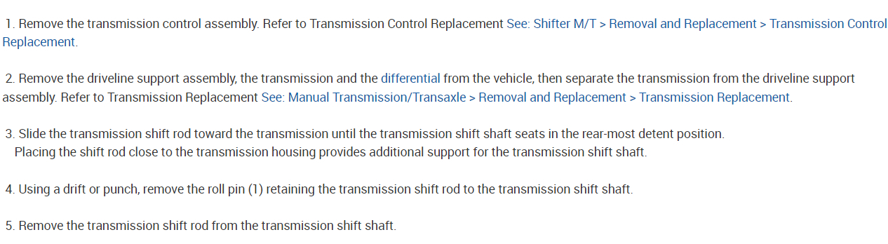

Not really, the transmission must be removed to check the shift rod. To me though it sounds like the clutch disc got damaged while installing it. You might want to try replacing the clutch master cylinder because the fluid sounds like it is contaminated which will hinder its operation. I am sorry you are having these issues; I suggest calling around to see if you can find a corvette specialist that knows these cars and have them take a look at it. You can see by the diagrams below the shift rod is internal.
