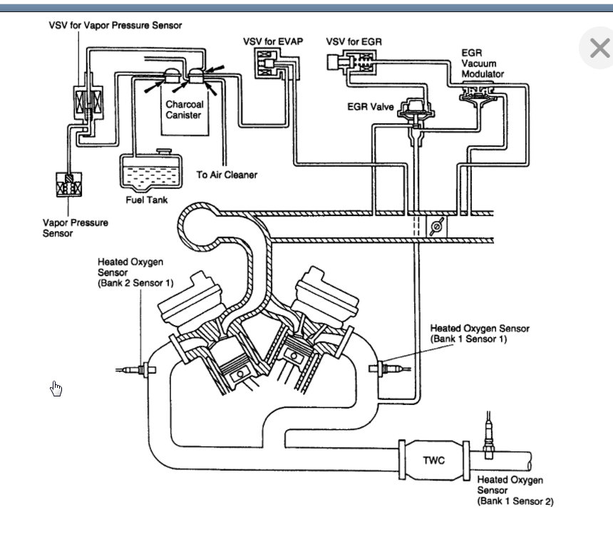

what solenoids are needed on the engine block and how do i run the vacuum hoses? where can i find a picture of the solenoids location and position along with where to run vacuum hoses from them?
Oct 10, 2020 at 10:05 PM
I am attaching the diagram from the manual. Take a look at this and let us know if you need more info. Thanks.

it's an automatic. i believe it's the valve assembly with EGR solenoid, etc. and hose diagram is needed.

EVAP

i meant to aau EVAP.
Oct 11, 2020 at 12:26 AM
Sorry. I am confused on what you are looking for. The diagram that I provided has the EVAP system and hose routing. It shows what hose goes to each component.
Just let me know if I am misunderstanding and I will see what we can get.
Maybe get a photo of what you are dealing with and we can see what info you need. Thanks
