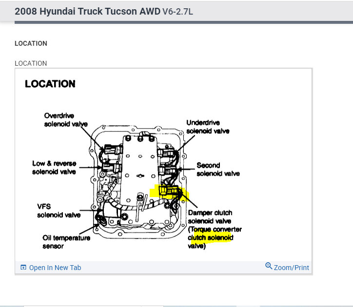

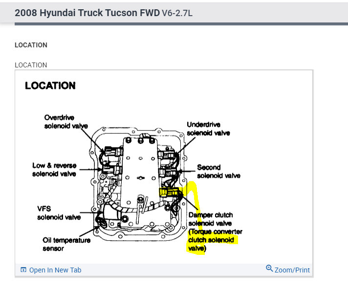

The vehicle listed above has a 2.7. Is the torque converter solenoid is located on the inside or outside transmission?
Feb 19, 2023 at 10:50 AM
  • 110,244 POSTS
The torque converter solenoid is mounted on the valve body inside the transmission. To access it, you need to drain the fluid and remove the pan.
I am using information for a 2wd model. If you have an AWD, let me know.
I attached a pic below showing the location of the solenoid.
See pic below.

Thank you. Yes, it's a 4WD.
2008 Hyundai Tucson 2.7. If you can please send me a pic of a 4WD torque converter solenoid location model.
Feb 20, 2023 at 8:53 AM
  • 110,244 POSTS
I looked it up for the AWD. It's the same. I reattached it below. To access it, you need to remove the transmission oil pan.
Let me know if I can help.
