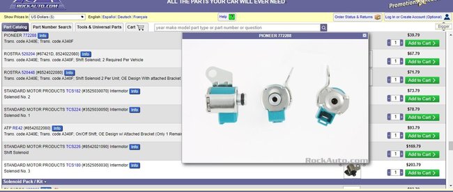

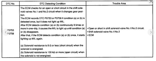

Greetings to all, I have a fault code PO753,shift solenoid "a", but I do not know where it is located exactly, or the part number to be able to acquire it.
May 10, 2020 at 3:10 AM
Good afternoon,

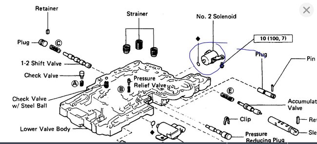

The solenoid is on the valve body in the transmission.
The valve body has to be dropped to access the solenoid.

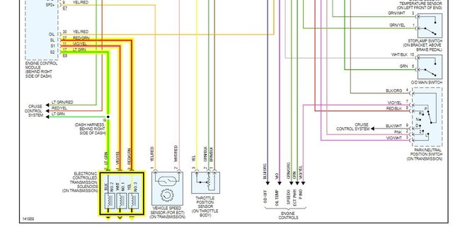

I would verify power and grounds first before assuming it is bad. Codes identify failed areas, not always bad parts.
I attached a wiring diagram for you to check the power.
