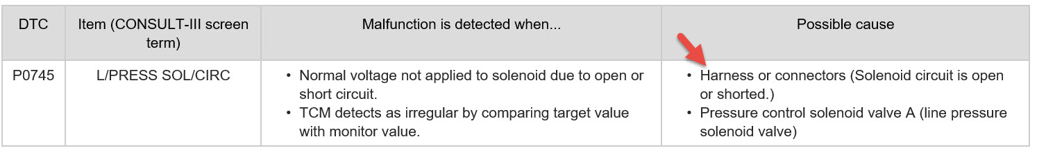

I put the scanner on this vehicle and it said pressure control solenoid malfunction. could you tell me what that means and the location of this solenoid.

code is po745.

see picture for possible causes which can be a TCM or wiring issue we have no pictures of that solenoid as it is inside the transmission which a transmission guy should really look at this. there are two different transmissions for this which one is a CVT transmission and has not been out, but only a few years so a lot of transmission guys are not to familiar with it. it may be a harness /connection problem as well especially as other transmission is doing the same thing as first one did.
