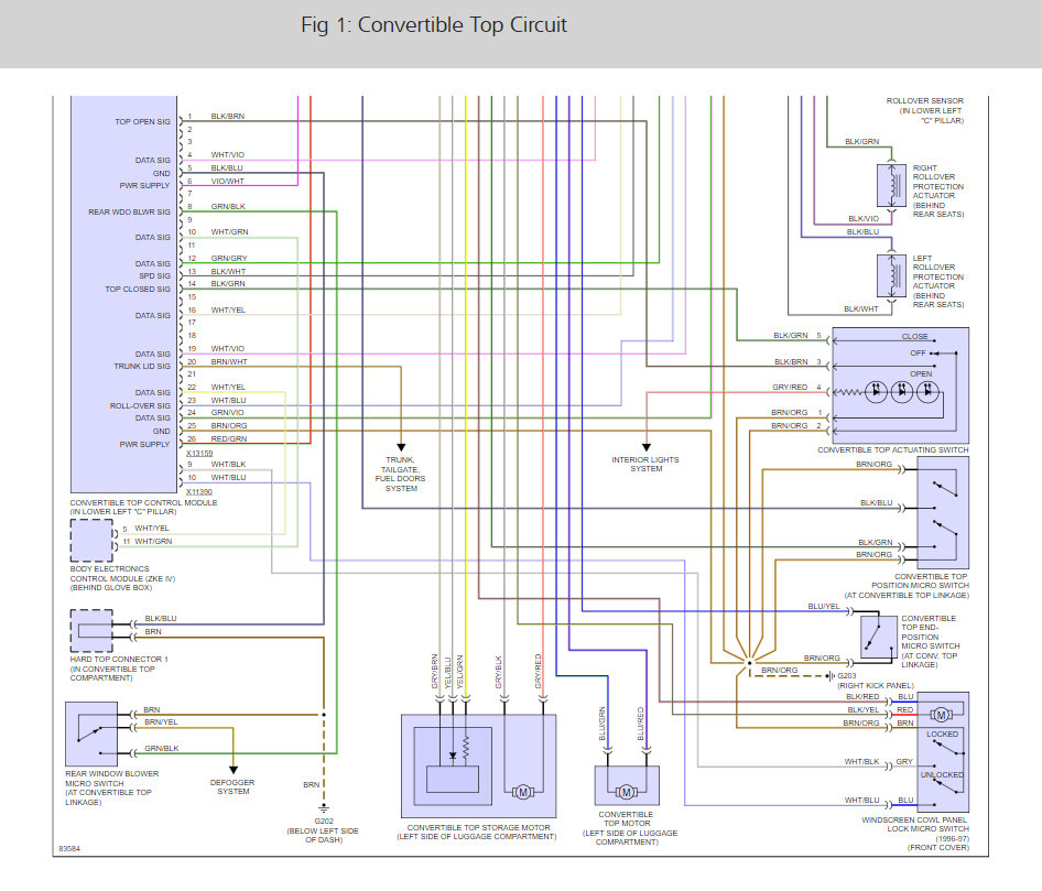

No power to switch and fuses are good.
Mar 5, 2019 at 7:16 AM
Experienced Mechanic
55,649 POSTS

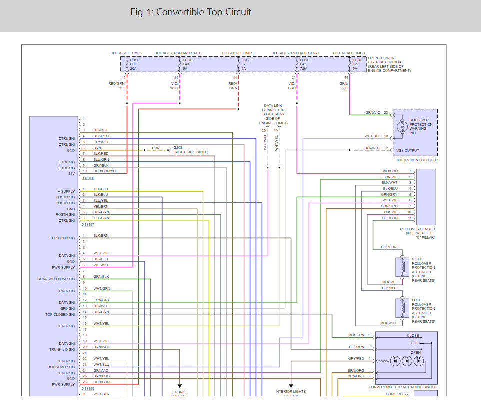

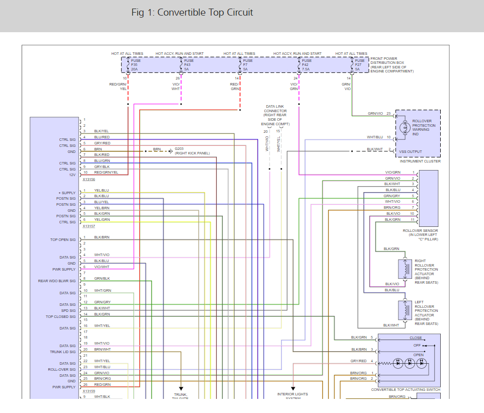

Okay lets check for power at the five fuses that run the system. here is a guide to help us get started and the wiring diagrams so you can see which fuses and how the system works:
Check out the diagrams (below). Please let us know what you find.
