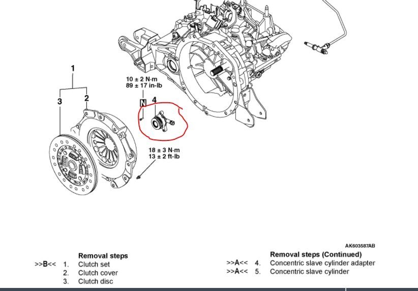

Good morning,
Does the pedal feel normal? If it does, then the clutch assembly needs to be replaced.
https://www.2carpros.com/articles/throw-out-bearing-replacement

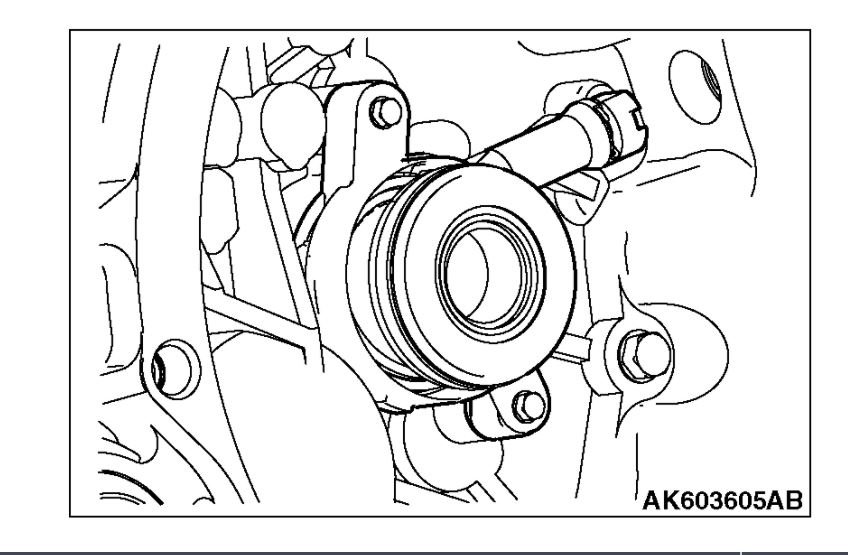

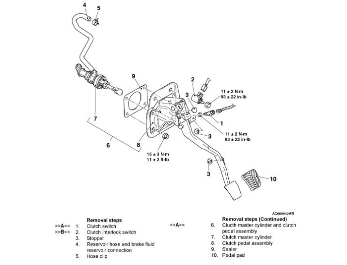

If not, then it could be the clutch master cylinder. The slave is part of the throwout bearing on the transmission.
https://www.2carpros.com/articles/how-to-replace-a-clutch
https://www.2carpros.com/articles/clutch-doesnt-work-sometimes-or-not-at-all

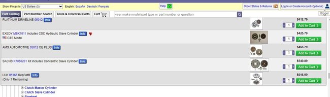

What clutch comes standard in it? It's a 2.0L 4 cylinder 5 speed? Price checking parts and alternative replacements.
Jan 24, 2021 at 1:28 PM
OEM parts from the dealer will be the most expensive.
We use Luk as our parts as they have a great warranty.
I attached the parts from Rock Auto below.
