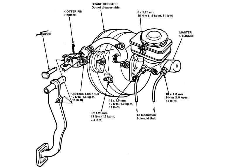

Brakes goes to floor, but car stops and when pressed. the engine idles up and down.

This sounds like you have a bad brake booster. When it leaks vacuum, the idle will change. It should never change.
https://www.2carpros.com/articles/brake-pedal-goes-to-the-floor
