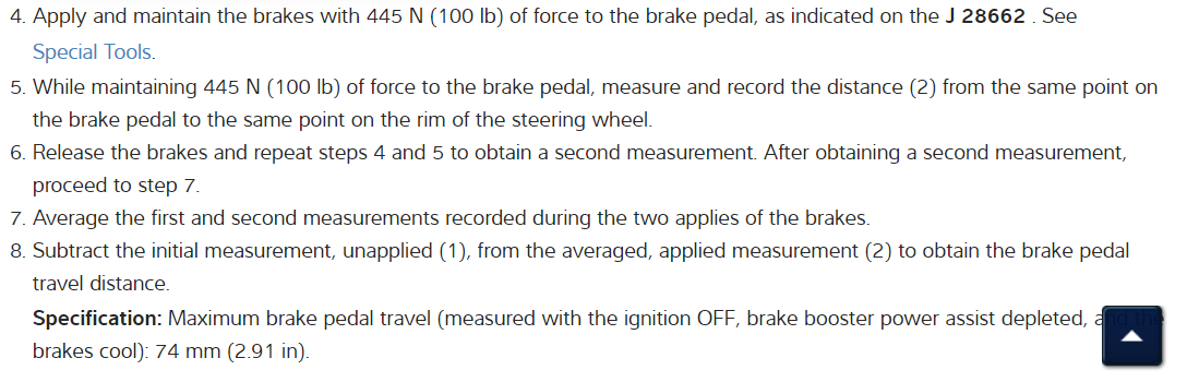

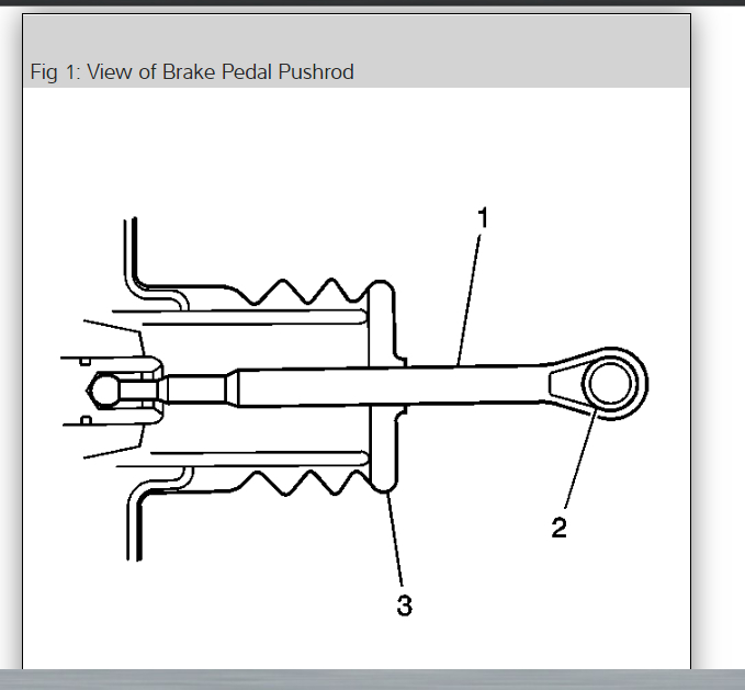

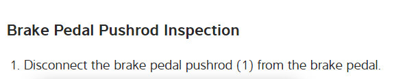

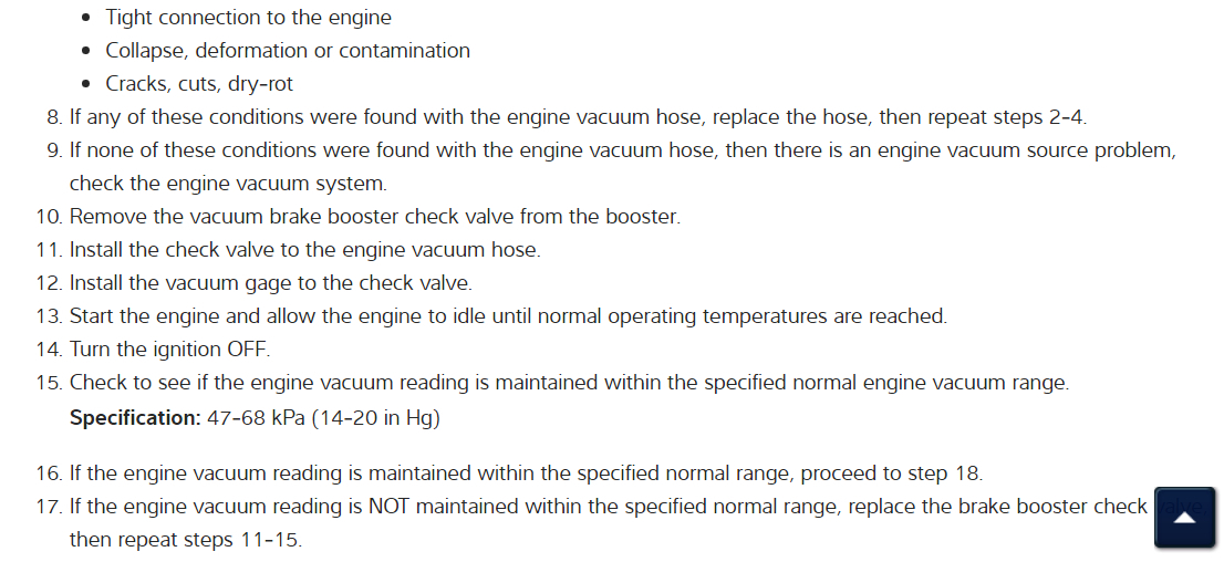

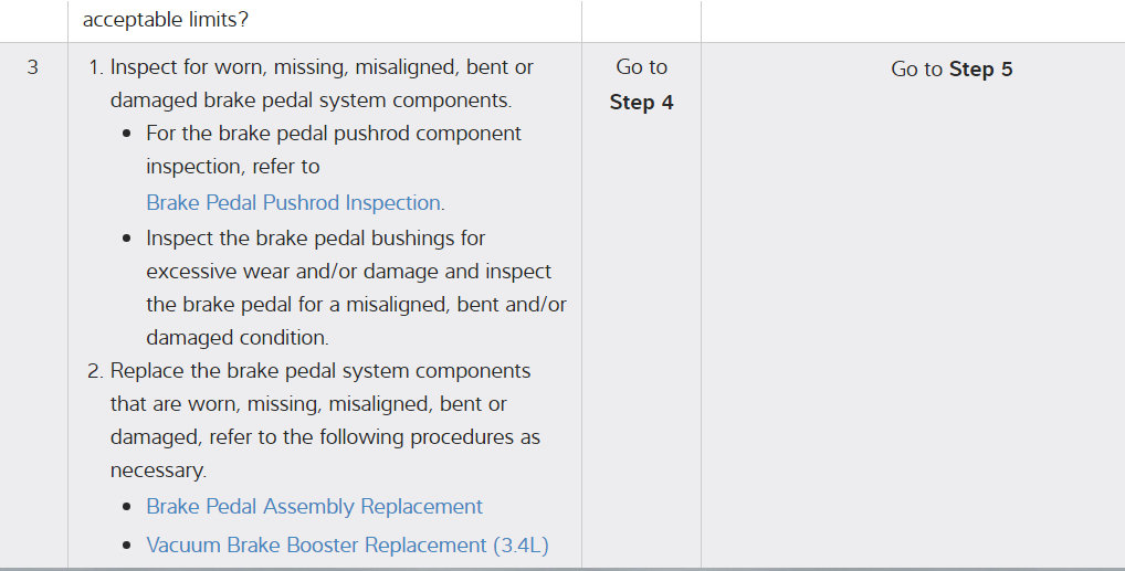

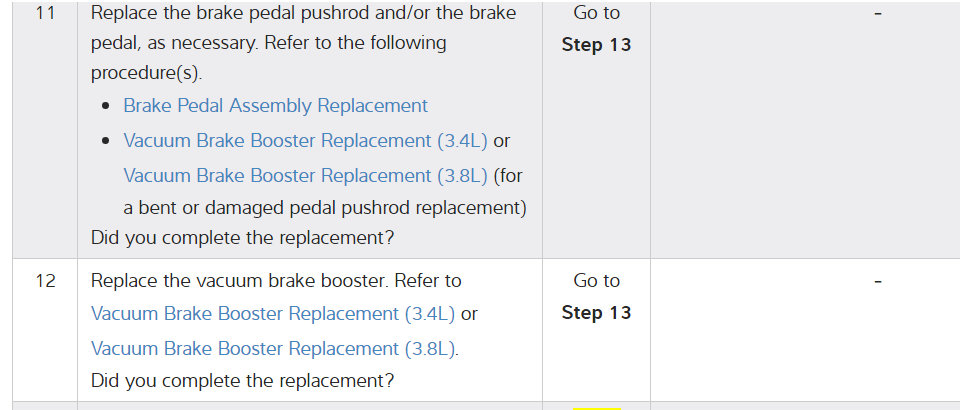

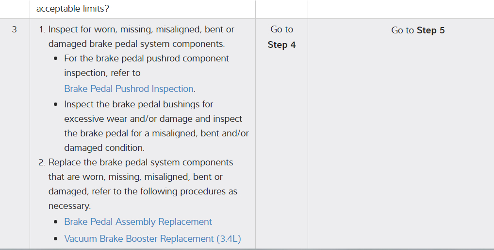

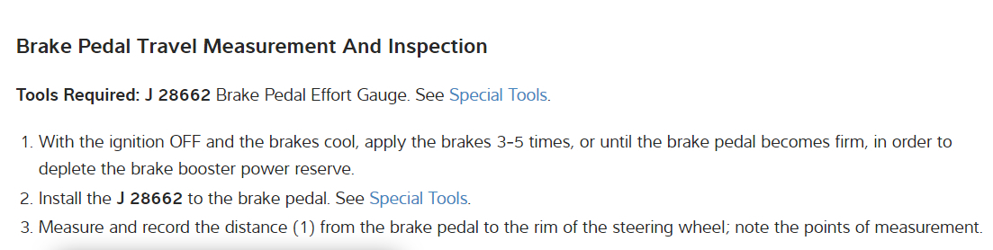

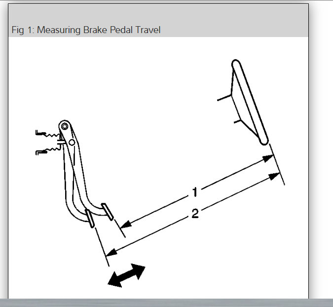

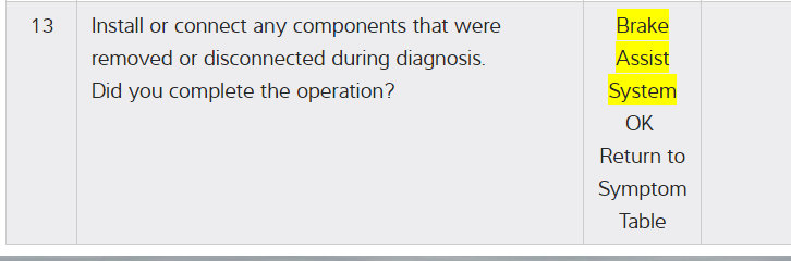

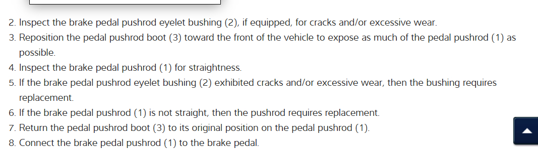

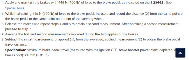

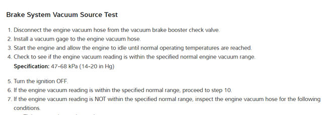

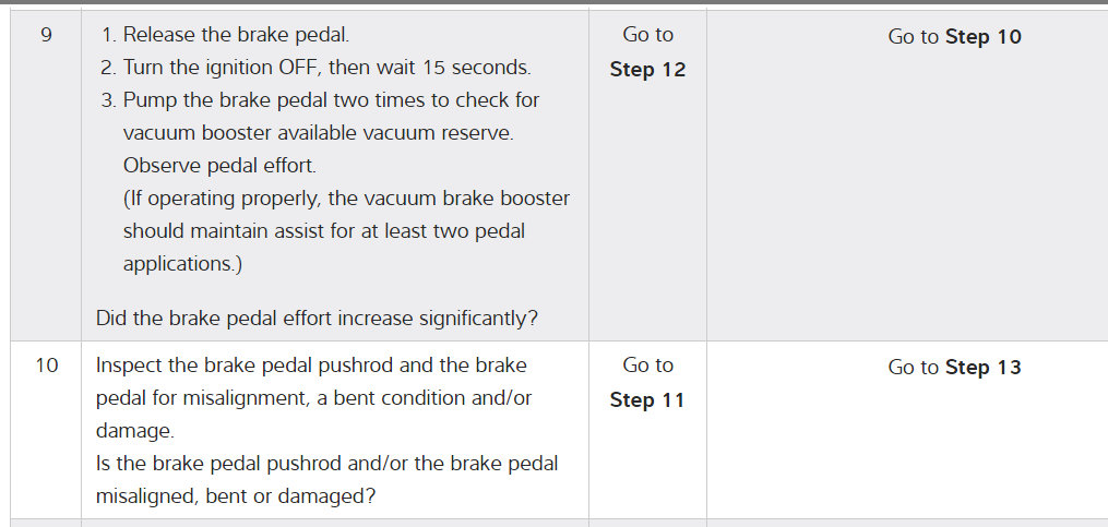

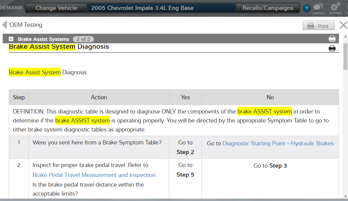

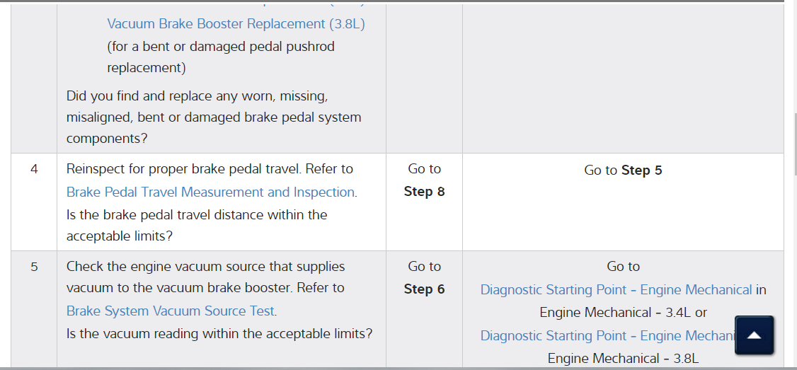

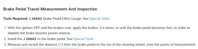

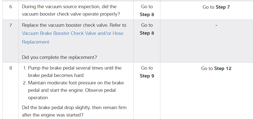

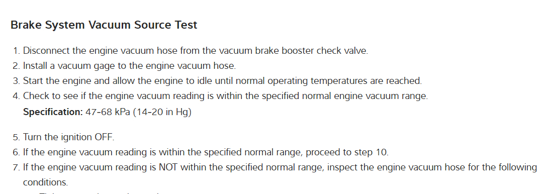

Have you check the vacuum hose for a leak? Okay, anyways I have included in the diagrams down below a factory Brake Assist Troubleshooting Guide for you. Please go through the guide and get back to us with what you are able to find out.
Thanks,
Alex
2CarPros
May 16, 2019 at 5:32 AM

EROSE0120
I do not have ABS. Vacuum works good but booster doesn't hold pressure. The check valve and gasket seem to work. When I sucks on vacuum hose to booster it seems to hold and I can't blow through the same hose.
May 16, 2019 at 9:46 AM
SCGRANTURISMO
  • 4,897 POSTS

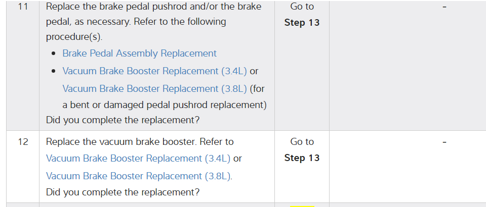

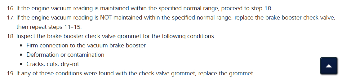

Hello again,
Sorry for not sending the troubleshooting guides. I must of had a glitch on my end with something. Here they are in the diagrams down below:
May 16, 2019 at 2:26 PM
  • 55,273 POSTS
The valve can be bad inside the booster. also when you replaced the master did you bench bleed it? if not here is a guide to help:
