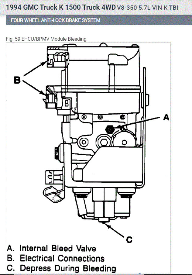

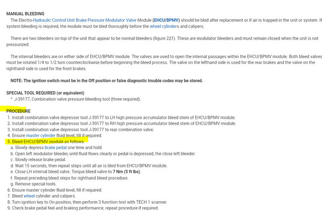

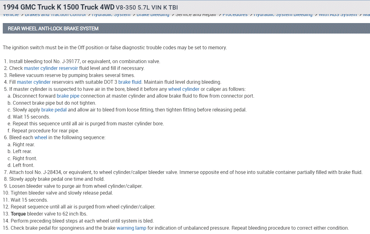

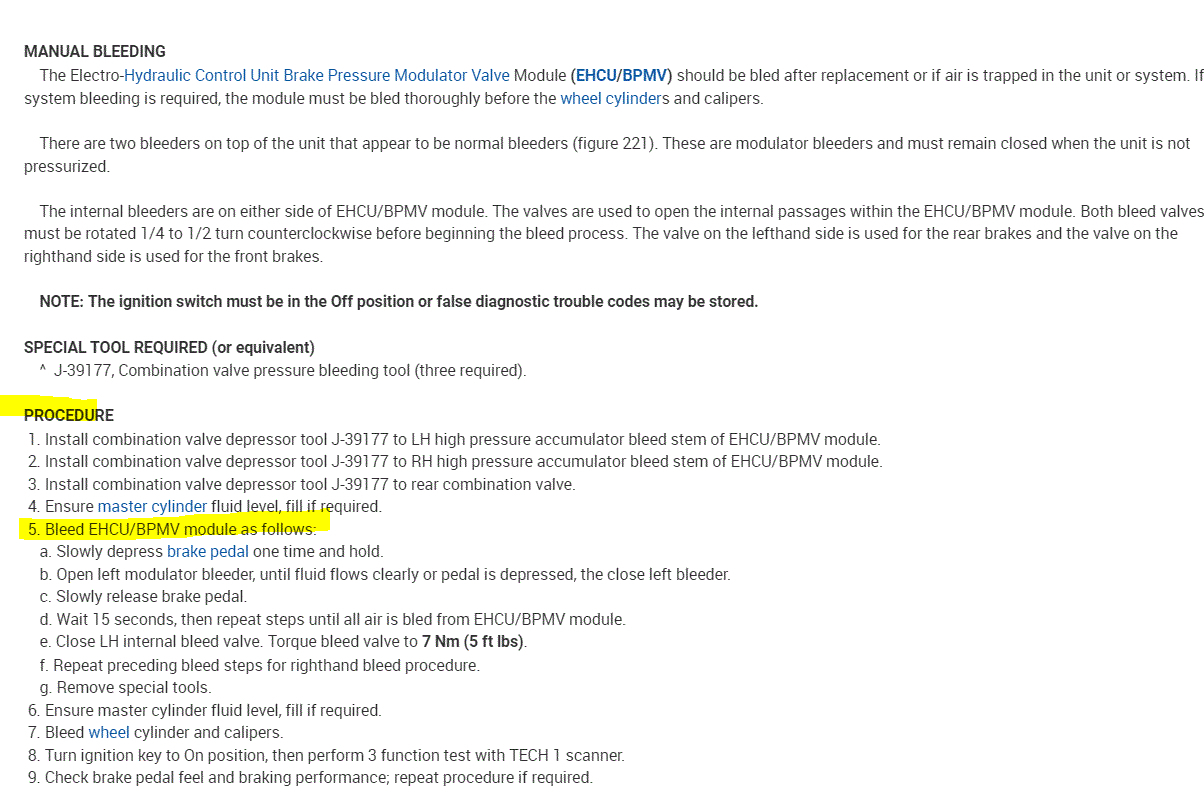

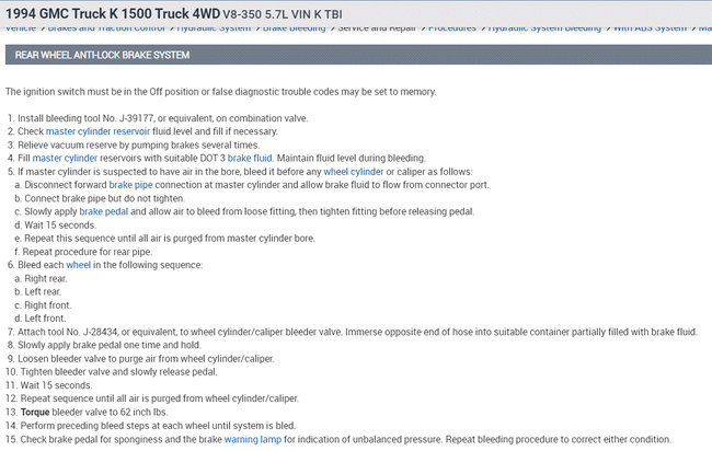

I need clarification. In your last sentence, you indicate. "... and $420.00 later I still can't, I mean can.." Are you referring to sliding on gravel?
Also, if there are no leaks, the parts are all new, and there is no air in the system, they should work. However, I need to know if the ABS module has been removed. If not, did it have 4-wheel ABS or only rear? If it has 4-wheel ABS, I attached the procedure below for bleeding the module. Also, the last pic explains the procedure for only rear ABS.
