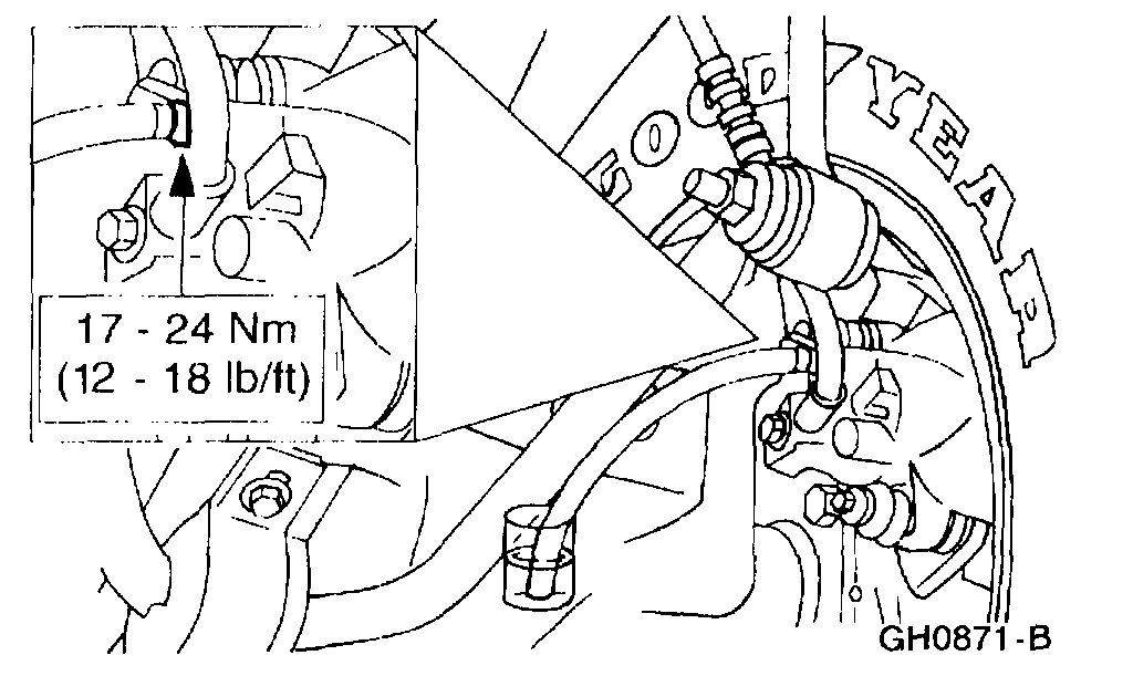

Had blown rear brake line. Replaced lines and block on calipers. Bled the brakes quite a few times and get a soft pedal when you start the truck. You will have a good pedal when the truck is off.

If you apply steady pressure to the brake pedal, does will it slowly go to the floor? Did the brake pedal go to the floor when the line broke?
If yes, my first suspect is the master cylinder is internally damaged. What sometimes happens is the plungers are moved beyond their normal travel when the brake pedal goes to the floor and are damaged by dirt and corrosion. The result is fluid bypass. Basically, you end up with a soft pedal or one that goes slowly to the floor. Check that for me and see if it happens.
If you find it does, take a look through this link:
https://www.2carpros.com/articles/brake-pedal-goes-to-the-floor
Also, here are the directions specific to your vehicle for bleeding the brakes. The attached pictures correlate with the directions.

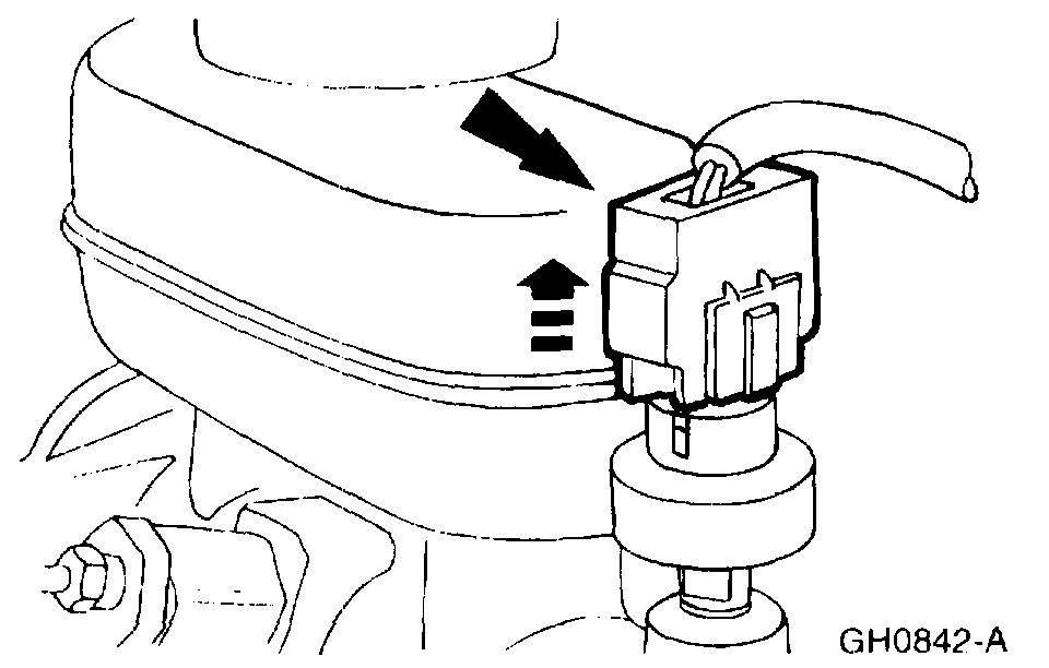

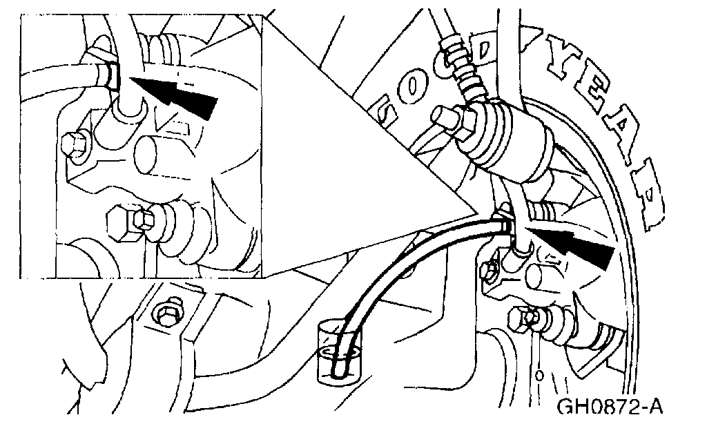

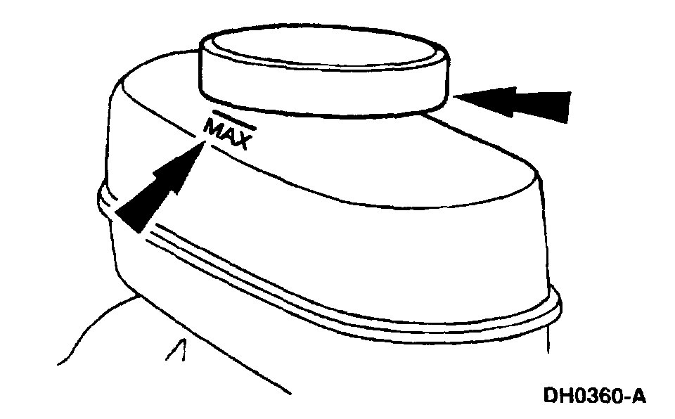

2. Clean all dirt from and remove the brake master cylinder filler cap and fill the brake master cylinder reservoir with the specified brake fluid.
pic 2

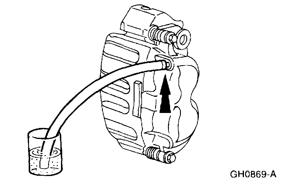

3. Place a box end wrench on the RH rear bleeder screw. Attach a rubber drain tube to the RH rear bleeder screw and submerge the free end of the tube in a container partially filled with clean brake fluid.
4. Have an assistant hold firm pressure on the brake pedal.
5. Loosen the RH rear bleeder screw until a stream of brake fluid comes out. While the assistant maintains pressure on the brake pedal, tighten the RH rear bleeder screw.
^ Repeat until clear, bubble-free fluid comes out.
^ Refill the brake master cylinder reservoir as necessary.
pic 3
6. Tighten the RH rear bleeder screw.
7. Repeat Steps 3, 4, 5 and 6 for the LH rear bleeder screw.
pic 4

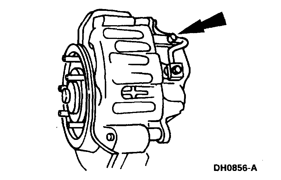

8. Place a box end wrench on the RH front disc brake caliper bleeder screw. Attach a rubber drain tube to the RH front disc brake caliper bleeder screw, and submerge the free end of the tube in a container partially filled with clean brake fluid.
9. Have an assistant hold firm pressure on the brake pedal.
10. Loosen the RH front disc brake caliper bleeder screw until a stream of brake fluid comes out. While the assistant maintains pressure on the brake pedal, tighten the RH front disc brake caliper bleeder screw.
pic 5

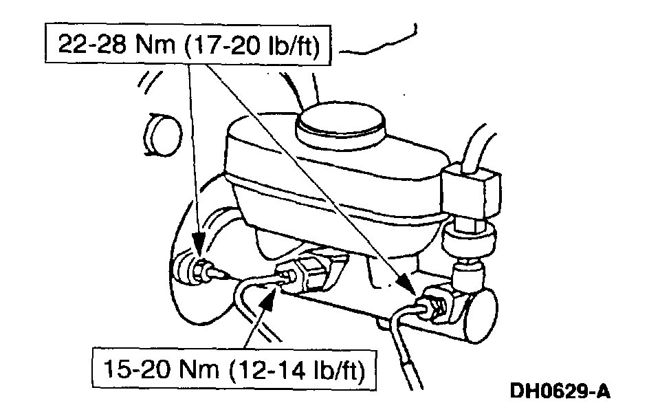

Removal
WARNING: Use of any other than approved DOT 3 brake fluid will cause permanent damage to brake components and will render the brakes inoperative.
WARNING: Brake fluid contains polyglycol ethers and polyglycols. Avoid contact with eyes. Wash hands thoroughly after handling. If brake fluid contacts eyes, flush eyes with running water for 15 minutes. Get medical attention if irritation persists. If taken internally, drink water and induce vomiting. Get medical attention immediately.
CAUTION: Brake fluid is harmful to painted or plastic surfaces. If brake fluid is spilled onto a painted or plastic surface, immediately wash it with water.
pic 6

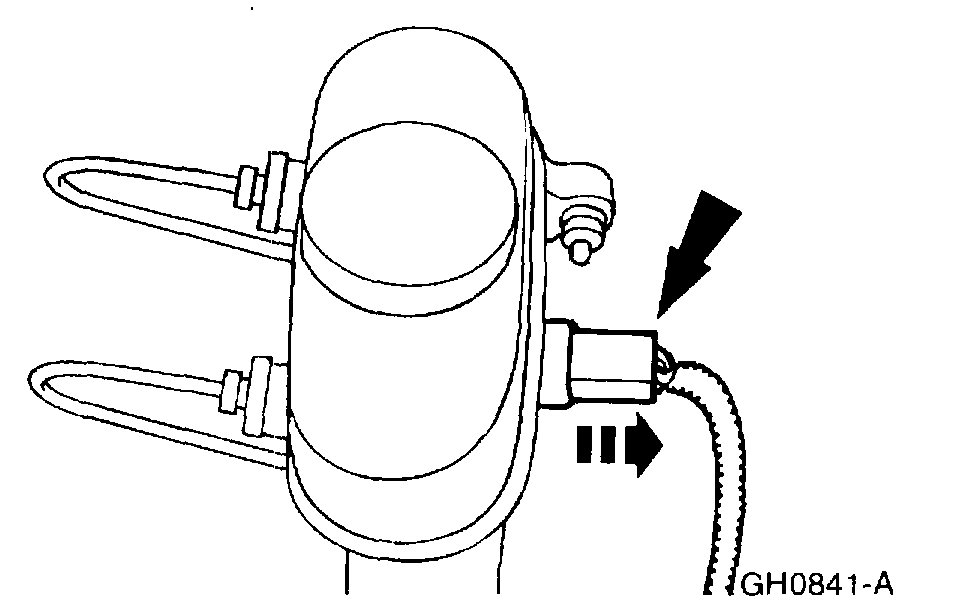

1. Disconnect the brake fluid level warning switch.

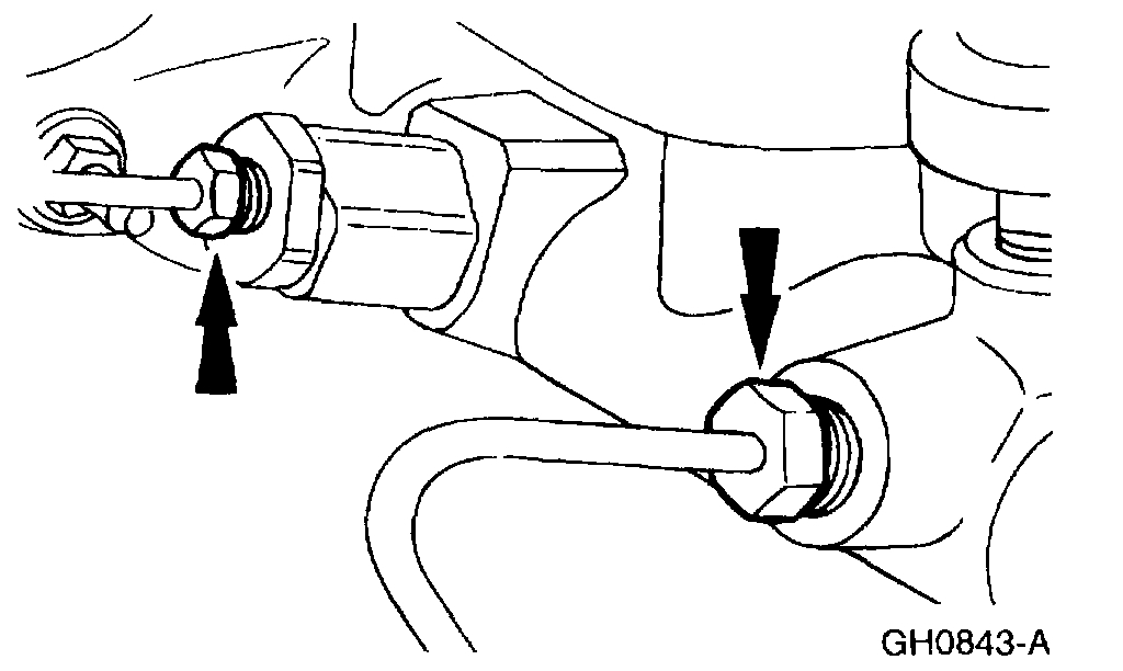

3. Disconnect the two brake lines and plug the lines and the brake master cylinder ports.

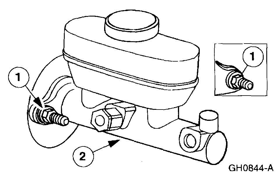

5. Remove the brake master cylinder.
1. Remove the two brake master cylinder nuts.
2. Remove the brake master cylinder.
