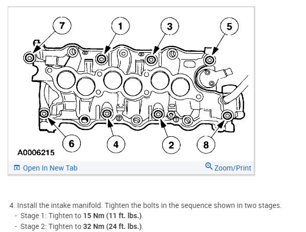

What socket size are the T bolts that mount the lower intake manifold down?
Jul 8, 2023 at 3:00 PM
  • 110,240 POSTS
That is a tough one because it isn't provided in a manual. From memory, T40 seems to ring a bell.
Also, when you torque this, follow the procedure listed in the pic below as sequence and torque.
Let me know if the T40 is correct.
See pic below.
