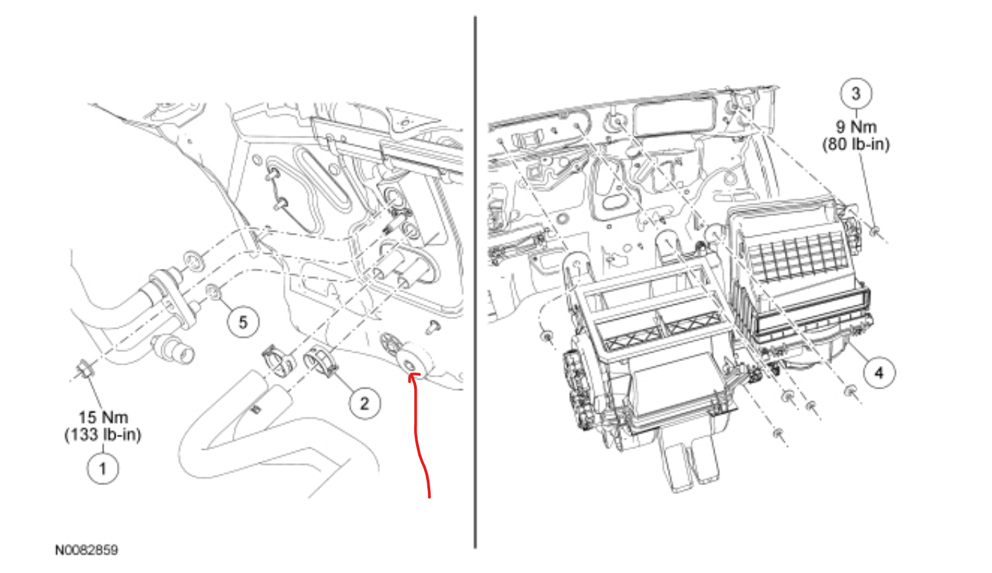

Can you tell if it is coolant or water? if it is coolant, you have a heater core that is leaking, if it is water then you are correct, and the AC evaporator drain is clogged here is a video to show you how to find it and how to clean it out.
https://youtu.be/q9_MZiS2_NE
Here is the location, check out the images below.

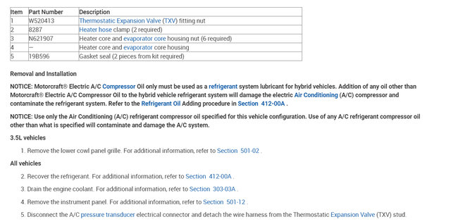

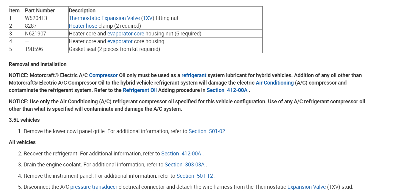

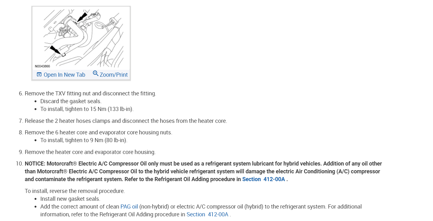

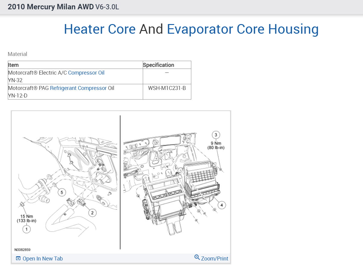

If you cannot unclog the drain, then the HVAC housing will need to be removed and disassembled to find the obstruction. Here is an outline of what needs to be done, the AC system must be evacuated. please check out this video:
https://youtu.be/4EqdrBVb0sY
Also, the cooling system drained, then the dash will need to be removed check the instructions below to finish the job. Check out the images (below). Please let us know what happens.
