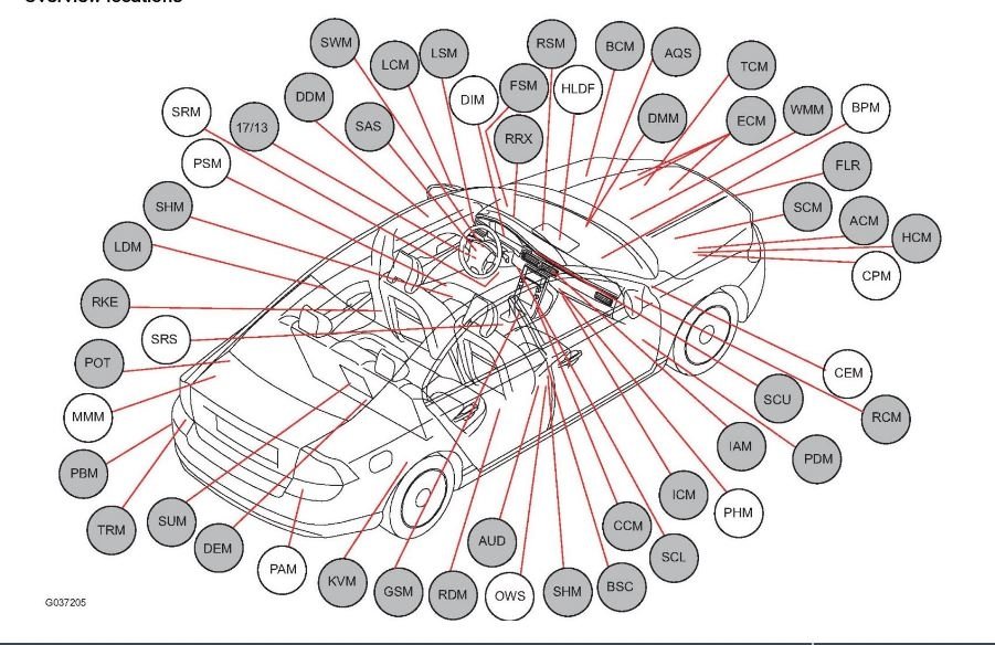

Modern cars are very complex. To give you an idea the attached image is of the modules on your car that can cause codes to appear. Not all of those codes can cause other tests to stop but many can. For instance say that you were to step on the brakes. That simple step activates control and monitor circuits in 10 different modules. Two of those modules do nothing but activate the left and right brake lights!
Most shops will tell you if a repair of a system may let tests run that could then trigger other codes, but it might be overlooked.
Newer cars are even worse with the amount of computers and modules in them with some European brands having over 100 modules in the system. The thing is that a scan tool depends a lot on the abilities of the person to diagnose the issue as none of the codes actually says this is the bad part, replace it. Instead the code indicates something the computer sees as wrong. To put it in different terms, Say you are out walking and step down and feel a very sharp pain in your foot. Your brain says "Pain in foot" but it doesn't say, the pain is from the nail you just stepped on, or the stone that got into the shoe, or the rock you just stubbed tour foot on. It just sees pain. Then you have to look for the cause. No different with codes.
A P0301 for example, it says you have a misfire on cylinder 1. It doesn't say that the code is from a bad spark plug, a bad coil or an internal engine problem. However that code will prevent an O2 sensor test from running. So you repair the faulty injector, then the O2 test runs and the excess fuel from the injector has damaged the upstream sensor, so that now sets a code. Then you repair that and now the full test runs and another code, a P0420 is set which means the converter was also damaged by the excess fuel. But due to the first code blocking the later tests you won't find that until all the tests have completed. And that is a simple code.
