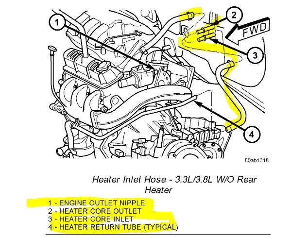

Then I suspect it is one of the heater core hoses. The best thing to do is pressurize the system when it's cold and then check to see if you can find the leak. You will need a cooling system pressure tester. Most parts stores will lend / rent one to you. I will provide directions for you to help do this test, locate a leak, and if you look at the attached picture, it shows all the heater core hoses which are located on the driver's side under the hood.

Just to help you understand. Engine coolant is circulated through the heater hoses to the heater core at all times. As the coolant flows through the heater core, heat is removed from the engine and is transferred to the heater core tubes and fins. Air directed through the heater core picks up the heat from the heater core fins. The blend-air door(s) allows control of the heater output air temperature by regulating the amount of air flowing through the heater core.
Based on that, if the heater core or one of the hoses is leaking, it is always leaking and not just when the heat is used. The blend air door is inside the vehicle and is nothing more than a plastic flap that either allows air to pass the heater core or not. That is why I am confused as to why you only see steam and smell coolant when using the heater.

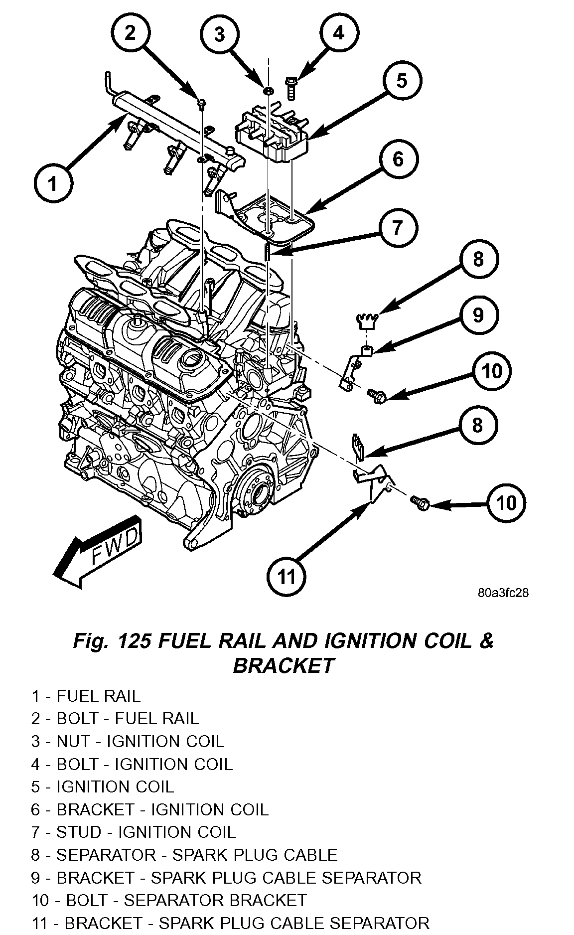

Fig.125
pic 1

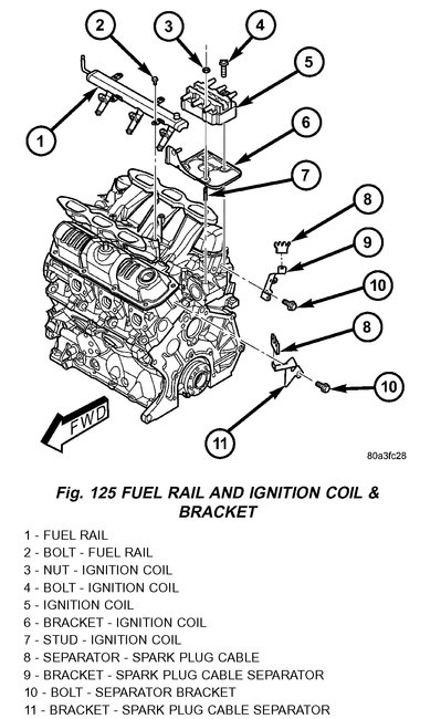

5. Remove ignition coil and bracket (Fig. 125).

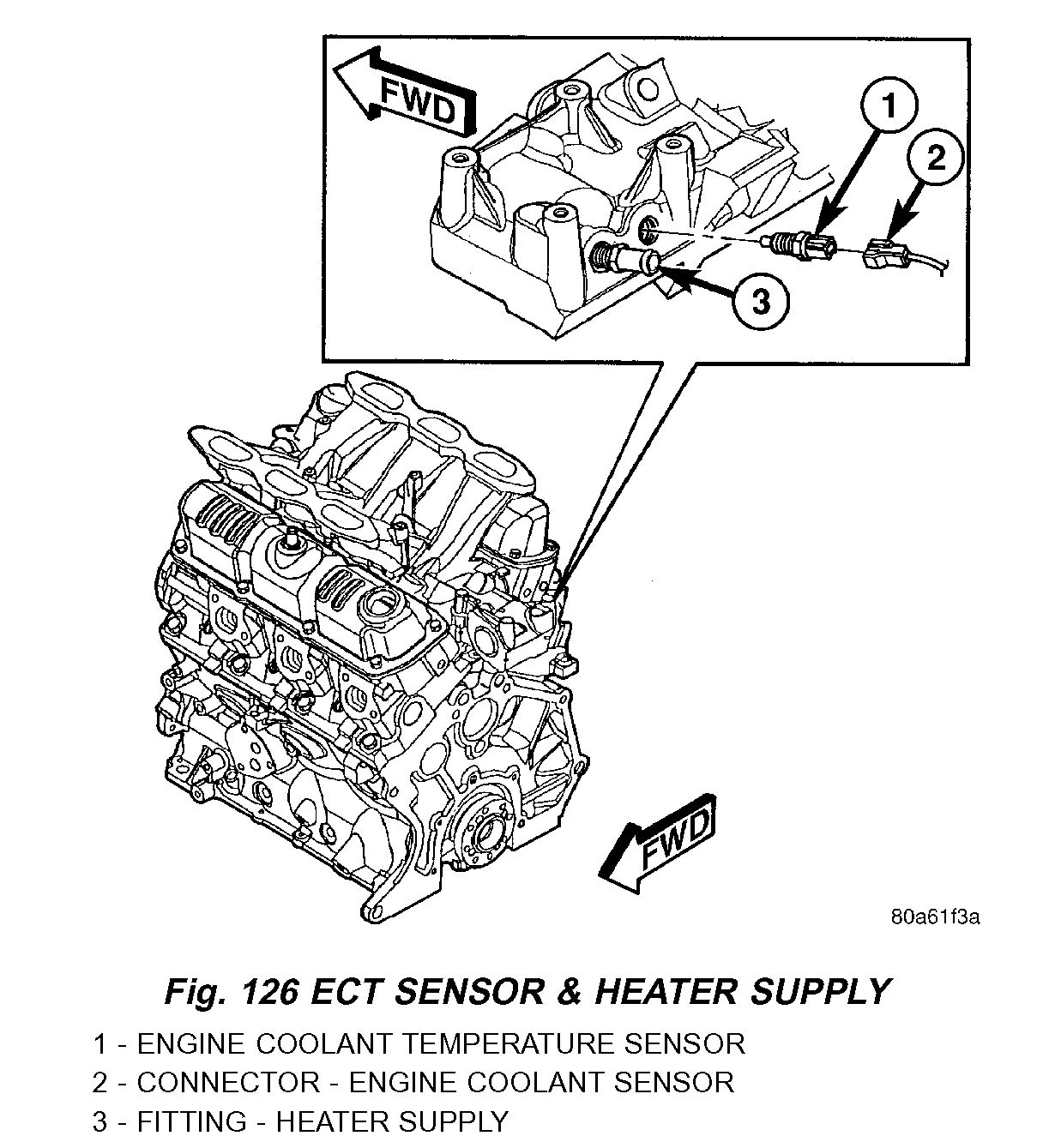

Fig.126
pic 2

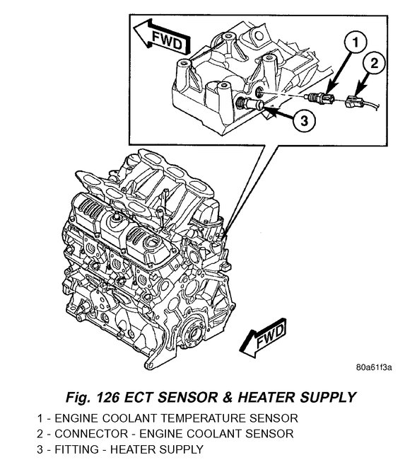

6. Disconnect heater supply hose and engine coolant temperature sensor (Fig. 126).
7. Disconnect the fuel injector wire harness.
8. Remove the fuel injectors and rail assembly (Fig. 125).

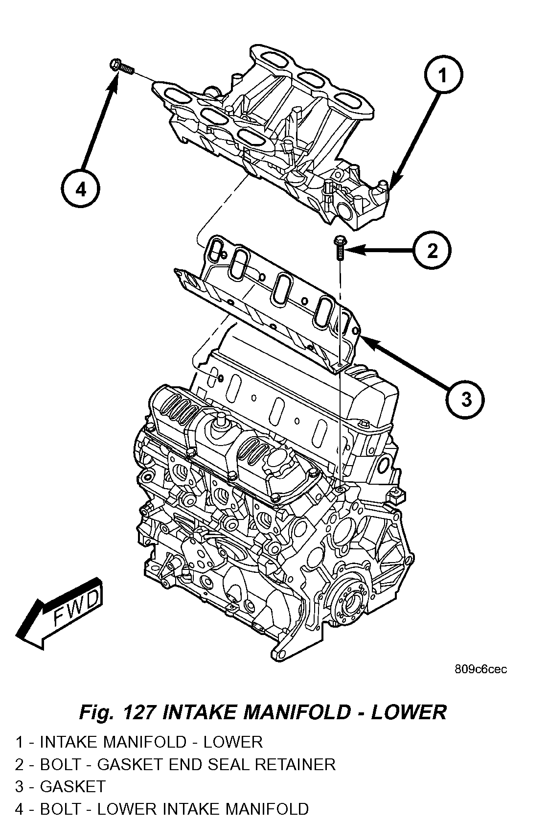

Fig.127
pic 3
11. Remove lower intake manifold (Fig. 127).
WARNING: INTAKE MANIFOLD GASKET IS MADE OF VERY THIN METAL AND MAY CAUSE PERSONAL INJURY, HANDLE WITH CARE.
12. Remove intake manifold seal retainers screws (Fig. 127). Remove intake manifold gasket.

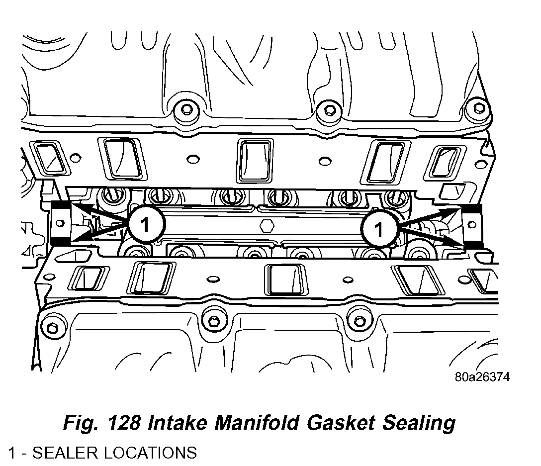

Fig.128
pic 4

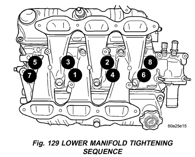

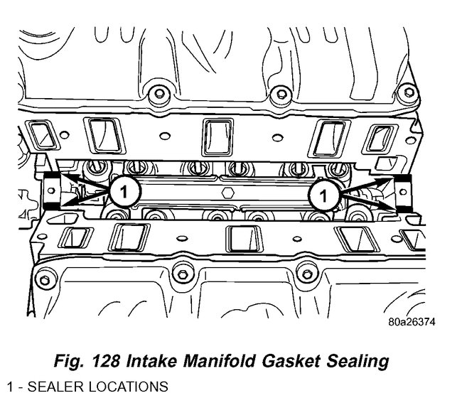

1. Place a bead (approximately 1/4 inch diameter) of Mopar Engine RTV GEN II onto each of the four manifold to cylinder head gasket corners (Fig. 128).
2. Carefully install the new intake manifold gasket (Fig. 127). Tighten end seal retainer screws to 12 Nm (105 in. Lbs.).
Fig.129
pic 5

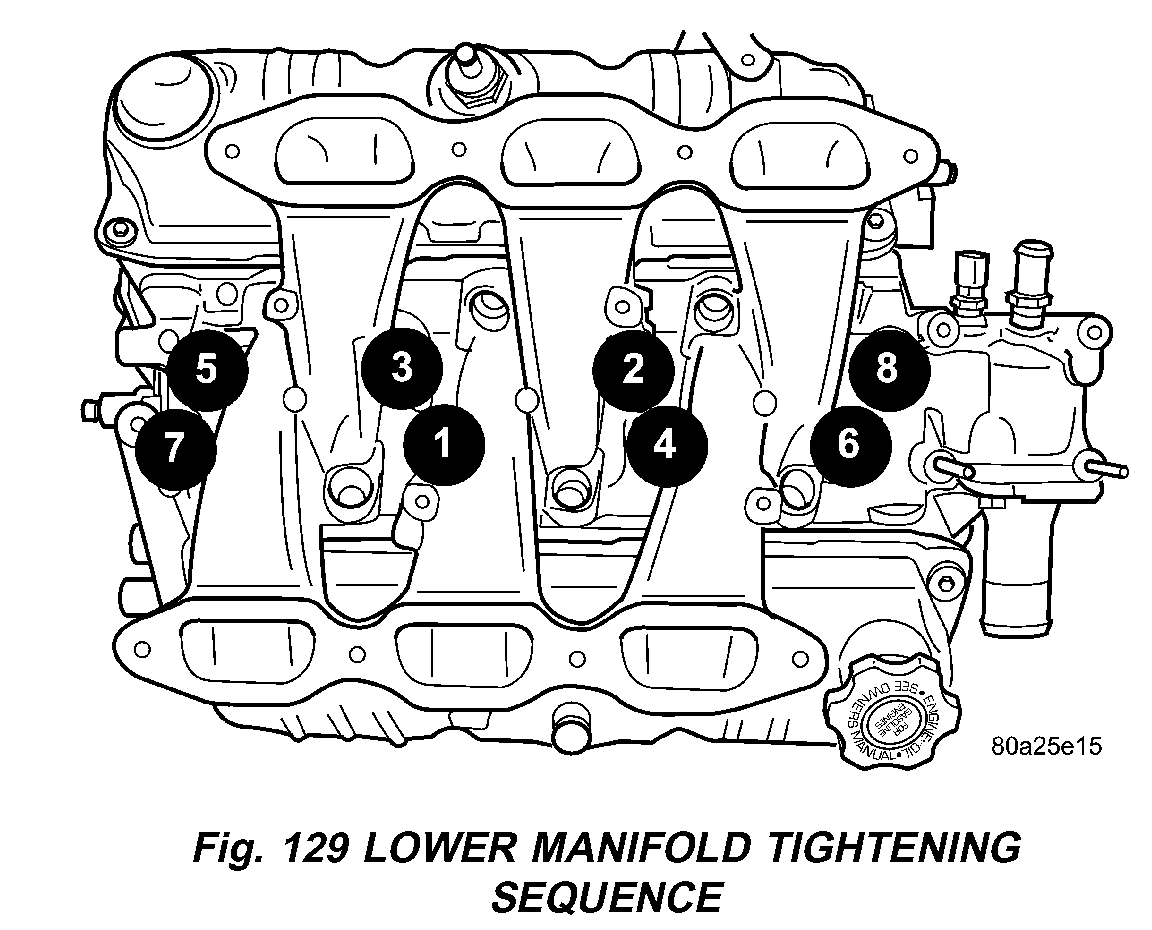

3. Install lower intake manifold (Fig. 127). Install the bolts and torque to 1 Nm (10 in. Lbs.). Then torque bolts to 22 Nm (200 in. Lbs.) In sequence shown in (Fig. 129). Then torque again to 22 Nm (200 in. Lbs.). After intake manifold is in place, inspect to make sure seals are in place.

6. Connect the engine coolant temperature sensor (Fig. 126).
7. Connect the heater supply (Fig. 126) and radiator upper hoses to manifold.
