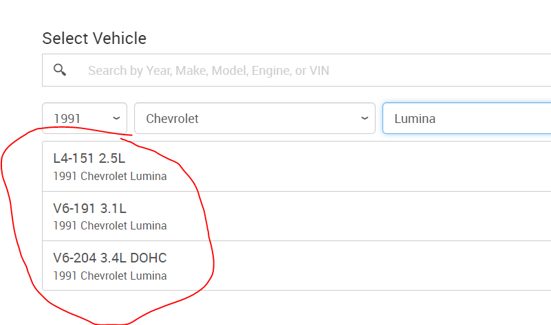

Let me know which engine is in the vehicle. There were two different V6 engines and a 4-cylinder used. I need to know which you have. (See pic below)

See pic below.
