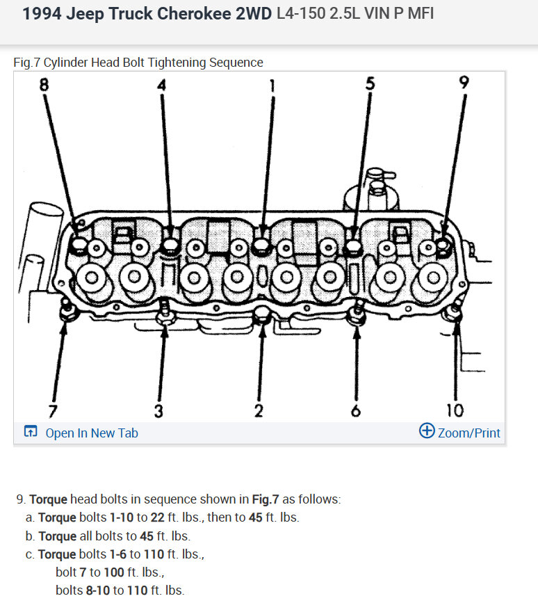

After confirmation you will need to remove the cylinder head and send it out for a crack test and resurfacing, here are the torque specs and sequence. Please upload a short video in your response of the problem, so I can see what's going on :) Check out the images (below). Let us know how it goes

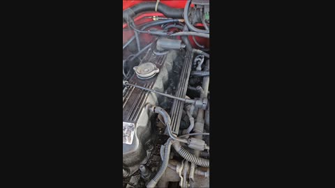

This is the best video I can get

How long was that after start-up? Take a sniff of the smoke, is it sickly sweet like burnt sugar or rancid smelling like burnt tar? First one is coolant second is oil. It may have gotten hot enough to fry the valve cover gasket and dump out some oil. I would wipe down the area and dust it with some flour or similar, then start it. Watch the flour. Does it turn dark like the oil or just get wet like coolant? If it's dark it could be oil, however that wouldn't make it run like you say it is. Stalling and stuttering would still point to gasket damage.

This was about 10 minutes after start up, and being driven just a few blocks. I'm being told this truck was stuttering BEFORE the radiator hose blew and overheated. Information i was just given, this is my my in laws vehicle. I will try that and report back!

Hmm, that looks like oil burning to me, was the engine hot? You could have a valve cover leak. Did you try the chemical test to see if you have blown head gasket?

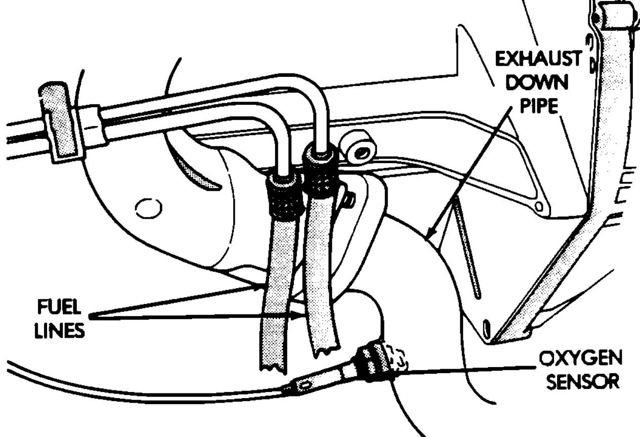

Yes, it was hot. The hesd gasket is not blown. I have retrieved the code from the cel and have code 21 for the oxygen sensor. Where is the sensor located? I am seeing conflicting information whether the 2.5 liter has one, or two sensors.

That engine has a single O2 sensor located in the exhaust pipe just below where it is attached to the exhaust manifold. They can be a bear to remove. Generally I like to run the engine, then let it cool down and as it cools, spray some penetrant on the area where the sensor screws into the pipe. Then once it's cold, remove the sensor.
