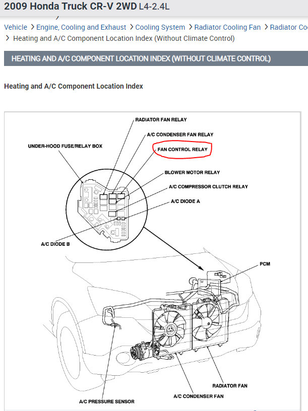

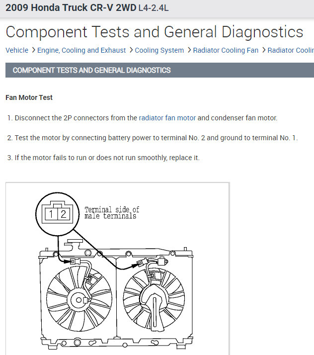

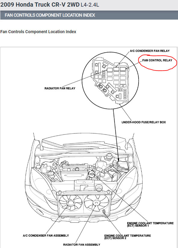

First you need to check and see if the fan come on while the engine in running. Just open the hood and observe it. Be careful not to touch the fan.
If it does not come on then it could be fan or the relay for the fan. It also can be the temperature sending unit (that triggers the fan).
I have attached diagram showing the relay location, also how to test the fan. That way you can verify it is defective before replacing it.
https://www.2carpros.com/articles/how-an-electric-cooling-fan-works
https://www.2carpros.com/articles/replace-electric-fan-motor
Let me know what you find out.
