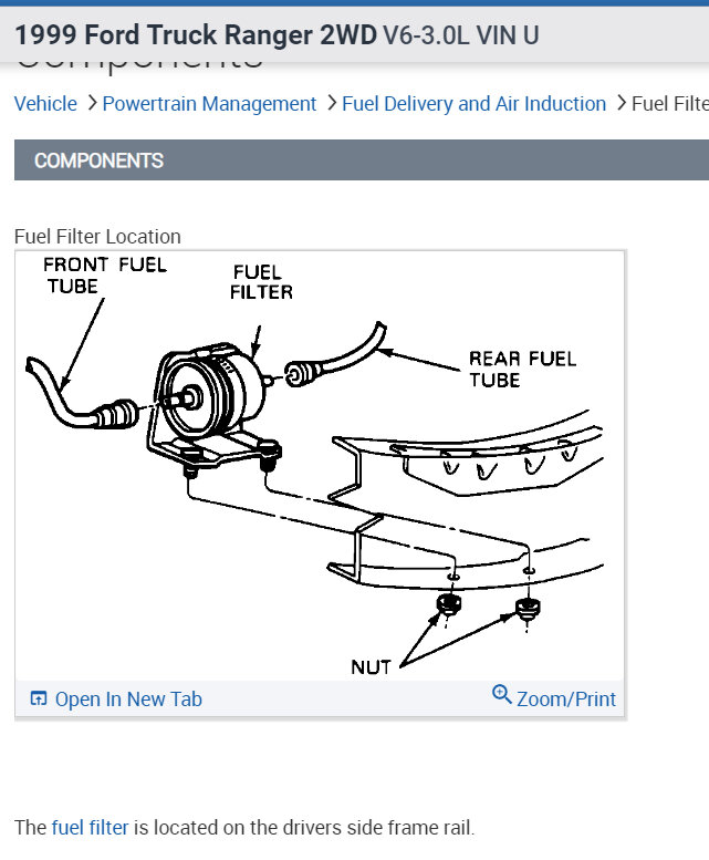

When I start my truck listed above xlt model, it has a rough idle and smokes for a few minutes. After it gets to operating temperature it smooths out and quits smoking but doesn't have much power on the road and when you're coming to a stop it starts jumping stalling and lunging and sometimes shuts off as you accelerate.
Aug 9, 2023 at 9:35 AM
  • 55,456 POSTS

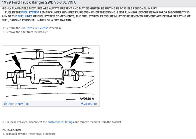

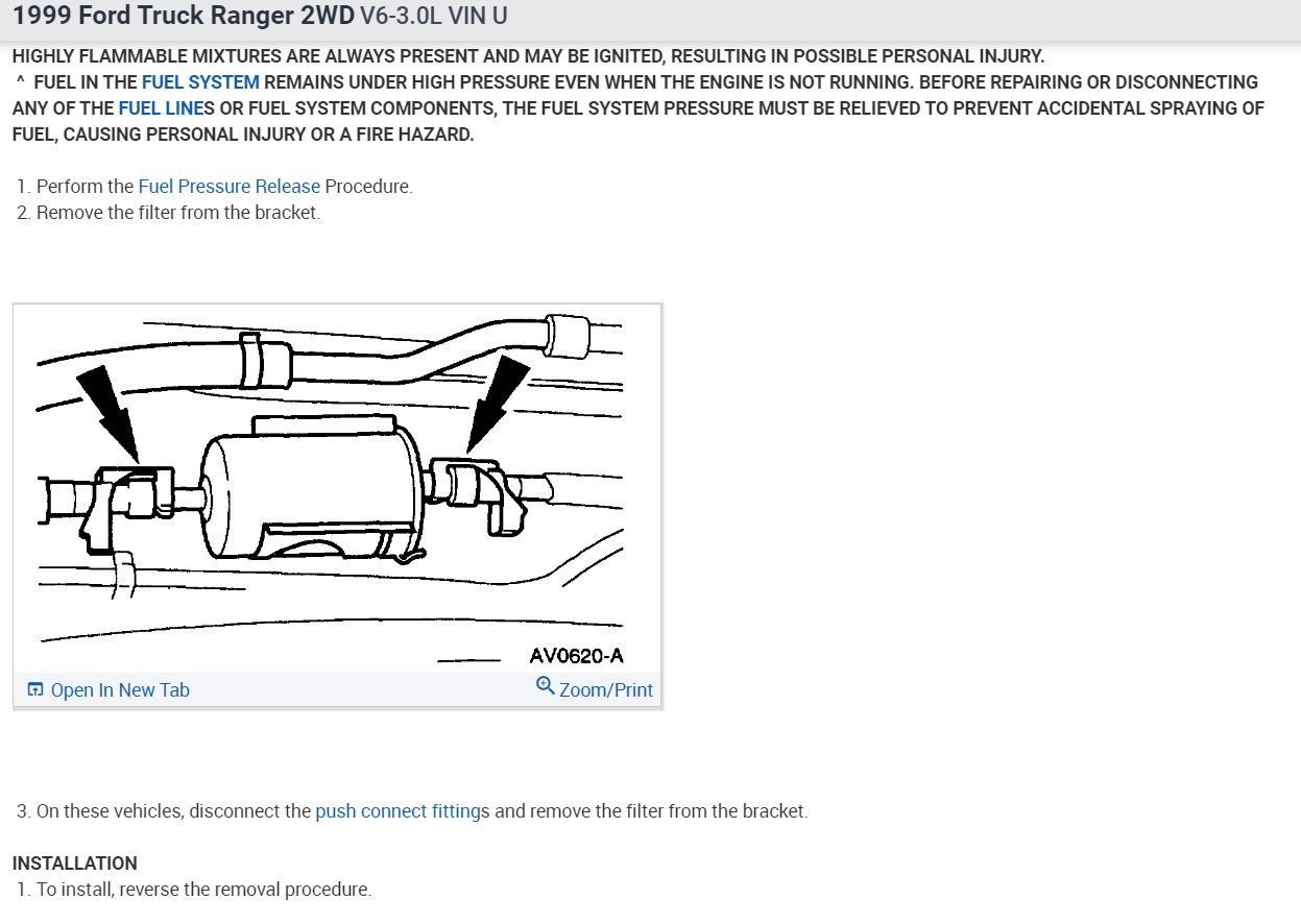

I would start by replacing the fuel filter, here is a generic guide to help you step by step with instructions in the diagrams below to show you how on your car:
https://www.2carpros.com/articles/how-to-change-a-fuel-filter
and this video can help as well:
https://youtu.be/Boi0DPXVHbM
Please go over this guide if the fuel filter is new:
