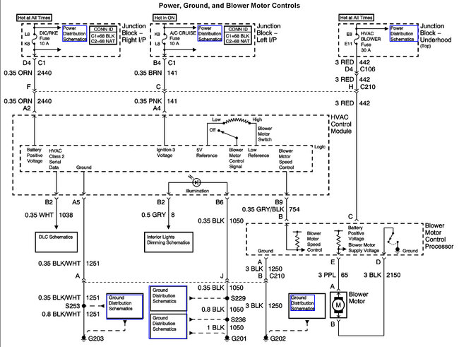

The smell of burning and smoke came out of the vents when I tried to turn on the A/C. The blower does not work.
Also, water is getting though the fire wall into the cabin. What is causing this?

The most likely issue is what is causing both problems. That would be either a clogged AC drain (it actually drains the entire HVAC case not just the AC). With it blocked the condensation from the AC as well as any rain or moisture (car wash, humidity or other) builds up inside the HVAC case until it reaches an opening it can escape from.
Or the seal under the trim below the window that keeps water out of the air inlet has failed and it is now flooding the HVAC unit.
Both are very, very common.
First thing to check is the drain. Open the hood and use a flashlight to look down the firewall and toward the outside of the chassis rail you will see an open rubber elbow. Squeeze it and or remove it and see if water comes out, or if it is plugged. Clean it and reinstall.

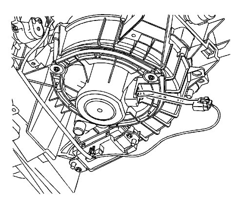

Now for the blower motor -
Testing and or changing the blower is not difficult, you remove the panel that is over the passengers foot well. The blower will be visible just above where the panel was. Disconnect the blower motor wire connector, then the two or three screws that hold the blower in the case. The blower motor and impeller will drop out. Reverse the process to install it. To test it you can run two jumper lines in from the battery. f you look at the connector on the motor you will see a black wire and a purple wire. The black wire connects to ground and you touch the positive battery lead to the connector that the purple wire was on. If the blower spins up fully and there is no noise or smell it is possibly okay and it was the controller burning out.
The blower speed control module mounts right next to the blower, with a heat sink that extends into the case. If the blower tests okay this may be the burnt item. Or both may have been burnt. It has one connector and two screws. There are two possible versions of this part, one fits manual control systems, the other fits the automatic version where you simply set a temperature and it tries to keep it at that temperature.
