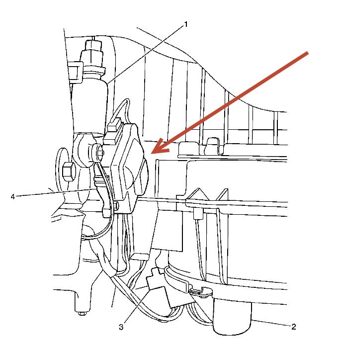

ISRAELH
I have a ac issue in my impala, passenger side blows cold driver side blows only hot air, heater works on both sides. Checked coolent, its good. Checked actuator, it works. What else could it be? I never had an ac problem in my car before, never filled up coolant because its always at least 90% full. The air is blowing out and everything.
Aug 26, 2019 at 11:31 AM (Merged)
HMAC300
  • CERTIFIED EXPERT
  • 48,601 POSTS
try pulling the hvac sfuse for 60 seconds with key on then reinstalling then wait another minute and try it this sometimes resets actuators in heater unit. it could be control unit as well but you need to scan for that. but check to see if actuator is getting power this is right side similar on left.
