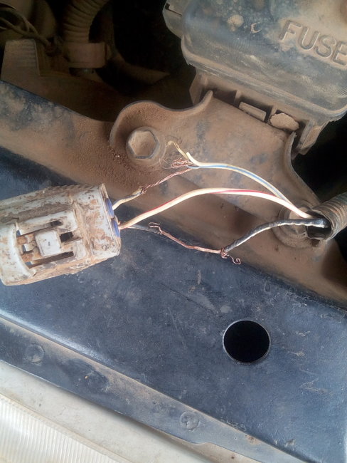

Hi, I worked on the vehicle, I confirmed the fault by putting on the A/C while the vehicle is running after few minutes, I saw smoke from under the dashboard and power distribution center (fuse box) at the engine compartment. I traced the wires, three different wires were stick together under the dashboard, I separated them. Checking the fuse box at engine compartment, I realized that the wires that powers compressor were completely burnt and some wires that comes from that big heater relay. I traced to know the cause before I saw that the A/C magnetic clutch wire at the compressor and one of the wires for the lock sensor were combine together.
Could that have been the cause of the burnt wire?
The wires are shown below.
Feb 20, 2021 at 4:47 AM

Yes, the two wires in the first pic could have caused the issue, but the fuse should have blown before melting the wires. Check to make sure the fuse hasn't been replaced with one of a higher amperage.
Now for the light, does the compressor engage at first and then stop? The clutch itself may be bad. When the light starts flashing and the compressor stops, you need to check if there is power to the compressor clutch.

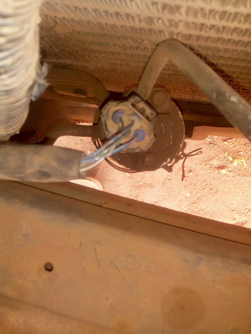

I also realized that the wires of the compressor lock sensor has detached from the sensor at the compressor.
Feb 21, 2021 at 6:16 AM
  • 110,251 POSTS
Yes, it sounds like you are checking it properly. Have you tried repairing the wiring at the sensor? Did it make a change? Also, it sounds like you still have a bad connection causing power loss. Check back at the AC fuse and make sure it isn't getting hot.

If you check the diagram, three wires are going to the compressor, one to power the compressor clutch and the other two wires for the lock sensor. Check the diagram.
Feb 21, 2021 at 12:22 PM
BLESSING EWOBOR
  • 753 POSTS
Those two wires that you traced at the compressor, that are white/blue and white/red are the wires that I am talking about.
Feb 21, 2021 at 12:27 PM
  • 110,251 POSTS
Those wires go to the AC amplifier. I indicated where they go below. As far as the fuse, I said it should have blown. I don't know why it didn't.

As I said earlier that two wires were not connected that goes to the compressor, I removed the alternator so that I can access the compressor properly but guess what! There I saw the real cause of the burnt wire, the black/white wire that supposed to power the compressor was naked somewhere close to the compressor and it do short the circuit to ground. After rectifying these everything works normal.
Thank you very much. I have disturbed you alot. You are a darling.
