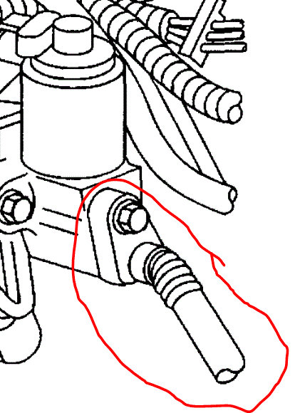

I smell an electrical smoke smell when my alero has been running for a bit. it seems to be coming from the exhaust gas recirculation valve. Could it be shorting out and is it hard to change out?
Feb 25, 2021 at 3:40 AM
  • 110,244 POSTS
The EGR does have an electrical connector, so it's possible. However, I would think you would see at least a small amount of smoke.
If you look at pic 1 below, I circled a part on the EGR that gets extremely hot. Make sure nothing is touching it.

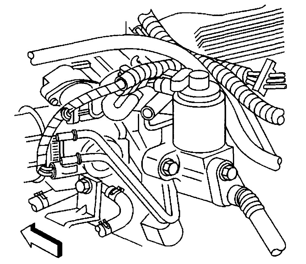

IF you decide to replace it, here are the directions. It really isn't too hard of a job. The remaining pics correlate with the directions.
_________________________________
2003 Oldsmobile Alero V6-3.4L VIN E
Exhaust Gas Recirculation (EGR) Valve
Vehicle Powertrain Management Emission Control Systems Exhaust Gas Recirculation EGR Valve Service and Repair Removal and Replacement Exhaust Gas Recirculation (EGR) Valve
EXHAUST GAS RECIRCULATION (EGR) VALVE
REMOVAL PROCEDURE
1. Turn OFF the ignition.
pic 2
2. Disconnect the exhaust gas recirculation (EGR) valve electrical connector.
3. Remove the bolt retaining the pipe assembly from the EGR valve and carefully pull the pipe assembly back.
4. Remove the EGR valve retaining bolts.
5. Remove EGR valve assembly.
6. Remove the gasket.
7. Clean the EGR valve mounting surface.

Saw a little smoke coming from hood but when I shut car off it wasn't there. Thanks
Feb 25, 2021 at 2:13 PM
  • 110,244 POSTS
Is it possible to open the hood to see if you can tell where it's coming from?
