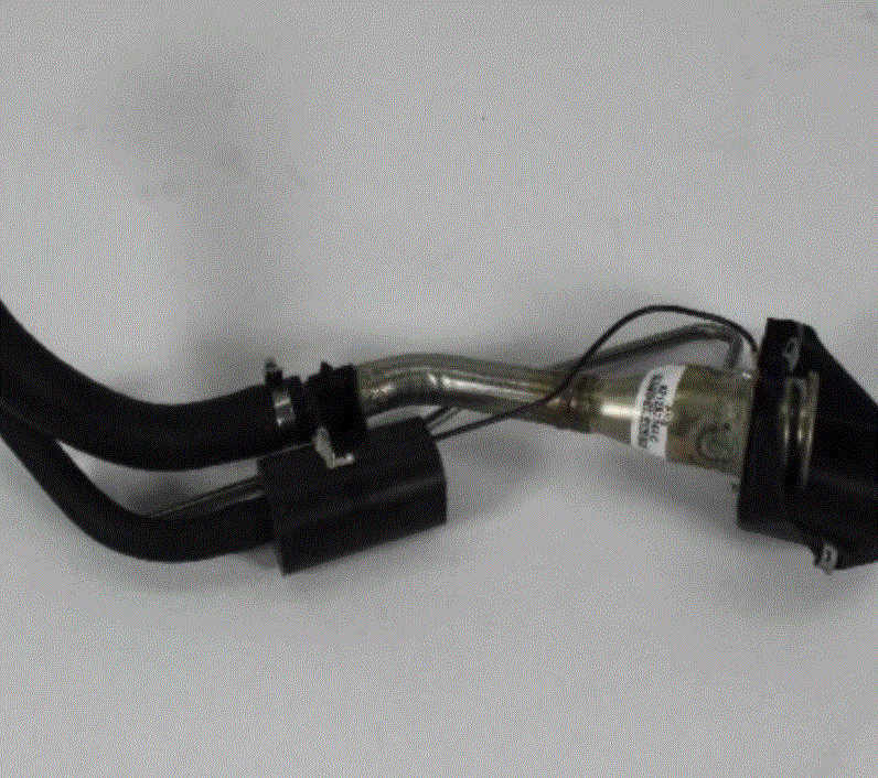

When you say filler cap, are you referring to the fuel tank filler tube? If so, inspect for small rust holes or any evidence of corrosion that could have eaten through the steel.
Also, there will be a rubber hose between the filler tube and tank, check that for leaks as well.

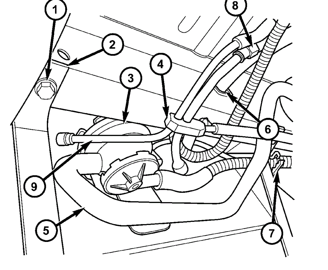

Keep in mind, there are several Evap components around the fuel tank. If possible, check from the underside of the vehicle to tell approximately where it is coming from.
I attached a pic below showing the leak detection pump toward the front of the tank and many hoses related. Any of these can be leaking.
See pics below Pic 2 shows what the filler tube looks like, so check anywhere it could rust and everything from the tank to the filler opening.

It is the picture with the cap and hose to rank. It is attached just below the cap.
Apr 17, 2022 at 8:03 PM
JIMHERRMANN
  • 16 POSTS
It is the picture of the filler neck with cap. Black object attached to the hose/pipe that allows you to put gas in the tank.
Apr 17, 2022 at 8:27 PM
  • 110,194 POSTS
Okay, that is steel. It may have rusted and developed a few pinholes. Are you able to remove it and inspect for damage?

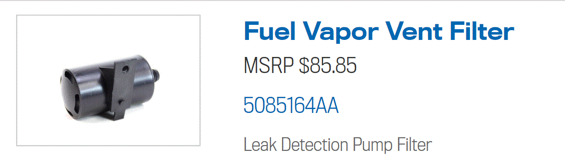

No rust or holes. Smoke coming from somewhere in fender well. What is the black canister looking thing that is about two inches in diameter? I think the smoke is coming from it.
Apr 17, 2022 at 9:10 PM
  • 110,194 POSTS
Does this appear to be the part you are referring to? If so, that is the vent filter. The OEM part number is listed in the pic.
See pic below.

To order it, it shows the complete fuel filler neck with this part as part of the assembly.
Apr 18, 2022 at 6:10 AM
JIMHERRMANN
  • 16 POSTS
Do you think smoke should be coming out of it?
Apr 18, 2022 at 6:17 AM
  • 110,194 POSTS
I did notice that as well. No, there shouldn't be smoke coming from it. It's a bit frustrating that you need to replace other things that are good, but I tried as well to find just the needed part, and it doesn't seem available by itself.
