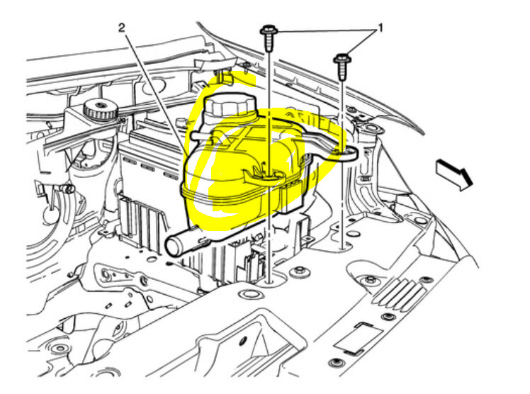

The code you have is related to an evaporative emissions issue, so I don't feel it caused this to happen.
Based on your description, it sounds like it overheated, and you are seeing coolant everywhere. Coolant will create a white/grayish smoke when it evaporates of hot components. Also, if there was a leak, the hissing may have been coming from the leaking area.
First, check the coolant level. The reservoir is under the hood. See pic 1 below. If it is low or empty, we need to identify where the leak is located. Let me know what you find, and I will further direct you.
Note: If you add coolant, make sure to use the correct type which should be indicated on the cap. Also, you can shift from park by turning the key to the run position (engine off) and depressing the brake pedal.
Take care and let me know what you find.
See pic below.
