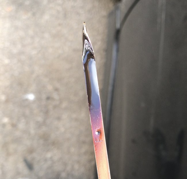

I started up my car this morning, (everything was working great prior to that) and some smoke came out of my tail pipe. I turned off the engine and let it cool, checked my engine oil and it’s halfway. What do I do? And what might be the problem?

Yes first add oil.
As for the smoke, did it clear out after a little bit? or you shut it off as soon as you saw the smoke?
What is the color of your oil?
Did you have any other issues before this?

I shut it off after seeing the smoke, was afraid i might damage anything further by keeping the engine running.
That’s the color of the oil and where it’s at. No previous problem whatsover before that.

It just appears to have just little dirty oil and just a little low.
Typically is you will get white smoke if there is a leaking gasket like the intake manifold gasket or head gasket.
Check for any type of leak in the engine bay or on the ground. Check around the intake manifold where it connects to the cylinder head.
If you are not comfortable then it will be best to take it to a repair shop for evaluation.
Let me know your thoughts.
